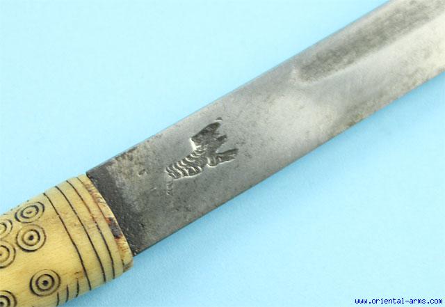

I see Artzi has just flogged a similar blade with tiger mark & I would guess replacement hilt?

Spiral, that one is too weird.

Wow, Spiral, that is interesting.....the circles do remind me of some African designs...I cannot remember if I have seen this in a Yunnan sword handle with the horn scales...I think I may have...I have to look...but more usually I think of the circles with the Bo'an knife handles though...I've never seen one though in an antler shape. I agree with Ian...odd looking...ceremonial piece????

Indeed Chaps, & Well not my field but looks a replacement hilt to me...
Ive seen the dot & concentric circle on some Afghan or Afghan border pieces as well I seem to recall.
