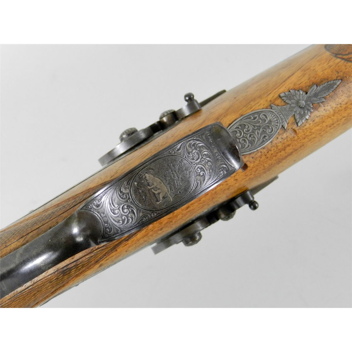

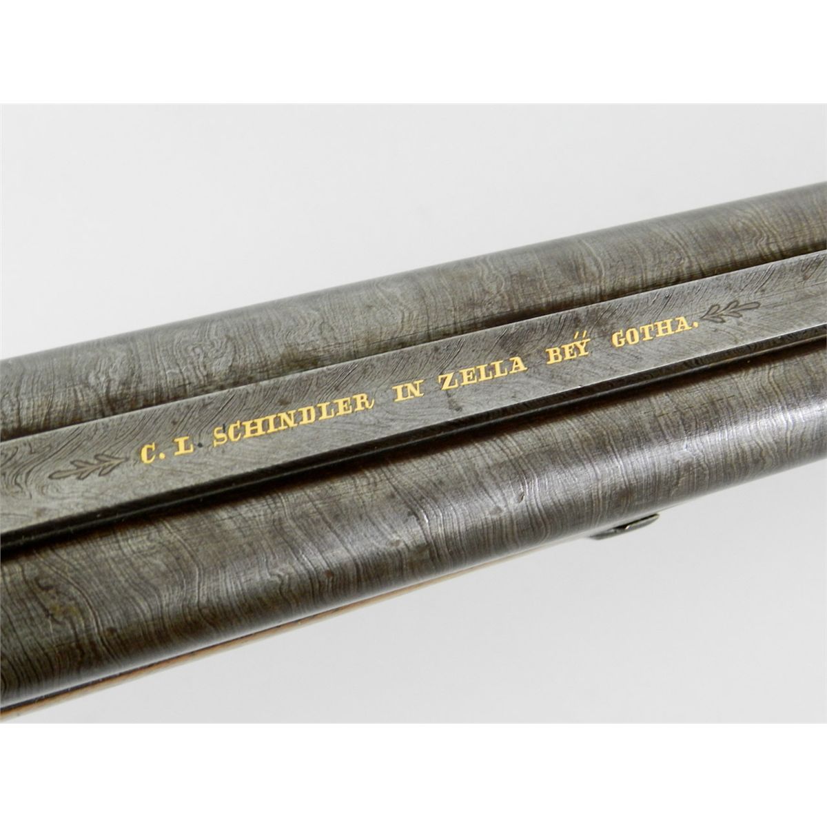

I have more than a passing interest in German sporting firearms of the 19thC, I hope these images will be of interest. A percussion sporting gun mid 19thC.

Hi and Hallo, Dirk,
Hi Norman,
On reading your posts, and after a glance at Norman's images, I can tell for sure that the overall appearance of the double-barreled side-by-side percussion shotgun doubtlessly allows for assigning a date of ca. 1840-50 to it, with all of its parts, including the Neo-Gothic style of the signature, definitely being contemporary, and preserved in fine condition. Only the original shellac varnish seems to have been removed from the walnut stock.
Anyways, I am glad to find my information concerning '... records of a certain gunsmith C. Schindler in Zella St. Blasii in ca. 1840' proven right.
It is true that this item is far out of the field of expertise I usually plow, but so is the originally supposed late-18th century period of manufacture.
