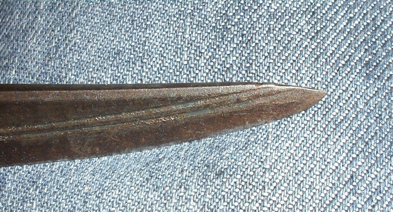

Posts: 4,285
can you do a closeup of the tip - is it notched like other examples? shame about all the solder & missing transverse wires. can (or should) it be re-wired?

Posts: 2,928
Hi Kronck.
There aren't any missing wires. The handle is wrapped with brass and steel wire. Some of the steel wire is twisted, some platted. No gaps though.
The tip has the standard notch.
You can see in the picture that it needs a clean!

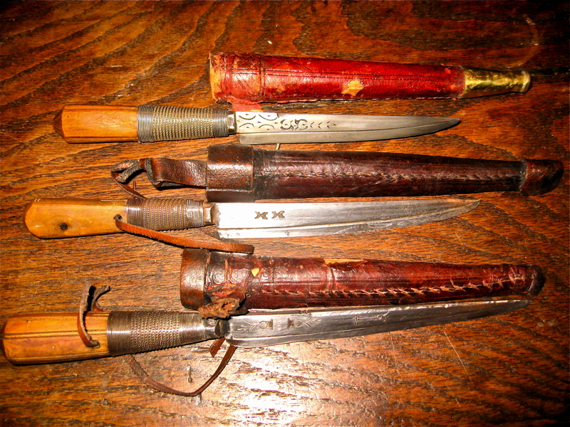

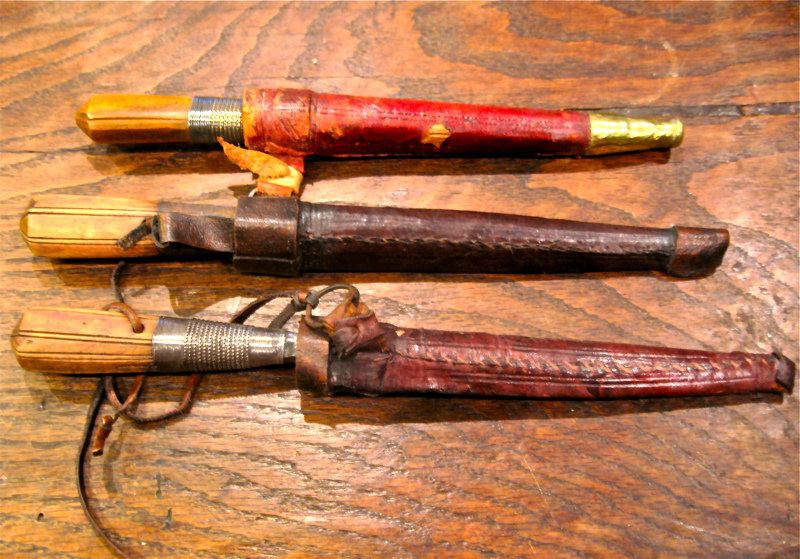

Posts: 4,285
the transverse wires: (another forumite's khodmi)
running from the pommel end towards the bolster, in the grooves empty in yours and most others.
aha, found pics of mine:
