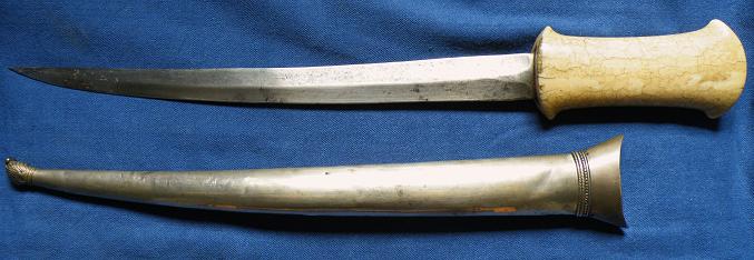

Yes, you are quite right about the blade. Max. thickness at the spine must be 3-3.5mm. In fact the blade is very similar to that on an Ottoman dagger I had some time ago (see attached image). I wonder could it be a re-used Ottoman blade, perhaps broken at the tang area ? which would explain the applied brass/bronze handle...
