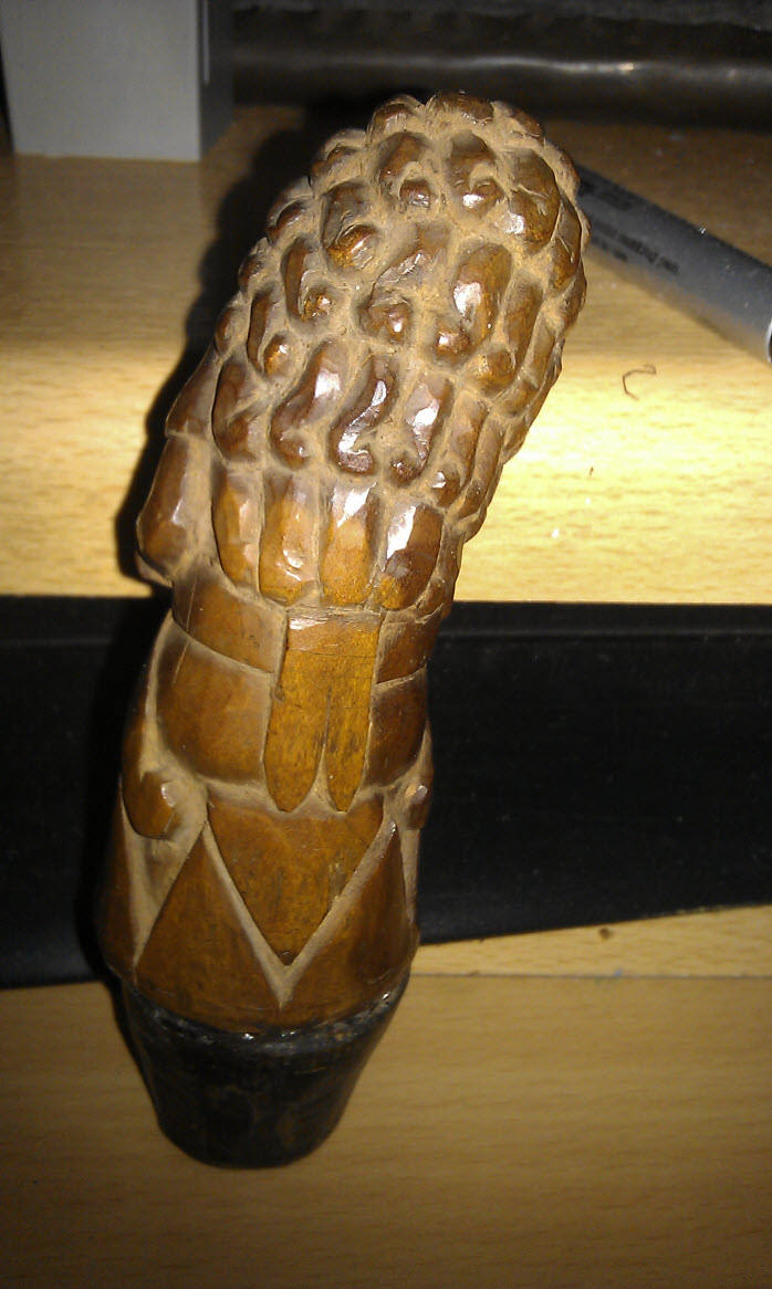

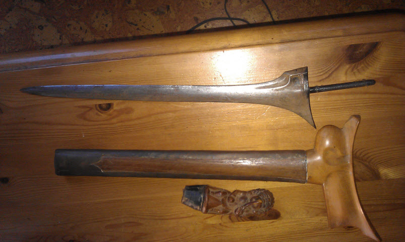

Hello everyone,
I am new on this forum, but it feels like I been here for months, there is so much to read and to learn.
But I have a question, and I hope you can help me with it.
I recently bought a keris, with a Sumatra sheat, de keris fits like a glove, en there are no sins of recent adjustment to it, there was a Bali hilt on it, I think Ganesha,
de keris itself looks like it’s been polish, just what I have seen on Bali wliah’s , the peksi is about 8 mm thick and 8 cm long, so no small hilt on this one, the wilah without the peksi is 38 cm.
The pendok looks like it’s home made, and not a very good job.
The only thing I now about it is that came to Nederland between the two WW, the person that brought it here was a teacher in Indonesia.
So the question is, is this a Bali wilah or Sumatra or ......?
I hope you guys can help me out, and sorry for my bad writing.
kind regards, Ben

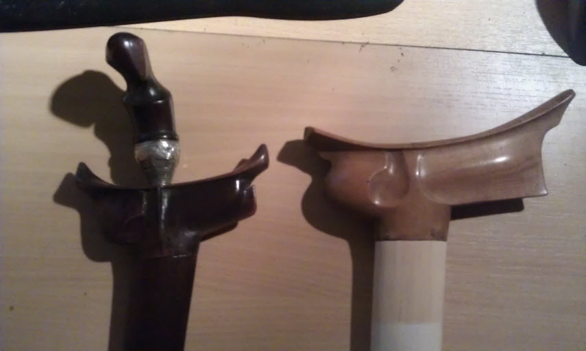

When I look again to your sheath I understand why you have thought that it is a sheath from Sumatra/Palembang. The sheath look like the carver hasn't known how to look a sesrengentan sheath from Bali and have created a mixture from this both sheaths.
For better understanding I have attached pictures from your sheath beside from both sheath forms. The sesrengentan pictures are taken from the book "Keris Bali Bersejarah".

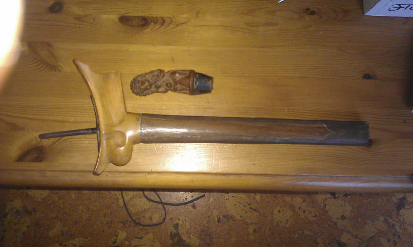

Old 2nd December 2011, 08:03 PM   #7
Harley
Harley's Avatar
Join Date: Sep 2011
Location: Nederland
Posts: 83

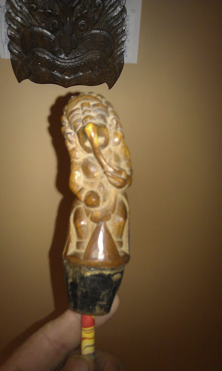

Hello Detlef & David,
David, the pendok is really someone's homework, so I think it was made this way because there is no grade of difficultly to make it, but thats my opinion.
I have enclosed 2 pictures of the hilt, it is kind of strange that the bottom part totally is different than what i have seen.
It was not only the polished wilah, but also the extreme peksi, i really don't no what other kind of hilt would fit.
Detlef, you hit the nail on the head, i have that same example here, en even now i know that it's Bali, i can't help that i still think that he looks more like the Palembang, maybe a Monday morning product
Thanks for the answers.
regards,
Ben
Harley is offline   Reply With Quote

Now it's rather getting puzzled , I agree that the hilt is from a very poor quality, but are there more area's where they use this kind of hilt?
I am working on it David, from what i have seen the blade is very quick responding on the warangan, I only was cleaning the blade but in the juice
there was probably some old warangan, so i could see the blackness on the blade with very clear pamor, but i cleaned it off because i need the blade to make the new gandar.

Old 2nd December 2011, 09:11 PM   #10
Posts: 7,229
When I look at this keris what I believe I see is a plain but good Balinese blade in very sub-standard dress.
There is no doubt in my mind that the blade is Balinese:- the pesi is typically Balinese, and as Harley has noted, what type of hilt other than Balinese will fit it; the pamor is typical coarse Bali pamor, the unetched blade finish typical Balinese, the neat, positive garap typically Balinese. What else could it be but Balinese?
But the dress is a fish of a different feather.
Plain ugly.
As Detlef has commented, it looks as if the carver set out to make a scabbard form of which he only had a very sketchy idea.
The hilt is poorly carved, again it looks as if the maker was running on depleted memory banks.
If it was collected in Bali in the period 1920 to 1940, we are looking at the period when tourism was just beginning in Bali. The puputans had all but extinguished the previous social structure, the Dutch then tried to turn Bali into a living museum, tourism had not developed to anywhere near what we see today, the Balinese craftsmen and artists were coming under the influence of European artists, as well as being influenced by what European tourists wanted. Much of the refinement that we expect to see in Balinese art and craft at the present time is very probably due in great measure to the millions of foreign visitors that Bali admits each year. If we look closely at pre-European influenced Balinese style and art, it is very much closer to the tribal art of various areas in S.E. Asia.
Yes, millions of visitors. Over 2,500,000 arrivals in 2010. That's a big market, and the artisans of Bali do their best to satisfy it.
If we go back to the period between 1920 and 1940 it was a totally different picture. Even in 1966 there were hardly any foreigners in South Bali, and entry and exit was not nearly as easy as it is today.
To a large degree the foreign visitors to Bali have created the art of Bali, or more correctly, European perspectives have been responsible for the development of existing art norms to the point where common people can afford the level of refinement that was once only available to kings and princes.
We could hypothesise about the origins of this scabbard and hilt all day, but my personal opinion is that it was made in Bali, by a carver of no particular talent, however, from what I can see of the pendok, this does not look like Balinese workmanship, nor design. I think the pendok is a later addition.

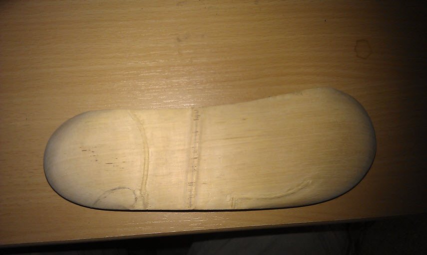

I have some plain Indonesian wood that i use for making the sheath, but for the pelet i really must do some practice, i tried one time before, without looking for an example, with as result a ugly kendit
I just realized that i only have a Balinese patrem keris, can someone tell me
what the measurement of the width for a gayaman is?, the rest i can work out.
regards,
Ben

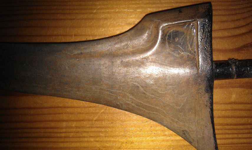

Old 3rd December 2011, 01:53 AM   #16
Posts: 7,229
I would not call that kendit ugly, its well within the parameters of a natural kendit.
Bali gayams vary a bit in size, they're not as disciplined as Solo and Jogja gayams.
I've just picked up the closest one and its measurements are 185mm long, depth at center point is 57mm, thickness at widest point on top is 26mm, the entire wrongko is 584mm from top of the atasan to the tip of the gandar. Proportion wise it looks a bit too long in the gandar for the size of the atasan.
Old 3rd December 2011, 09:32 AM   #17
Jean
Join Date: Jun 2009
Posts: 1,740
Hello Ben,
Is the peksi of the blade original and intact? From your 3rd picture it seems as if it was possibly cut and rewelded about 1 cm from the base but it may be just an impression.
Best regards
Jean
Old 3rd December 2011, 11:06 AM   #18
Posts: 7,297
Jean, i think you might just be seeing remnants of the cloth wrapping.
Old 3rd December 2011, 11:50 AM   #19
Jean
Join Date: Jun 2009
Posts: 1,740
May be, let us wait the reply from Ben, I see a rusty and slightly hollow line on the bottom part.
Ben, is the ganja separate (very thin line) or iras (integral to the blade)?
Old 3rd December 2011, 12:05 PM   #20
Harley
Harley's Avatar
Join Date: Sep 2011
Location: Nederland
Posts: 83
Thanks Mr Maisey,
I really don't like the look of the kendit, when i made this sheath it was the only thing i could do to make the plain sheath more attractive, now i first would look for examples, and hopefully do a better job.
Thanks again for the measurements!
Hello Jean,
It's like David said, old wrapping and glue, i can understand that they were afraid to lose this beautiful hilt
To me it looks like a lose ganja, but it's indeed a very thin line, i think the person were i bought it from has painted the peksi en the ganja to save it from rust.

Old 3rd December 2011, 01:22 PM   #21
Jean
Join Date: Jun 2009
Posts: 1,740
Originally Posted by Harley
Hello Jean,
regards,
Ben
OK, thanks for the confirmation and information about this strange black colour of the peksi and ganja.
By the way I am not very familiar with old Balinese blades and would not have identified this one as Balinese, thank you Alan!
Jean

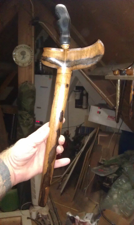

Old 3rd December 2011, 06:57 PM   #22
Harley
Harley's Avatar
Join Date: Sep 2011
Location: Nederland
Posts: 83
I hope you guys can help me with another question, the grain in de java
sheaths are vertical, but so far i can see it from pictures on the net, i rather think that in Bali sheaths the grain is horizontal.
Is that right?

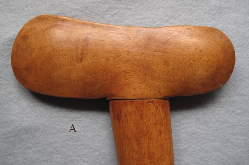

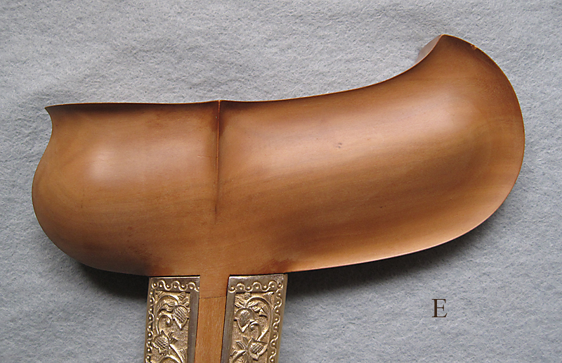

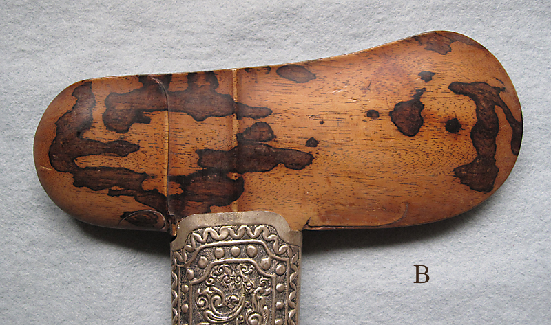

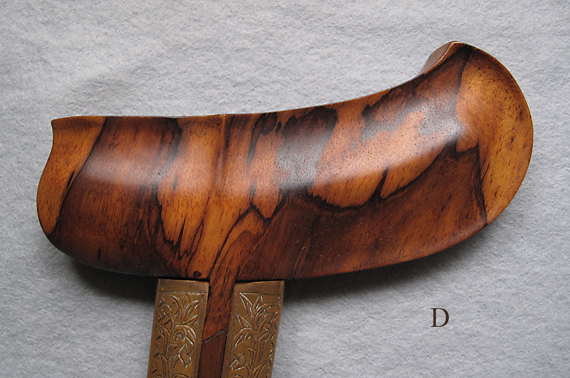

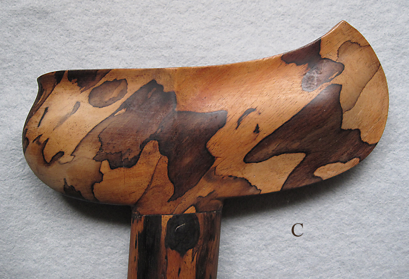

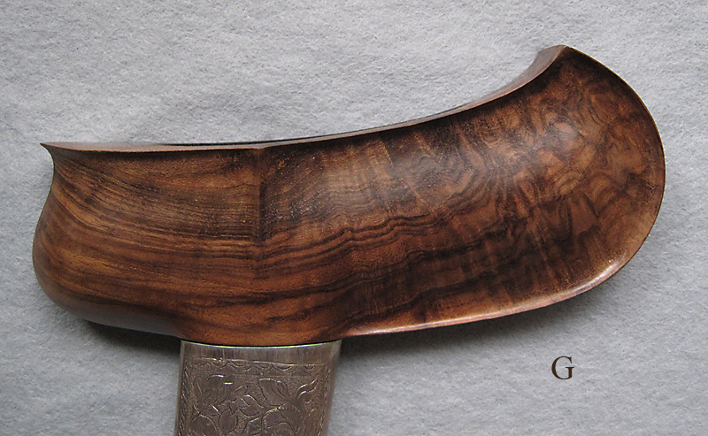

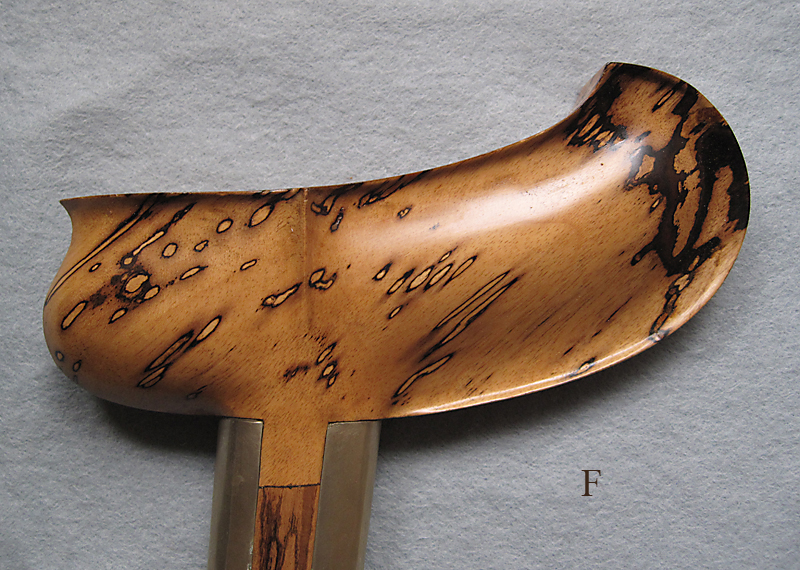

Old 3rd December 2011, 09:24 PM   #23
Posts: 7,229
Yes Harley, the grain in most Bali scabbards is horizontal.
However, it is not that simple with Javanese scabbards.
The ideal grain orientation for a Javanese scabbard is with the grain running at about 40 degrees from the top right, to the bottom left, with the scabbard facing you.
That is the ideal, but a tukang wrongko will change this ideal orientation to suit the grain of the wood, the size of the wood, and to maximize effect.
In some woods it is not possible to get a piece of wood large enough to allow the ideal grain orientation, for instance, in scented sandalwood pieces large enough to allow cutting across the grain have become quite rare.
The examples:-
A--- shown in reverse to allow better ID of grain orientation; this is a typical, village quality Bali scabbard
B--- better quality Bali in timoho
C--- the angle of the grain in this East Javanese scabbard is a trifle too steep.
D--- Solo, and the angle is far too steep, almost vertical
E--- Solo, and the grain is absolutely horizontal, dictated by the size of the wood available.
F--- Solo, and the angle is close to ideal.
G--- Solo, and carved to maximize grain effect.
Mostly fancy grain in a log is maximised by quarter sawing that log, and this is the way we achieve the best results with fancy grains such as feather crotch( Jawa:- simbar), but the tukang wrongko does not have control over the sawing of the log, he gets a precut plank or even a roughed out bakalan , and he needs to make the best of what he has been given.
Old 3rd December 2011, 10:23 PM   #24
Posts: 7,297
Thanks for this illustrated post Alan. Very good information...
Old 3rd December 2011, 10:39 PM   #25
Harley
Harley's Avatar
Join Date: Sep 2011
Location: Nederland
Posts: 83
I am glad that it is, i was already started, with the risk of trowing it away when i was wrong.
I did not expected it was so complicated with the Javanese scabbard, but now i know and can take it to my advance.
I am purely a hobbyist, ho wants to do his best to restore the neglected keris,
cause over here there are a lot of them.
I definitely have not the skills of the craftsmen in Indonesie, not even by far,
but i like doing it.
The examples are really beautiful, very good for inspiration, i see that i had a different example then the Bali gayaman that are placed.
This is what i have done so far, of course it's only the rough form.
Thank you Mr Maisey for your explanation!
Old 3rd December 2011, 11:53 PM   #26
Posts: 7,229
Looks good Harley, you've got talent.
But don't forget the contouring, this is difficult to see in photos and you really need an example in the hand to follow.
Old 4th December 2011, 01:20 AM   #27
This I only can confirm!
Old 4th December 2011, 02:24 PM   #28
Harley
Harley's Avatar
Join Date: Sep 2011
Location: Nederland
Posts: 83
Thank you,
But don't give me to much credit, this was the easy part.
As Mr Maisey mentioned, the contours are more difficult to do, but we'll see.
If i don't place pictures anymore, then you can count it's in the bin, and i have to start all over again
regards,
Ben
