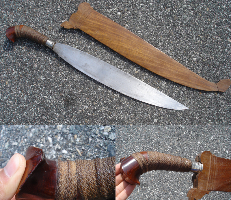

So I decided that I was going to take a break from antiques weapons because of the cost. But, a good deal came along and I decided to temporarily break the hiatus with a quick purchase.

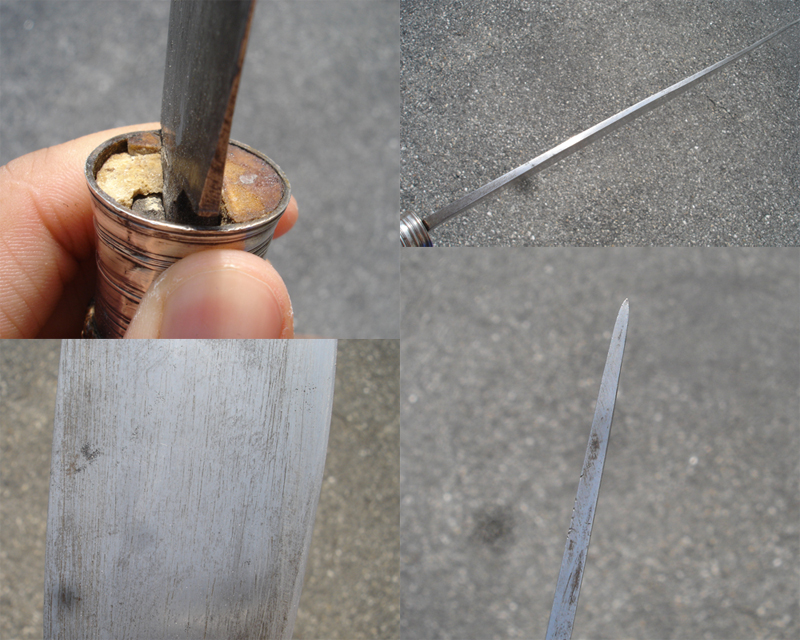

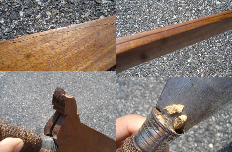

This barong, not sure what island, but I am going to guess Sulu... has a sheath that's starting to split ventrally, has a chipped area near the mouth, the area under the ferrule is beginning to disintegrate, and there may have been more to the kakatua at one point but I believe it was meant to be small and abbreviated... I feel like it was recently made (despite having a very nice and comfortable handle) because the sheath is very plain (though the wood seems good) and the steel... the steel seems to be not very old, not laminated, roughly polished, and without a very good distal taper... After some repair to the area under the ferrule perhaps this will be a very sturdy barong, one I wouldn't hesitate to use given the "not-so-pretty" blade.
My guts tell me its a newer piece, maybe 20th century, but not necessarily for tourists... still, being a novice, I have a good chance of being wrong.
Thoughts?

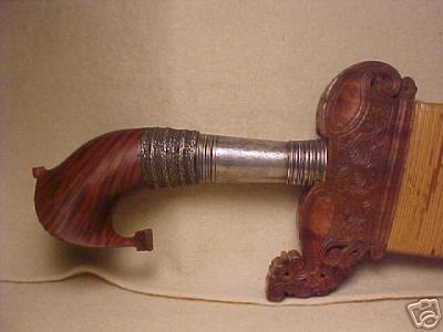

Here is a better explanation:
The barong on the left is Sulu and the pommel is near a 45 degree angle to the blade.
The barong on the right is Samal with the pommel closer to a 90 degree angle to the blade. Also I carved this scabbard in earlier Samal style with intricate okir.

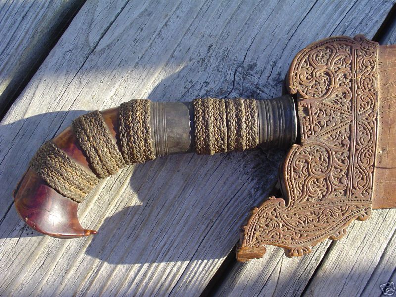

Oh found some of my pictures. Here are some pictures of Samal barongs with similar hilts to yours and how the scabbard top was meant to be originally.

Battara, I forgot to thank you for posting up these photos... the carvings are very intricate and beautiful... and yup, those definitely look very similar to my barong's hilt...
