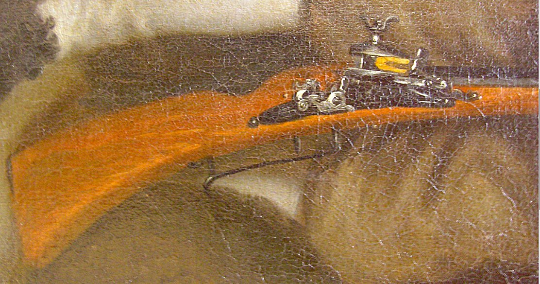

The butt stock of the gun clearly reflects the late Spanish musket form, the lock mechanism is called agujeta, a miquelet type of flintlock variation caracteristic of both Portugal and Spain. Please note the period surface colors: the wood is varnished light while the iron contrasts in blueish or black. With most guns heavily cleaned, we nowadays mostly get the 'negative' impression by the pieces we look at, with their iron polished bright.
Please also note the exceptional length of the delicate gun notably surpassing that of the man.

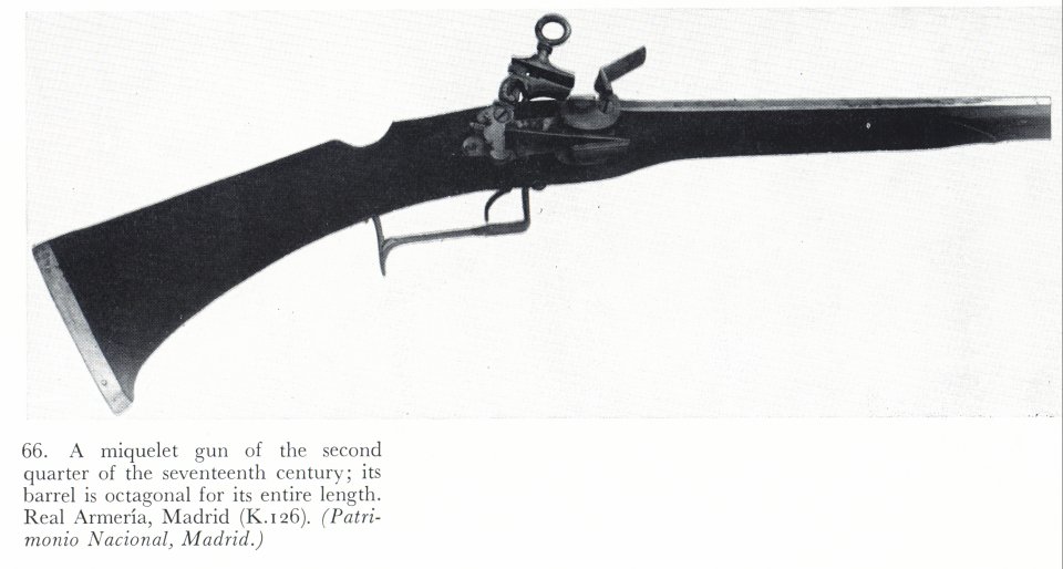

Lavin (ibid., cf. reference above) illustrates a fowler of very similar type and identical period, preserved in the Real Armería Madrid.
I tried to do my best reworking the scan.
m

Efectivamente, la llave (lock) es conocida como agujeta, y fué reproducida por los armeros de Brescia para su exportación a Oriente, conocida como llave "a la morlacca" o "a la mojacca". Los armeros árabes la siguieron reproduciendo mucho mas tarde, hasta recientemente.
Fernando
Indeed, the key (lock) is known as lace, and was reproduced by the gunsmiths of Brescia for export to the East, known as the key "to Morlacco" or "the mojacca." The Arabs followed gunsmiths playing much later, until recently.
Fernando
