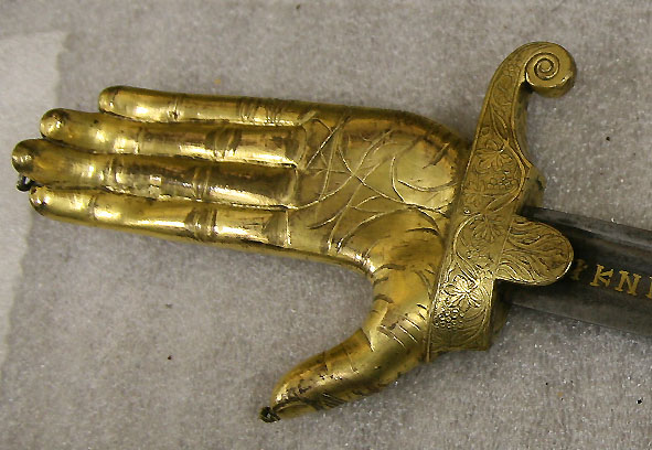

I've only spent a couple of minutes looking at this sword, and the blade initially reminded me of nimchas, because of its smaller size and abrupt curvature. The script looked amharic, but an expert collector of Ethiopian swords confirmed that it wasn't. The hilt also steered me towards the realm of Islam - the Hamsa Hand, but it doesn't really look like other representations of it.
The script could be just a collection talismanic symbols. Unfortunately the photo of what appears to be a winged figure came out blurry.

A very nice and unusual piece.
I get the feel it might be Hungarian and I do believe you are correct in your assessment of the hand, I too would say it is the hand of Fatima.

Tha hand looks more Asian then Islamic. Perhaps Indonesian or Indian...Hand of Buddha???

Interesting to note the back of the hand is covered in flames while the palm is not. The guard shows vine leaves and grapes. Also there seems to be an angel with a sun above it to one side, the reverse seems to be a parasol with ?fire? under it???

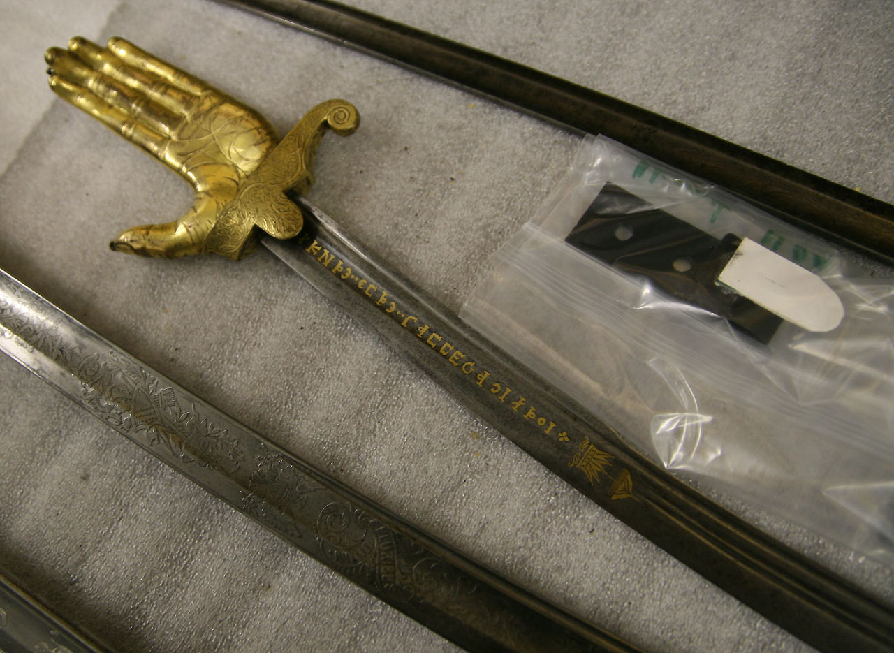

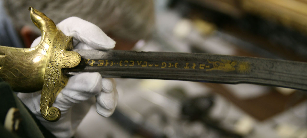

Here's another photo of the front of the blade. Note the crown underneath the umbrella. I am really angry with myself for not taking a better photo of the figure on the other side of the blade.
The sword belongs to the Higgins Armory Museum, and I'm trying to help the curator properly ID it for the exhibition they'll be opening up soon.

The blade looks Indian to my eyes and do I see an Indian parasol mark?

The hand of Fatima would have to be the right one; they (Muslims) wouldn't turn it .

The grapes on the hilt do not suggest India or the east to me, nor does the lettering. I Would suspect some sort of central European parade sword. Could easily be civil society rather than military. The hand is also European think of the red hand of Ulster and the notorious Black Hand which lead to a few years of trouble.

I'm not saying the entire piece is Indian, just the blade. The lettering could be a post-manufacture add-on but the profile of the blade, the fullering and the umbrella/parasol mark are quite Indian. The crown is unusual with the parasol mark. We have to remember that blades from India can be found in East European and Western mounts. Look at the spine of this blade. This form of blade from India often, not always, will have a recessed or fullered spine and this feature is not common in blades from other parts of the world. I doubt the blade is in good enough polish to see if it is watered or not and being from India it could be anything but take it into good sunlight and see if you can notice any pattern welding or other watering. Also, it appears there is the slightest hint of a "ricasso" at the cutting edge of the blade near the hilt which is quite reminescent of some Indian blades which are sharpened a few inches down from the hilt and over long periods of time can be "indented" quite a bit.
In thinking about the script, there are a number of Indian blades that have European style lettering that is basically non-descript, done in imitation of European markings. This script reminds me of some of those examples.

Here is a link to a discussion on the parasol mark and pictures of a couple of examples.
http://www.vikingsword.com/vb/showth...hlight=parasol
In my experience, you only find the fullered spine in Indian swords and occasionally in Polish/E European blades and also in Chinese blades. Given the size, blade fullering and general look I lean heavily towards this blade being Indian.

Interesting sword indeed. I too would not be surprised if the blade was Indian. The 'script' has runic elements, common across Europe, probably added later. The other noticeable thing is that when the sword is gripped you are effectively 'shaking its hand'. Perhaps relavent....perhaps not. The shaking of hands is symbolic of being unarmed/non threatening (as most people are right handed ....you would have to either 'sheath' your weapon or place it in the left ...to be able to 'offer' your right hand. (unless you happen to be a left hander (sinister) and had murderous intent

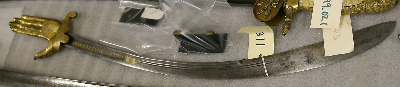

I would love to see the entire profile of the blade. The raised forte, and raised yelman(?) suggest Eastern Europe (Hungarian-Polish), Ottoman, maybe Chinese.

The script may resemble the runic characters, but in a way of imitation. I don't think there is any meaning to them in the conventional sense, i.e. these are not abbreviations of anything in the Western vernacular. In other words, they have nothing to do with the abbreviated inscriptions on the Viking period swords, in my opinion.
Here's an additional shot of the blade.
