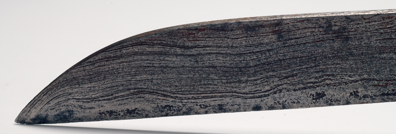

Old 30th September 2010, 06:24 PM   #1
Smile FINE SWORD, INDONESIA OR MALAYSIAN ?
I BID ON THIS RECENTLY BUT IT GOT AWAY BUT I SAVED THE PICTURES TO SHARE AT LEAST WOULD BE INTERESTED IN ANY OPINIONS ON ITS ORIGIN, IT IS 27.5IN LONG. GOLD AND SWASSA ENJOY!

Very nice.
I would say Indonesia, Sumatra.

The handle resembles a lot of klewangs attributed to Sumatra and Lombok...

It's obviously a klewang.
I would say it could be Lombok Island, as well as Sumara.
Is the handle horn? If so, more likely Lombok, where they really do fantastic carving on horn.
I have a collection of these carvings. Will show soon.
They seem to really prefer horn there on their klewangs, whereas elsewhere (Sumatra) it is more likely to be wood. Also, these very nice ones were usually worn as court swords in the Lombok royal court. Though I've not seen a gold hilt before, I have seen this kind of quality with silver hilts (all from Lombok Island).

I'd would have said East coast of Java to Lombok would be correct, but the chiseling to the forte and the style of repousse say clearly to me Sumatra. All very fine quality!
These are all a mystery at best to me when placing with exactness. Zonneveld shows a similar blade profile as a Pedang III, also noted to have pamor..

That Pamor and tip shape reminds me of the Dua Lanan I have here. These swords from Sulawesi also have simple horn fittings to the ends however this example above shows the throat shape of West Java and Sumatran, Zonneveld figures 557 & 558 for Java and 274, 397 for Sumatra which represents this example best in blade profile and scabbard in my opinion.
Gav

I have yet to see any Peninsula Malay weapons with this very distinctive form of hilt design. Especially the foliage ukiran on the hilt. After thinking it through i would say that i could see a shadow of a semblance of a makara form form in the general outline of the weapon's hilt. But that outline is only a semblance of what a makara outline would look like.
As for the blade itself, i would have to agree that it is more akin to what would be found in Sumatera and perhaps lombok. But not likely in the peninsula. The form of the blade, especially the markings and the pamor combination is just something that i have yet to see there.
There is just something rather odd about the combination of the blade, the markings on it and the hilt form and decoration on this weapon.
