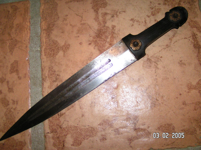

Default exemple kindjal
For example
Here my kindjal.
The center is engraved with etching.
But it is not Damas.
