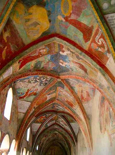

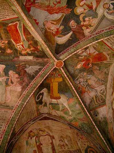

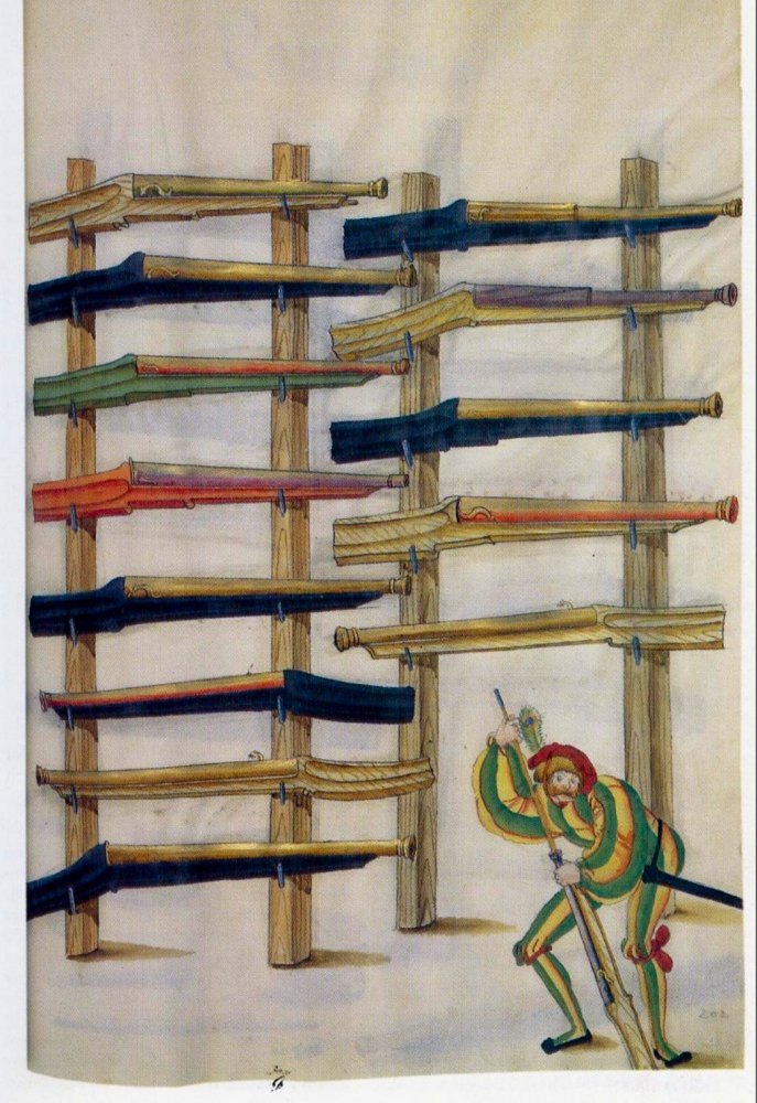

Hi 'Nando,
This is indeed a very thick paint of minium. Though it was not primarily used as a rust inhibitor, it was the final layer, apart from a later black coat of paint that was sometimes applied in arsenals in centuries to follow.
As I have tried to point out several times, red and green were the basic colors of the Gothic period, used for stone as well as for iron and wood. It actually was a very colorful period.
I attach two photos of the interior and the ceiling of the cathedral of Brixen, The South Tyrol, as well as a display of arquebuses in a Maximilian armory, ca. 1507, in order to convey the prevailing impact of red and green in Gothic everyday life.
Michl
