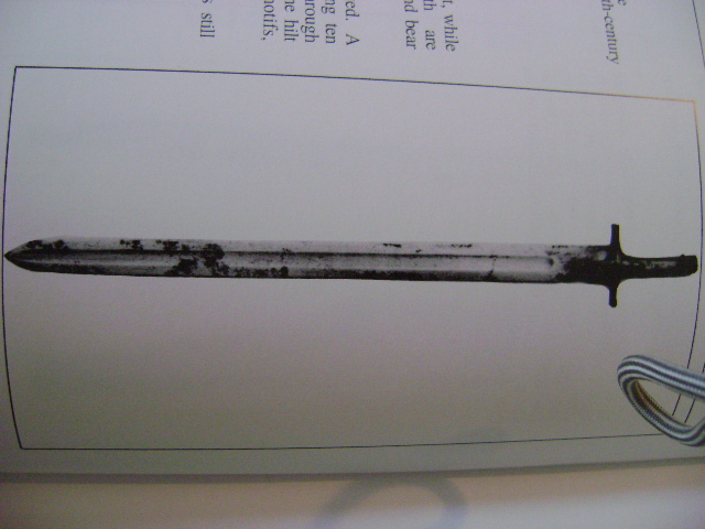

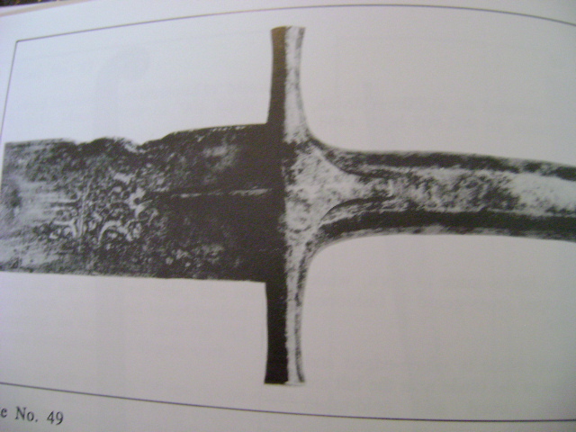

Here are pics from Yucel's book ( the best collection of mamluk swords, albeit of a poor photographic quality). This is a 15th century Mamluk sword with the blade and the crossguard identical to classic old Kaskara. Well before any similar Ottoman examples ( although there are no known Ottoman swords before the time of Mehmet II, so caution is needed here).
Slight difference in the form of the handle ( disk instead of pommel cap), but this is minor and may be just a labor-sparing maneuver.
Similar examples , albeit with shorter quillons of decidedly similar configuration) dating to 13-15th century, are also shown in the book, but the pics are atrocious.

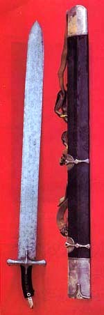

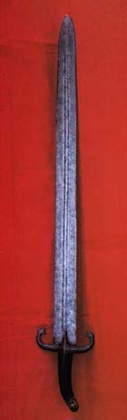

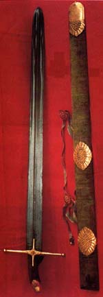

Here are a few pics of the swords of the Prophet Muhammad they have a very similar shaped blades and cross guards compared to the kaskara.

Lew, thank you so much for posting these magnificent swords, and these well illustrate how the reverent tradition for the broadsword remained well in place in these regions even into present times. Well done, and very much appreciated.

The examples from Istanbul have original blades ( early Islamic to ~ 14-15 century), but most handles and crossguards were reworked by the new Ottoman owners. Thus, most have typical slender crossguards. But the original Mamluk examples have very much kaskara-like configuration. some with much shorter quillons.
