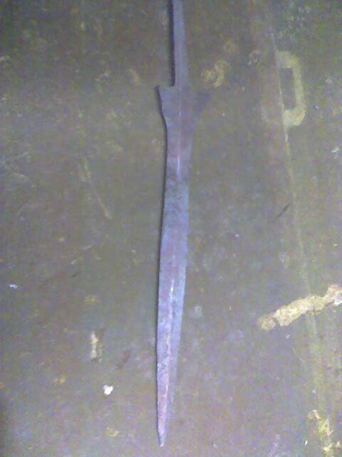

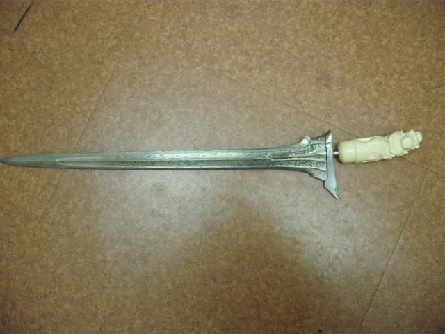

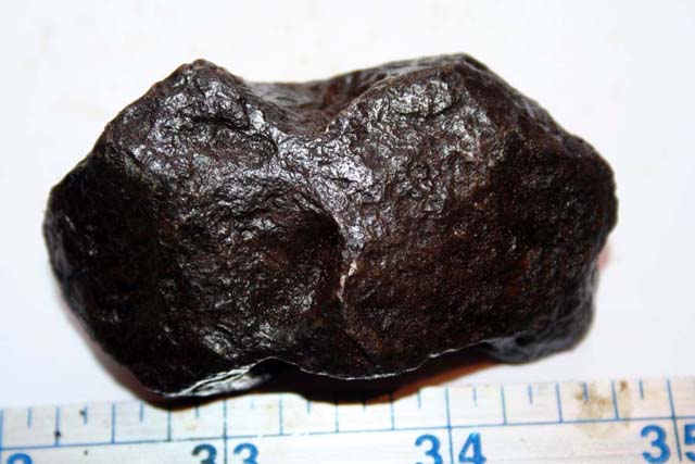

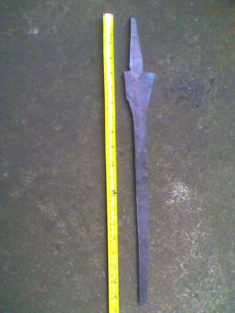

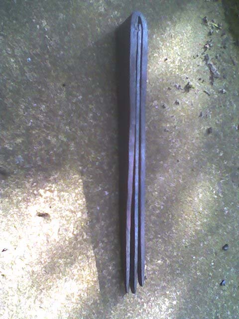

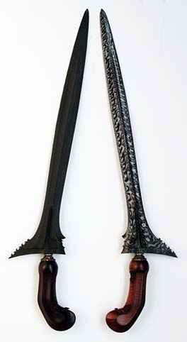

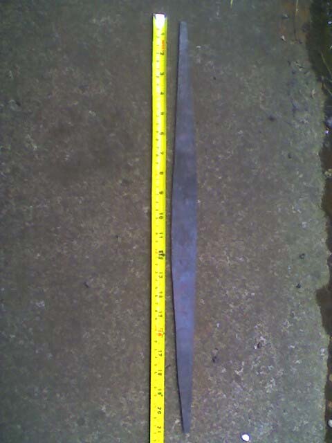

Well gents, here's a sneak preview 19 inch blade of the usual construction-iron from all over, meteorites, horseshoes, stuff I've found lying around waiting for the enterprising smith to pick up.............I have it all written down with weights etc, more of that later.

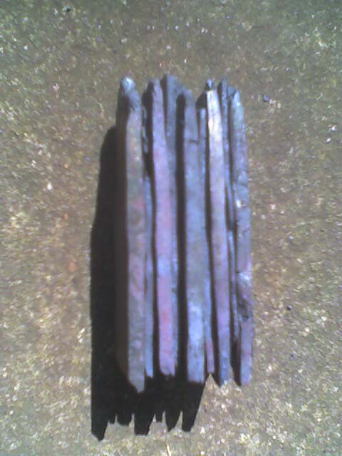

I don't have much of this blade's early days but there is a picture of one of the meteorites (Campo Del Cielo 195g) and one of "block 3" before welding, 9 layers of iron and pure meteorite, there were four of these so 36 layers a side. There's some photos of the pamor drawn out ready to bend and insert steel, the blank ready to weld, the blade partially forged and fully forged. The selut progress is documented too (got a new camera!) Togog development to follow.....

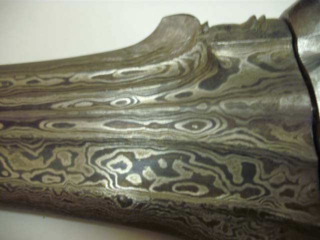

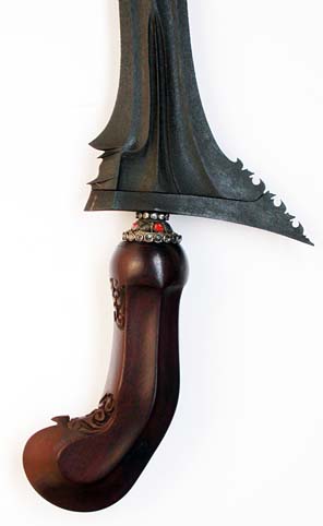

The full view and closeup of pamor....

Amazing to see this in progress.

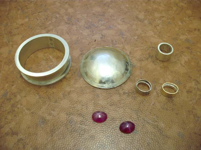

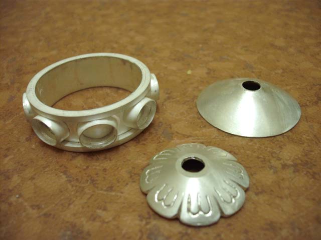

The settings for the stones/glass on the selut, are they prefabricated ?
Nice dapur, I like it "simple" with no luks.

Bravo, Lemmy....
Magnifique garap. The dhapur, probably similar to these Javanese "PASUPATI". The one with pamor, was made by a Solonese keris maker Ki Sukamdi, but the kodokan is Maduran made...

Hi all, many thanks and glad you like it so far...

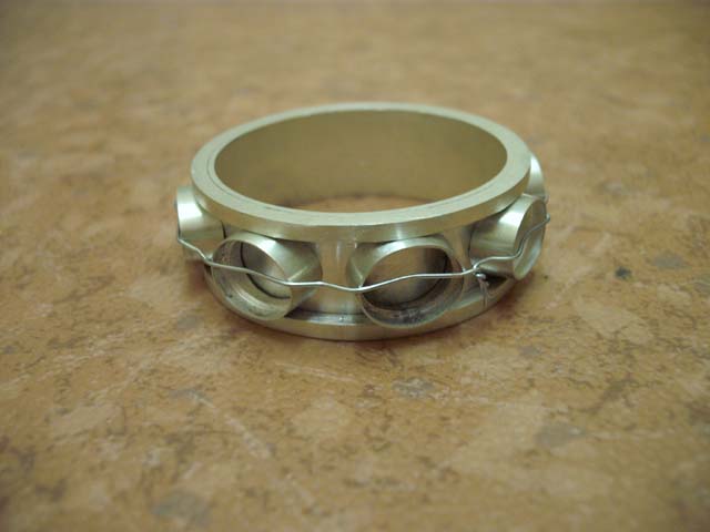

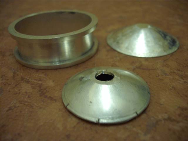

Willem, the settings are made from bearer so they are cut from strip, bent and soldered so you have a built in "ledge" for the stone to sit in. The stones are laboratory grown star rubies.
Ganjawulung, dapur is pasopati-in fact I studied both of your keris whilst making this one. The ganja is "wulung" too!
More to follow, hopefully this weekend (lots of togog pics to resize)
Thanks Lemmy !

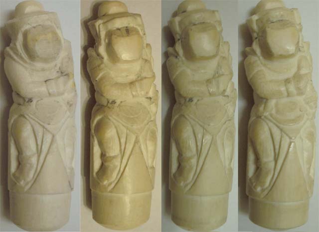

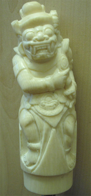

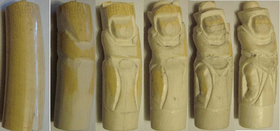

Hi all, here's some pictures of the togog in various stages (well the front views anyway) his left foot is a little more developed since I took these snapshots.......

lemmythesmith
lemmythesmith's Avatar
Join Date: May 2007
Posts: 93
Now with added face....

Wonderful work lemmy, great carving. What type of bone, and are you using only hand tools for this?

Thanks all!! Thought you might like him! He's carved from a portion of a elephant tusk I bought many years ago, but it's only now I feel confidant enough to tackle such an ambitious project. I tend to "rough out" a carving with a dremel using burrs/small milling cutters, fine detail is added with various knives and scrapers, my favorite carving tool is a sghian dubh I made with a damascus blade which takes a wicked edge! I haven't done any more on the selut as yet, but I can feel an urge to do some silversmithing coming on.... (once the urge to make a tanto copying the work of Etchu Norishige goes away, but enough of my problems..... )

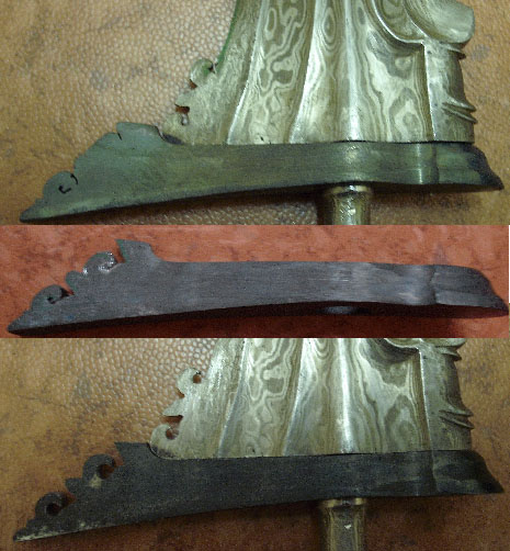

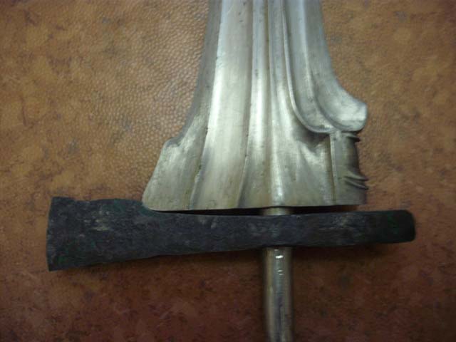

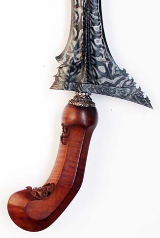

Hi all, I've made a start on cutting the greneng I'm going to leave "as is" for a day or two then go back to it, needs a few more coats of looking at!!

You are really doing a great job. Not only smithing but carving. I am very,very impressed. One question: in your last photos you show us the ganja, neatly adjusted to the blade but on the first and the last shots, you show the peksi (the flame) of the kris blade with an enlargement right after the ganja. I can understand why you did that (to block the ganja in its place), but I cannot see how you realized it.
Can you explain ?
Thanks and really "bravo" it is a superb work.
Michel
I think I found the way: your peksi is not part of the blade but is screwed in the thickness of the blade ! Right or wrong ?

In Javanese the word for a keris tang is "pesi".
The word "peksi" means "bird". It has the same meaning in krama as does "manuk" in ngoko.
The word "pesi" has the alternate meaning of "bird", but the word "peksi" has only one meaning, and that is "bird".

Question
Should I be looking for a ron dha in a Bali piece ??
Or no ?
Old 22nd August 2009, 02:32 AM   #29
Posts: 7,255
Yes Rick.
If a Balinese blade has a greneng, that greneng should show ron dha of a specific form.
I suspect that Lemmy has moved in this direction and perhaps when he completes the greneng he will have produced an acceptable ron dha.
There are other minor points where this blade does not conform to a Balinese standard, but I must emphasise that these are minor points, and I for one am not prepared to level criticism at Lemmy's effort.All the rough outlines are there, they just need to be refined and finished.
