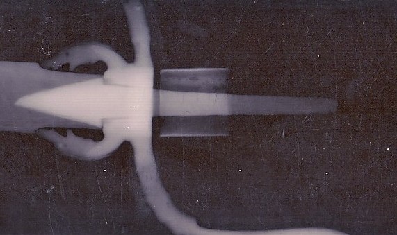

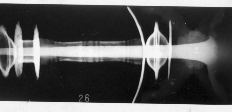

Some information on your question on X-Ray. I have used X-Ray for non-destructive examination in the past exactly for what you intend to use it for and it has proved successful. I attach two images, the first is through metal and even shows concealed rivets and the second one is an X-Ray through the horn grip and brass ferrule of a Kastane.
Good luck.

Artzi, I am grateful to you for exposing me to this method and thank you too Anandalal for providing those interesting images of the kastane, I got quite a kick out of seeing those Kastane features in the x-ray.
