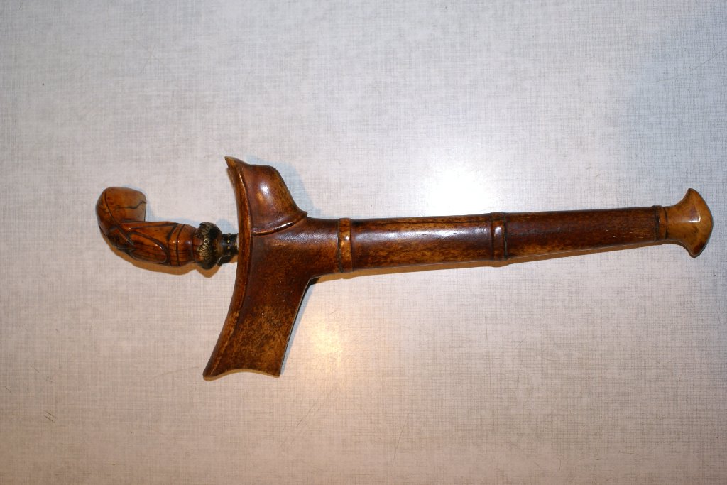

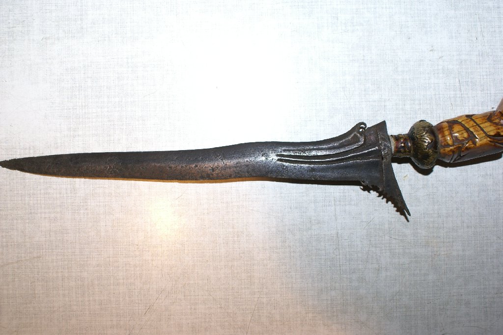

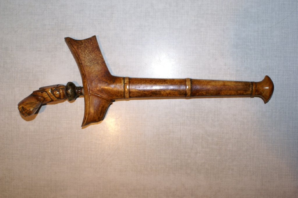

2001 I bought on Bali two small Sumatra keris. A similar example I found in the book "The Invincible Krises 2" on page 142/3, not from the blade but from the sheath, I think that it is the same material. Mrs. Ghiringhelli write that she wasn't able to identify the kind of bone. I thought that it is whale bone but never have been sure.
I think that it is a Minangkabau keris, handle from elephant ivory in Jawa Demam style, the pommel of the sheath also. §-luk blade very fine executed. When i get the keris the blade have had very thick corrosion.
The sheat is set together from four parts and have a glossy old patination. The blade fits perfect inside the sheath and I believe that all parts original.
The keris is 31,5 cm long inside the sheat and the blade alone 20 cm without peksi.
Every comment and information are welcome. Special about the origin, sheath material and dapur.

Yes as I have heard this material is whale bone.
I have a hilt of the same material.
Hope someone with more knowledge can confirm

I am not really speaking from any actual knowledge , but it dies seem to have the right porous quality that would be right for whale bone.

Hello Erik, thanks for your reply. I don't have to much experience with this material, I also have a handle from Bali whereof I think it's from whalebone but this one is not so heavy like this sheat so I'm a little bit confused. And I think also that Mrs. Ghiringhelli will know about this material.
Old 14th January 2009, 07:07 PM   #6
Thank you David. Yes, the porous let me think it's from whale bone but the heaviness let me doubt about.

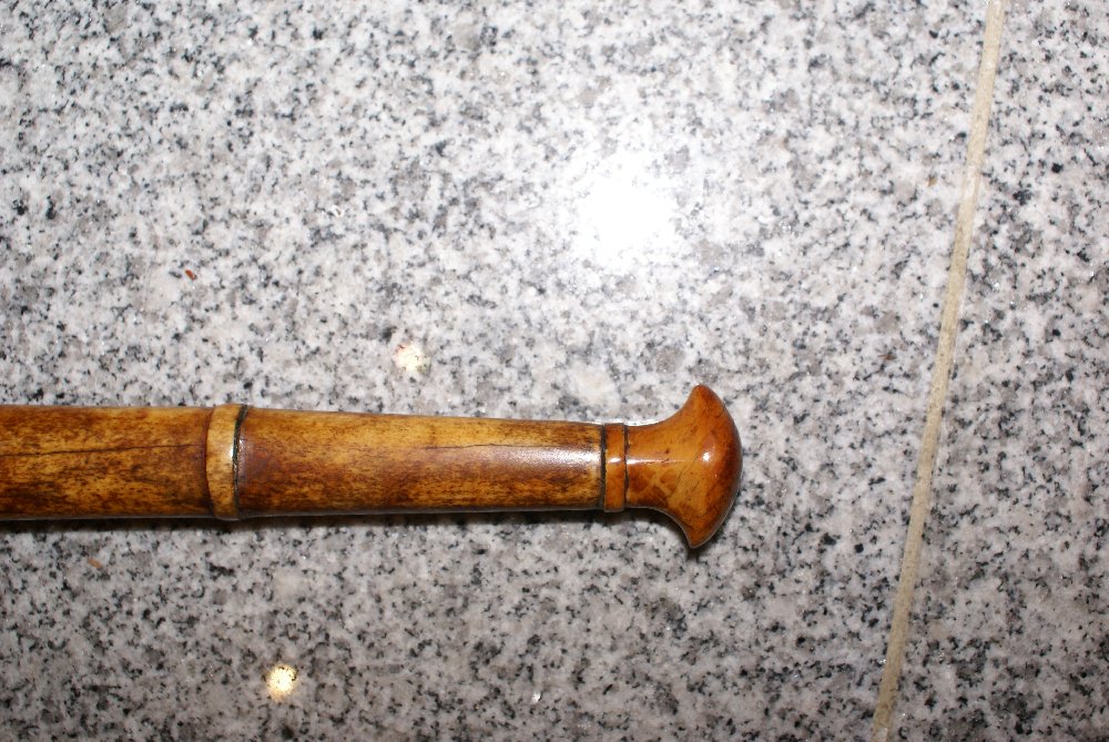

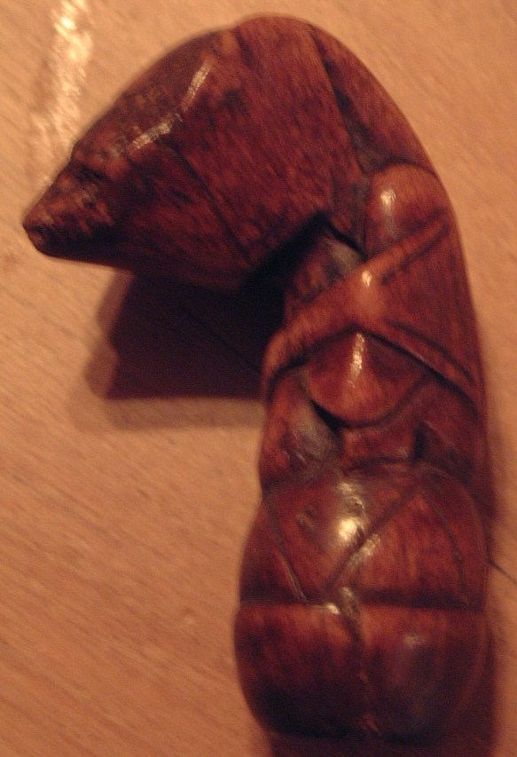

Here a closeup from the tip of the sheat, maybe it help to identify the material.

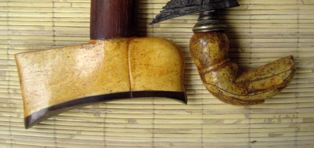

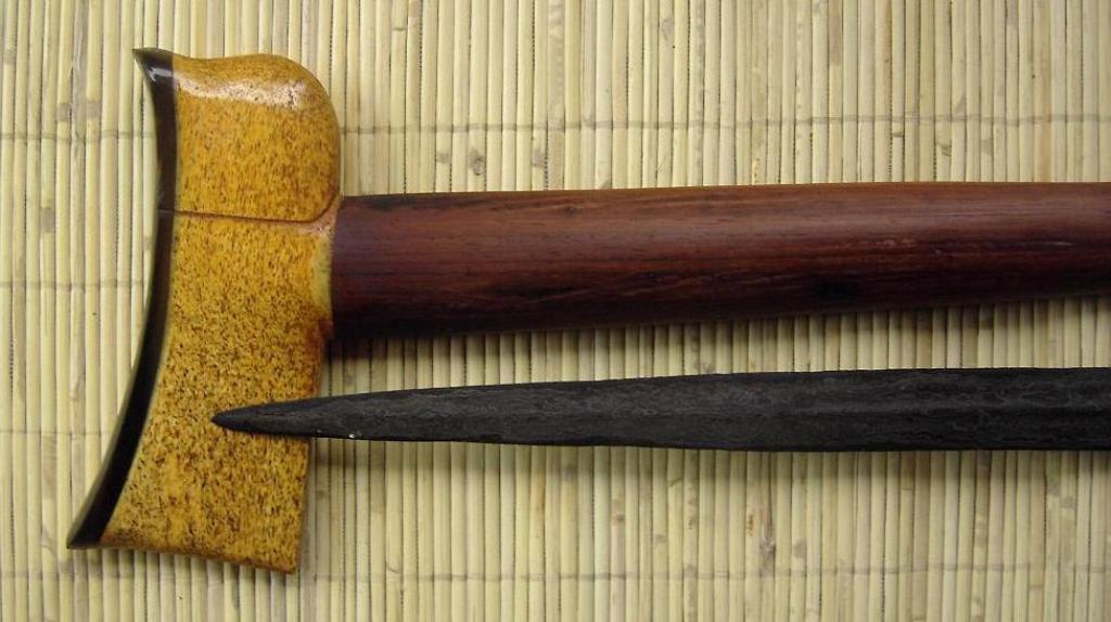

Marcokeris
Marcokeris's Avatar
Location: Italy
Posts: 928
I'm not so shure the nice sarong comes from whale bone. From bone shure! But from whale...
The very nice hit from pics seems to me ivory.

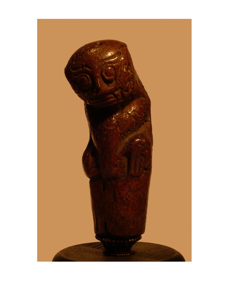

I put here two hits (from whale bone or from elephant bone i don't know... ....maybe some expert could help me to know better.

Hello Marcokeris, yes the hilt is from elephant ivory.
For me it's also very difficult to differentiate between bone materials.

Alam Shah
Alam Shah's Avatar
Join Date: Jan 2005
Location: Singapore
Posts: 1,248
Default Minangkabau Luk 3 keris
Hi Sajen,
That's a nice minangkabau keris you have there. The blade is Minangkabau, Luk 3, similar to mine (( link )). Minangkabau fretworks (greneng) is smaller and delicate looking than most.
The fittings, as you've mentioned are Minang, as well.

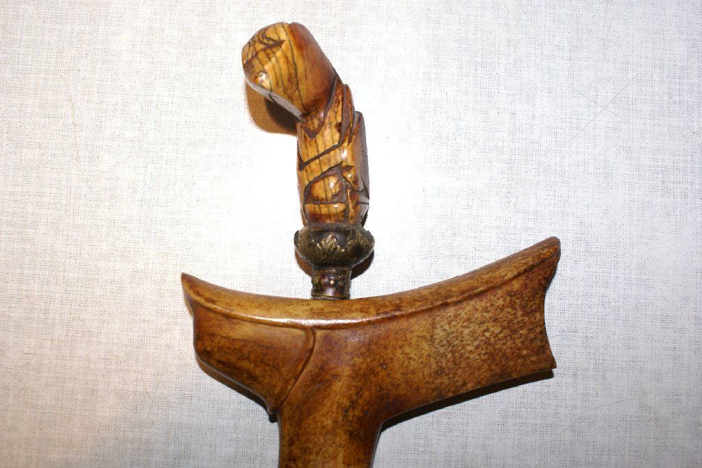

welcome to forum. As i can see from your pics.. i think it may be ivory. can you post biger pic of only the hilt? i see stucture that may resemble elefant ivory structure.. crosed lines.. i doubt it is whale bone or other bone.. but im no expert.

Michel, it is not the hilt that is in question. I believe that is ivory too. It is the sheath that is made of some sort of bone, with ivory at the tip as a buntut.

IMO, deer horn.

Scabbard is whalebone. Ukiran and buntut are ivory.

Hello Michel, yes the hilt is from elephant-ivory for sure. Also the buntut is from this material.
Hello Marcokeris, I be in doubt that the warangka is from deer horn. It's 11,5 cm long and where the gandar go inside 5,5 cm high. I've never seen a large deer horn like this especial when you consider the some material have to be carved away.

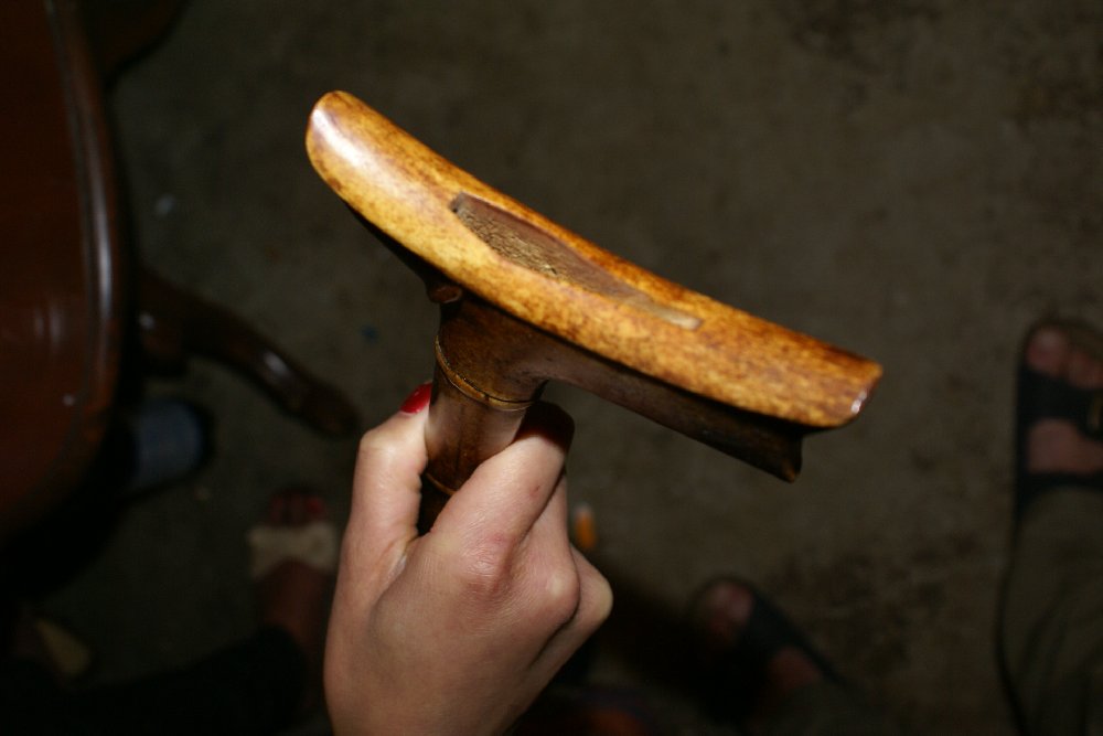

Hello Henk, I will try to photograph the inside from the warangka. Mrs. G. is the author from the book "The Invincible Krises 2". Look in up from this threat, in her book is a keris with similar sheat.

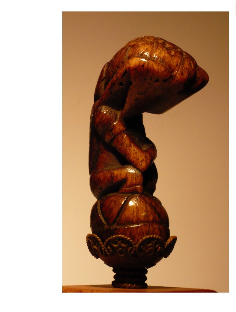

Old 17th January 2009, 07:40 PM   #24
erikscollectables
erikscollectables's Avatar
Join Date: Nov 2008
Posts: 318
I have a hilt of similair material as this sheath and it is posted above. It is clearly different from any other bone hilt I have in my collection. Both structure and coulour are quite different from the regular bone hilts I have seen so far. The person with whom I traded it mentioned it that it is whalebone. So without any in depth knowledge I still go for whalebone untill a better option comes along....
Regards, Erik

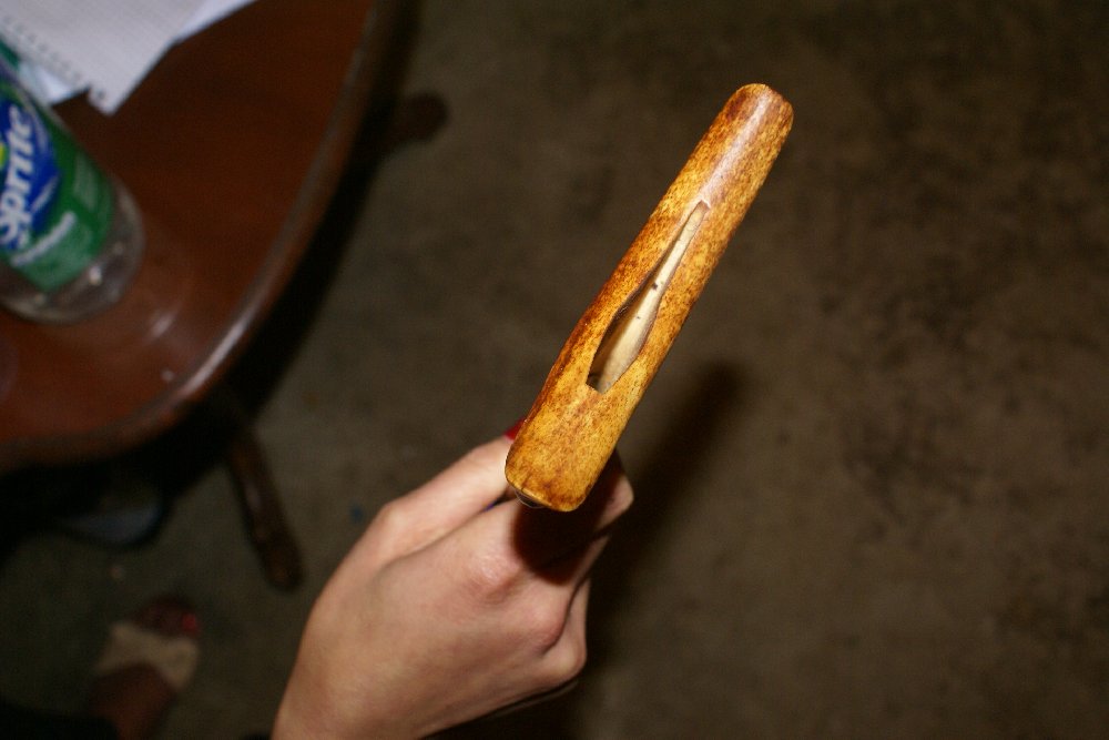

Old 17th January 2009, 11:58 PM   #25
Hello Henk, difficult to photograph the inside, this the best what's possible for me.

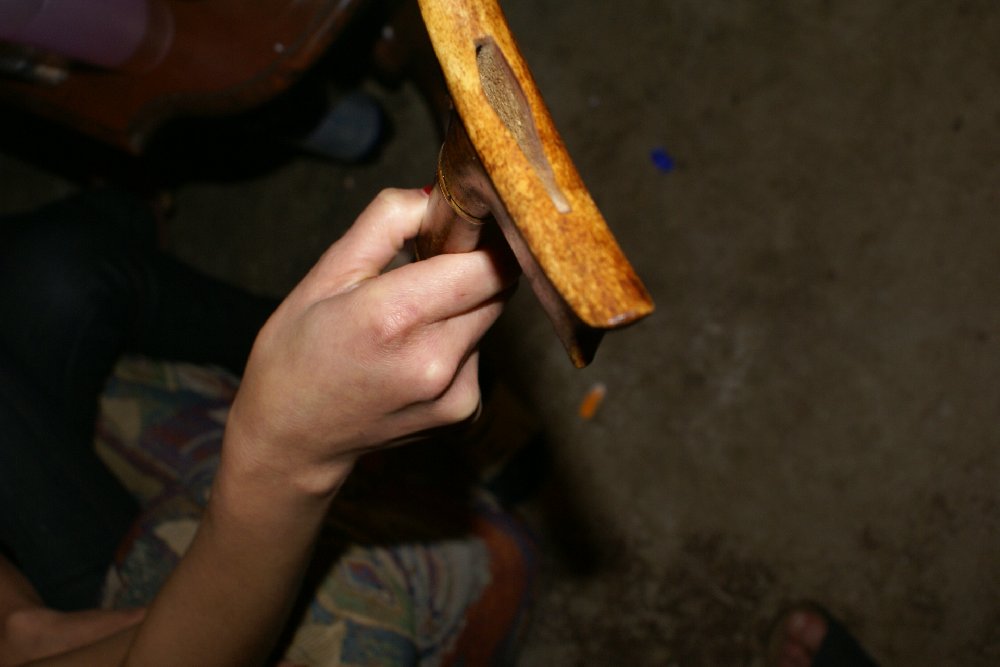

Old 18th January 2009, 12:01 AM   #26

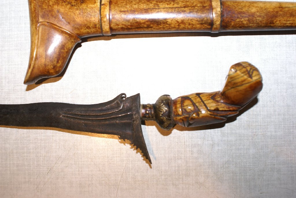

And a third one.
Old 18th January 2009, 07:46 AM   #27
Henk
Henk's Avatar
Posts: 1,209
But enough for me. Well done!! Whalebone!!!

I'm with Henk, Whalebone!!
