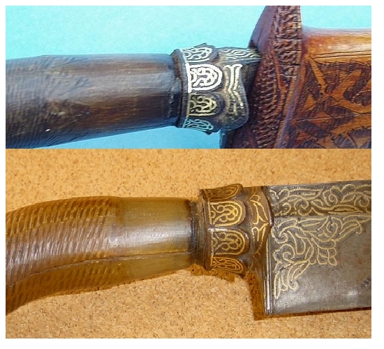

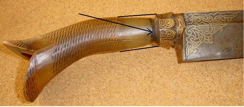

Using the search button i have learnt that this type of grip ( Hulu) is called Rumpung ( hope i'm right).
Entering RhysMichael's excelent work i figured out this sword style would be a Peudeueng Panjang. Somewhere i've read Panjang means large?
What i didn't yet find out is whether this specific style, namely the grip, is typical of a determined subethnic group ( Aceh , Gayo, Alas, etc.), or is generical to all.
However my main question goes for the way the grip fits to the bolster. Despite the quality of this piece being of a certain level, i don't find a reasonable explanation for the fact that the grip ( throat? ) diameter is clearly narrower than the bolster, not to mention the sort of crude gap at the junction. Also surprising is the lack of decoration "scales" on the horn material in that area. I first thaught that all this "irregularity" meant that some sort of decoration ring or crown has being there before and, for imaginable reasons, was later "harvested" from the handle.
However i have lately seen quite a few pictures of these swords and i don't find that the ones of this type, those with inlay on the blade, have additional fittings on the grip.
It could be that what i have here is a handle replacement, but i don't realy think this is the issue.
Could it be, however that, these handles are typicaly (un) finished this way ?
I know that some members in the Forum have great knowledge of these swords and have already handled several examples.
Could i please have some input on this subject ?
Obviously also general coments will be welcome.
Much obliged.
Fernando
PS
I have made a sketch on the handle extra picture, to support my poor english text .

If there was an crown or ring on it you see it on the hilt .
If you take an look at the swapforum an rentjong is sold missing part off the crown as you can see it is carved in the hilt and different color where the missing piece was .
I never see an crown on an inlayed blade like this and like to see an picture of it if it exist .
The litlle darker color below the hilt is from rust .
Name off hilt hulu rumpung page 125
Ben
ps don t you have zonnevelds Book (an must for the weapon collector)

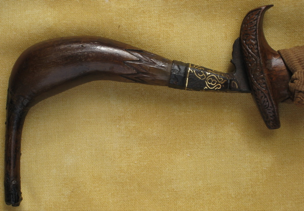

I also get the impression that a piece of gold ? has been harvested once
For comparrison 2 Sikins with gold inlay.
The first I still have, the second I sold last year much too cheap.

Hello Fernando,
A smooth area near the base of the hilt (close to the blade) might be original in finished condition: At least the typical hilt of pedeueng pasangan does come with such a smooth area (it's grip is thicker though and the widening area between bolster and grip is usually smooth - thus, it may not be comparable). I don't recall a pedeueng panjang grip with such a smooth area - would need to screen my sources...
Also, horn hilts in low humidity are prone to shrinking and you often see a gap between hilt and blade.
However, in your example there is a kind of iron spacer between the bolster with inlay and the horn hilt. It looks pretty unfinished to me - at least, I wouldn't expect such a thing to be originally exposed to view in such a status weapon! OTOH, it looks like a perfect attachment for a crown IMVHO - I'd guess this may have looked like in the 2 left examples on the pic from Ben's collection (i. e. not being of the spiky version). To me, this also seems to be supported by the horn hilt having a much smaller diameter than the bolster -something I wouldn't expect to see in quality workmanship either!
Actually, I have a rencong with inlaid bolster which once had a crown of the spiky variant: This is clearly shown by the marks visible at the base of the horn hilt (as Ben already mentioned). I'll try to post a pic soon.

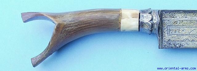

Attached is the picture of one of similar kind, that i found at Oriental Arms arquives, in comparison with my example.
Fernando

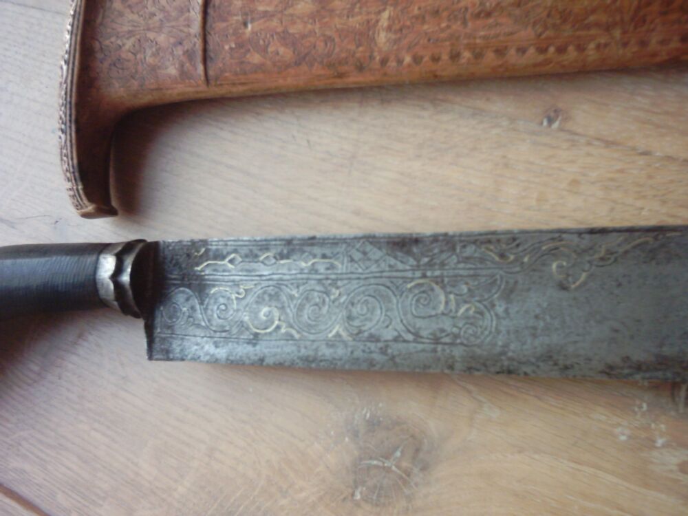

Hello Fernando,
Although the thickness gap between the two parts is somehow outstanding, this appears not to be an uncommon irregularity, judging by other examples one can see out there.
Also i have yet not seen a sikim of this style (blade inlay) with grip (crown) ornaments.
Actually, I think that this piece from Artzi might be another example of an inlaid blade with (missing) golden crown: If one looks closely, there seems to be the "shadow" of a spiny crown visible where the hatching of the grip starts. It doesn't show the typical deep marks/impressions of the spikes (those Ben and me are referring to) though. However, even if this example doesn't help to prove the case, I believe it should be enough of an indication to keep an open mind on decorations of Aceh blades...

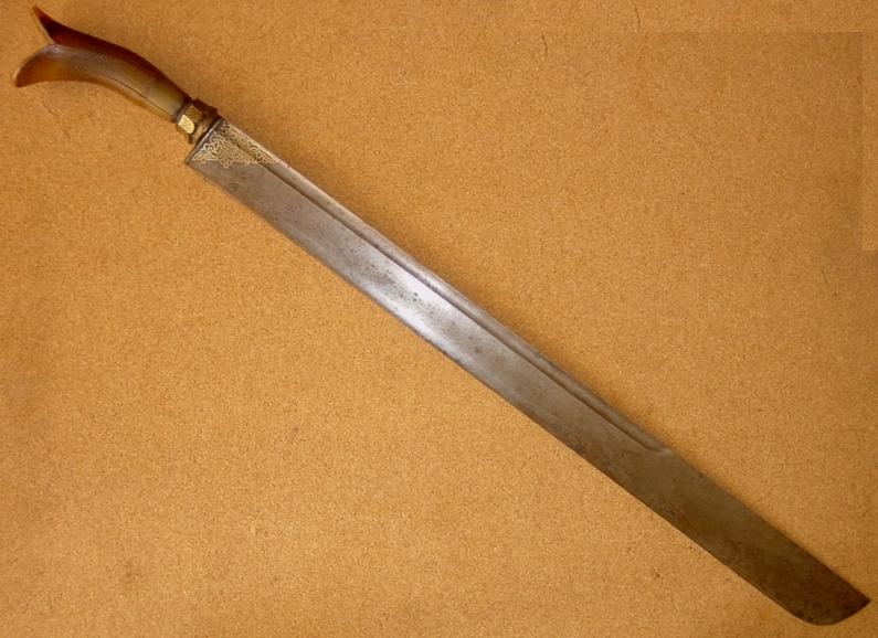

Interesting thoughts on this variation of Sikin.
Here is mine, also acquired from Oriental Arms.
As you can see there is a bone ring as a spacer between the crown and the horn handle.
http://www.oriental-arms.com/item.php?id=1067
Michael

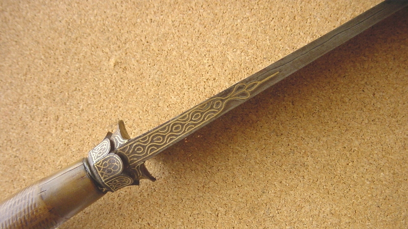

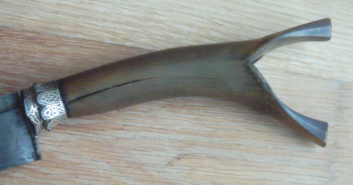

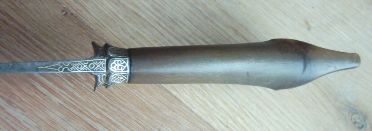

Here's my rencong with gold inlay, once present crown (triple spikes representing a bamboo shoot), and also the whole hilt tip once covered with gold (as shown by a piece of gold still attached to the damar).
Seems to me that this combination of gold decorations is a genuine Aceh variation. I, for one, like it...
This rencong has seen hard times; I'll post pics when its state of preservation allows to show more details.
