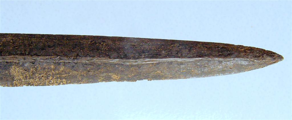

My first post in this forum. I have a few keris, mostly Java and Bali with a few others. My focus has been on Moro, but am re-developing an interest in the Indonesian varieties, particularly the Javanese and Balinese.
I have this keris on loan from a friend. She mainly collects African artifacts, but came across this keris. I am guessing Madura. Would appreciate frank comments.
The blade is in serious need of cleaning and staining. I have her permsiion to do this and may give it a try if it would be worth it.
Comments?

That's a pretty nice Gabilan style piece Bill .
If it's a souvenir it's a very nice one .
The blade is lovely from what I can see but as you say it needs cleaning .
A soak in pineapple juice might be called for as a starter .
The horse motif is nicely carried over to the pendok .

Yup, a madura keris it is. As Rick mentioned, you need to clean it to remove all the rust, using citrus or pineapple juice to start. The blade may not be the best workmanship but interestingly, the pamor is not common. Here you have pamor dhadung muntir (in javanese term for twisting rope?). Overall, its a nice keris. You may want to change the hilt. I prefer the hilt to be something like below.

warangka : maduranese
dhapur : sinom
pamor : dadung muntir ( twisted rope)
the graneng and the other ricikan like sogokan and tikel alis was not well executed. it's a new keris from madura.
how ever, recent keris from madura are also made in a traditional way.
the mendak(ring) is a low quality one, the handle shows a crack in the midle,
couse it made from sawo wood ( not a hard one). the carvings are very fine.

That's a lovely maduran keris. Worth cleaning and staining.
The ukiran is the cuirassier type. Very well carved. The crack is a pitty.
http://blade.japet.com/KRISS/K-Ukiran/U-madura.htm
The wrangka is very nice carved as well. The pendok has the typical maduran european influence like the lower piece of the scabbard of a sabre.
Maybe a newer keris but in my opinion a very nice one.

Nice keris and I think it’s in original shape, no need to change the hilt.
The warangka is in Urang Urangan/Deng Udengan style, The hilt in Ukir Topi style (hat/cap)
The flying horse carved on the warangka called Mega Remeng, this is a legend about a flying horse owned by Jokotole, a king of Sumenep.
Now, it is not easy to find original keris like this even in Madura, Well…accept going door to door to collector houses. So…nice keris and just keep it, it is worth.

The blade is soaking right now. Let's see how it cleans up. Now, If I can get my hands (with gloves) on some arsenic.......
