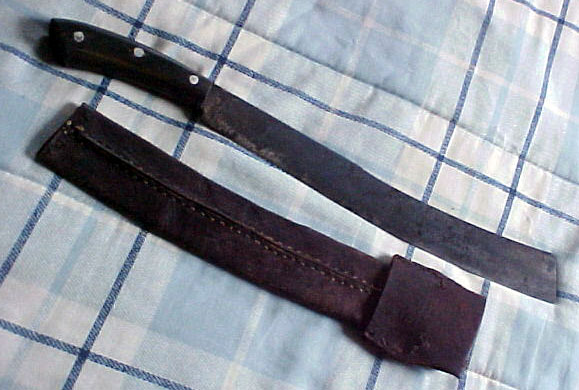

Here's another that's even newer appearing due to the riveted hardwood scales, while the sheath (which I've temporarily misplaced) is of nicely tooled heavy leather and has the "Visayan sash tab" frog(my invented term, sorry) to keep it from sliding through a belt or rope (my guess is 1950's).
At first glance, "machete" pops immediately to mind, while in truth it's nearly indestructible and is my favorite tool for clearing brush, splitting kindling or even felling small trees.
Likewise, the blade appears flat, but upon close examination is expertly constructed with a sideways distal taper(right word?) and even ONE SIDE ONLY almost imperceptably rounded so that it sharpens to and holds an unbelieveabley keen cutting edge that's slightly reminiscent of a chisel grind in addition to the characteristics of a normally tapered blade.
The blade also appears to have been intentionally "blackened" except for the hardened cutting edge in a fashion totally unfamiliar to me.
Where it meets the hilt the blade is 3/8" thick, becomes thinner from top to bottom at mid-point where it curves up slightly instead of having a fuller and weighs a hefty 1 3/4 lbs.
While it's definitely a tool, it's anything but cheap and effectively beheaded a 6 1/2' rattlesnake that waited until I was far too close to rattle, temporarily becoming a weapon of need while I was out cutting saplings for spear hafts.....hey, instinct is instinct.(**grin**)
Mike
ps...found the better photos, sorry

Conogre, nice looking sword; I find especially interesting the way the "scales" are just barely longer than the tang and drawn together around its end; seems like a (very un-American, for instance) lack of concern with having the tang be "full" to the handle. I don't think it's quite the same type of sword, though it certainly bears a resemblance, and I'd call it, I guess, a matulis descendent; there's only the slightest nod to either the s-curve or the particular taper (as I described in one of these threads) of matulis; rather, despite a pretty vestigial seeming (?) clip to the spine, it seems to be more or less parrallel, edge-to-spine, and if anything, slightly swell-tipped, rather than the squared, but nevertheless narrowed tip we've been seeing. Yours is of a type; I've seen others; it seems like an evolution of matulis, and perhaps it is a matulis, but it's significantly different, of a significantly different style than any others we've discussed so far. The other "cut point" matulis we've seen still display the narrowing toward the tip that makes sense on a thrusting blade (of which it is a vestige, I think), while yours has "decided" (if you will) to take fuller advantage of the fact that it doesn't have a point to say "let's have a tip that's REALLY good for cutting, then; a widened one with mass and momentum, that will be less prone to excessive vibration that robs your cut of its force.). Is 3/8" a typo? It doesn't look that thick in the photos? I've been noticing those Visayan type belt tabs; Rick's one we saw the scabbard has one, and guess who else? One of my famous Mexican bolos!

Conogre, you know where else I've seen that blade like yours? You will once I tell you, if not; with a brass Bonifacio type guard and hoof handle. It's always cool to see traditional PI styles done with flat tangs; one of those occasional things, at least for me, that I enjoy; watching the interactions of influences......

Hi Tom, and sorry, it's 3/16" thick (one of my last posts, while the eyes were crossing instead of the T's **grin**), just shy of 1/4", thick enough that there is NO blade vibration, thus my using it for many traditional axe chores.
A friend gifted me with that one, and being viewed with collecting eyes at the time I wasn't overly impressed while over time it's become a user favorite, prompting closer examination.......familiarity does not always breed contempt!**grin**
Yes, it does have a basic Bonifascio flavor, by the way.
A few months ago, while parrying with a friend I parried a bit too hard and snapped the blade of a Pakistani shortsword without so much as putting a nick in this one.....oooops!
We often look at our pieces strictly through historic eyes, accidently putting on blinders and looking down our noses at recent items, particularly those with ethnographic origins, which often seems paradoxical to me and I find it refreshing to see that there is still much more than meets the eye in regions that have been using blades for centuries.

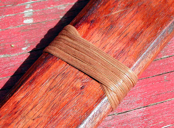

Well, it doesn't match the woven rattan, but a plain wrap beats cotton sash cord any day. I soaked it for about an hour before wrapping, which makes it very pliable. Shrinks up when dry and seems pretty tight and durable. Now I just need to find some narrow rattan, and learn to weave it.
Steve
