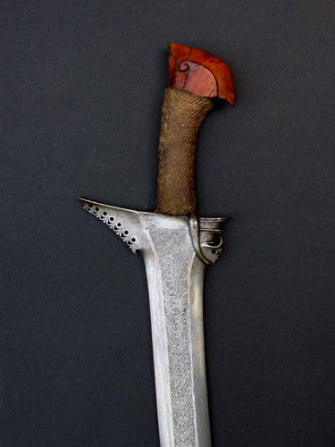

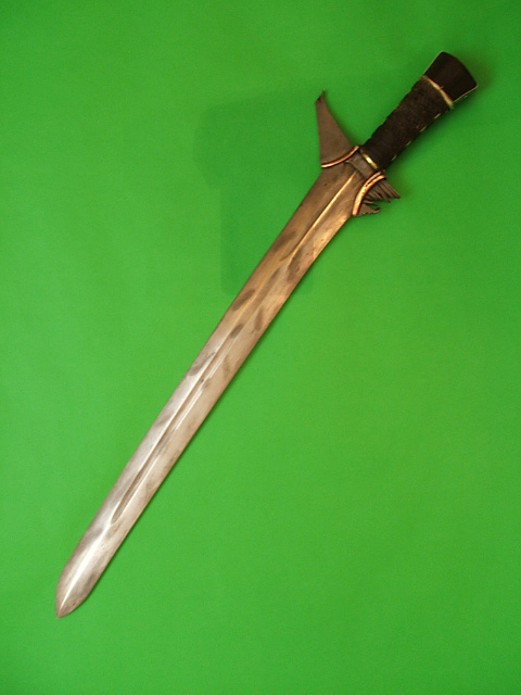

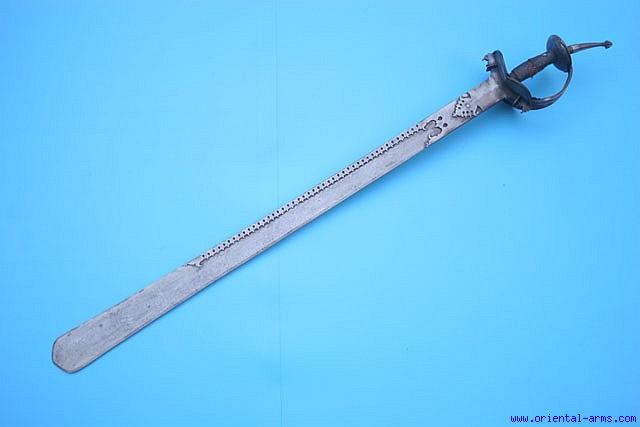

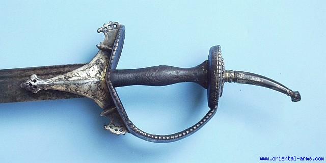

Hi All
I was just pondering if you think there could be any connection between the Southern Indian swords and the Moro kris? Here are a few pics for comparison. Notice the general shape of the blade and there seems to be some type of similar retaining band that anchors the blade to the guard?
Lew

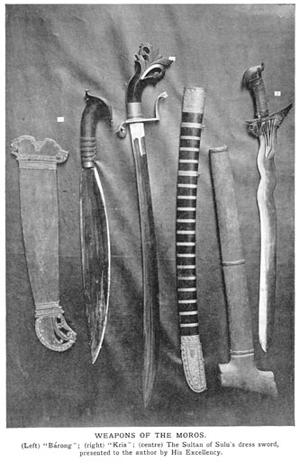

I have not found anything to help with your question. I did find this plate in The Philippine Islands
A Political, Geographical, Ethnographical, Social and Commercial History of the Philippine Archipelago
Embracing the Whole Period of Spanish Rule
With an Account of the Succeeding American Insular Government
By John Foreman, F.R.G.S.
Third Edition, Revised and Enlarged with Maps and Illustrations
London: T. Fisher Unwin
1, Adelphi Terrace.
MCMVI
Its interesting to me because the dress sword of the sultan here looks to have an indonesian flavor. Indian influence was present in Indonesia and could have come to the Philippines through there
I believe Lapu-Lapu (Kaliph Pulaka) was reported to use a Kampilan.
