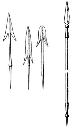

In the book the author mentions that the Agaria's made weapons like arrow heads, three kind of axes where the biggest is described as a battle axe, two kind of spears, one with a steel haft and one with a wooden haft and utility knifes - but he does not mention swords or other kind of weapons at all.
