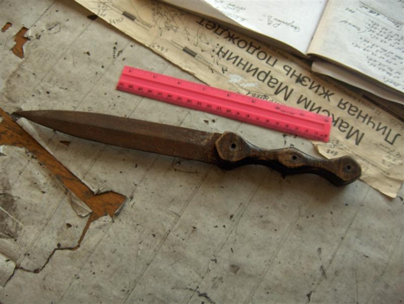

ive seen alot of soviet era swords and knives to aspecialy old soviet era kindjals,,
i recall some chap brang several into the factory made during ww2 and used by dagestani solider during the latter days of ww2 , one was a small kindjal style dagger with a laminated wood handle and a carbon steel blade in a leather leather sheath like a knife. the other was a old folded steel kindjal...... with a textolite phenolic handle :O:O:O:O .. stronger than the old buffalo no doubt..
these things got polished up and sharpened and sent back to the owner ...
hell knows how many times the old kindjal had be rehandled :P
here is a pic of the laminated wood dagger proably made in ww2... sorry i havent a photo of the textolit handled kindjal, or maybe i have but id have to look for it........
