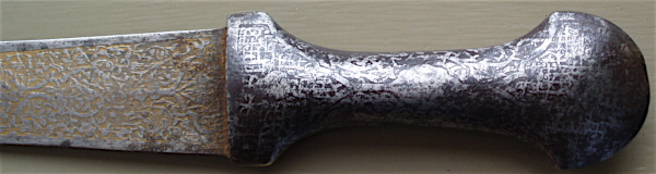

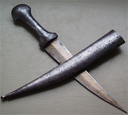

Hi,
Got this recently and am not sure as to exactly what it is, certainly not recent I think. I doubt that it was intended for any serious knifeplay, I don't think blade is thick enough, more for adornment that anything else maybe even old tourist? maybe for a child. A 7 inch blade with what looks like the remains of some gilding, grip is a tad over 3 1/2 inches, hence the thinking made for a child. There are also traces of gilding on the grip and scabbard. As usual all thoughts and comments sought.
Norman.

Nice Persian Jambiya. The blade and fittings are etched with acid in a typical "Late Qajar" style. This is NOT new and NOT a typical tourist item. It is of 19th Century. As for size - yes, it is smaller than usual, but bigger than "child knife". Overall - nice small jambiya.

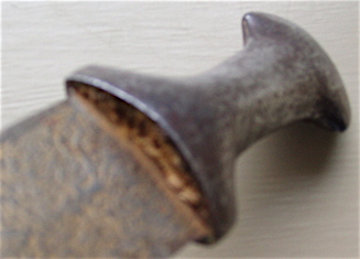

Alex, thanks for your interest. On closer inspection I have noticed that when sheathed the grip is slightly offset from the scabbard and that one side of the scabbard and grip are more worn than the other, good pointers I think to the dagger having been regularly worn.

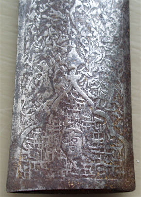

Many thanks for your interest and replies, as you can see there is quite a bit of blackened rust on the grip and scabbard, should I attempt to clean some of this off and if so any suggestions as to a suitable method which would preserve the integrity of the piece or should I leave well alone and accept it as part of the aging process. I suspect there may be a divergence of opinion on this as this predicament surely faces us all at some point in time with various bits and pieces in our collections i.e. to clean or not to clean and when does a tidy up become a restoration?

Norman, when I have an item with similar blackened spots, and especially when I can see some traces of coftgari, I apply a heavy coat of regular oil (like engine oil or WD40) all over it, and keep it soaked in oil for a while. Then I use soft cotton to gently wipe off the oil (no heavy scrubbing though!). The goal is to remove oxidation and dirt deposits to reveal any coftgari which may be "hidden" under. In your case I'd do the same: just put some oil and gently wipe it off using clean parts of soft cotton until you stop seeing dirty marks on it. and this is as far as I'd go, i.e. any further scrubbing and/or cleaning attempts will only make it worse and potentially create more "damage".
