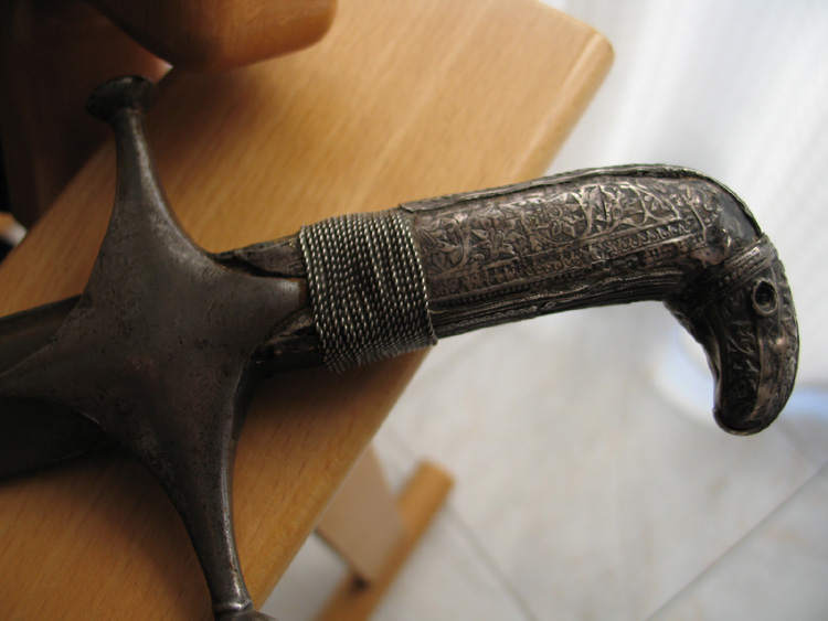

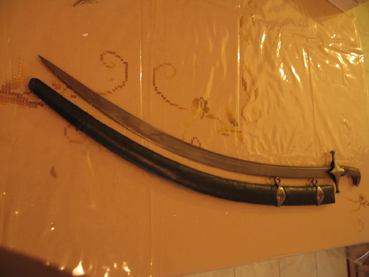

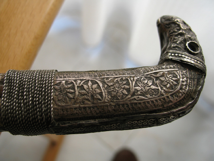

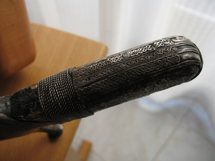

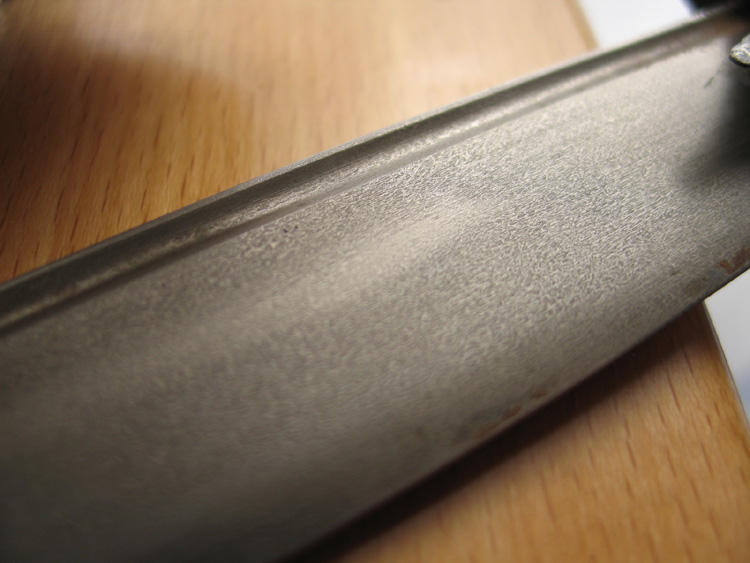

Another arabic sword with a very nice wootz blade. I found it together with the other with the silver scabbard, and maybe they come from the same place. The scabbard is incredibly light, and that gives you the feeling that is a great fighting weapon.

Thank you for posting the pics of this lovely sword. It helps illustrate how "parts" made their way throughout the region. If not for the handle, this could be purely a Persian sword. The scabbard mounts are classical Persian, as is, the crossguard. They have very likely been recycled through and mounted up Arab style. The blade could very well be a Persian one as well. Nice sword!

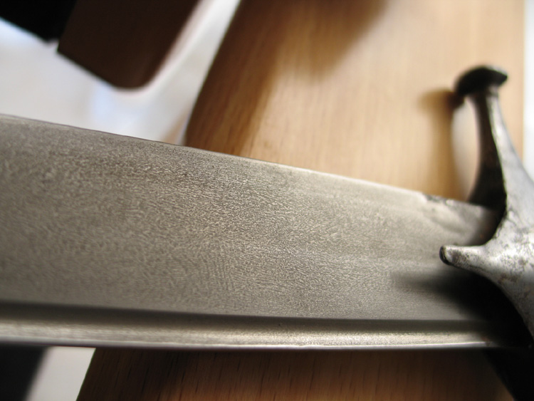

Sweet saber,
I agree with Rick except the wootz looks more "granular" which would suggest an Indian origin. I can't tell is there a ricasso?

I would have to disagree with you Jeff. I think the wootz is of typical syrian 'sham' wootz, but this time with a high contrast. I agree with rick on his points. The scabbard is totally Persian, so is the crossguard too.

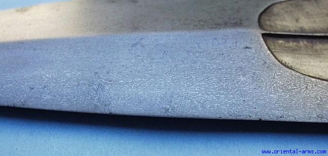

Hi Mike,
Nice to see you here. To me the wootz shows the highly "spheroidized" pattern indicitive of 19th century Indian work. Similar patterns can be seen on 30-31 of Figiel's 'On Damascus Steel'. This isn't the usual "stripy" pattern seen on Syrian wootz. Here is a Katar with the Indian wootz I have mentioned. Other similar pieces can be found at Oriental Arms, as well as sham wootz. It may be Persian as Rick has stated, but they usually avoided "over" working the steel which contributes to this "spheroidization".

The blade really could have originated from any a number of sources. The tight pattern is found on many Indian blades. I have also seen it on a few Persian pieces and also on some Ottoman blades. I agree that the watering is not of the "Shami" form that is often associated with Syrian or Ottoman work. One interesting feature to this Shamshir is the nicely ground fuller just beneath the spine that runs about half way down the blade. On this sword, I would closely at the cross guard and the scabbard mounts because there is a good chance they are wootz as well!
