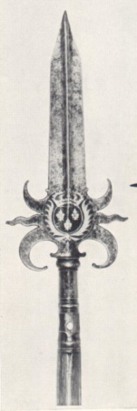

Hello Drzzzzz. Looks like the real thing to me but alas only in decorative condition.It is really out of my field but may be late 17-late18 cent and known as a Partizan.Here are some pictures.Tim

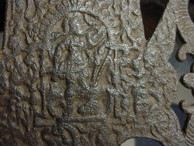

Posts: 1,254
Moving toward a consensus?(I feel sure I spelled that wrong....)? It looks to me like it spent some years underground, or perhaps wrapped or otherwise enclosed in some moisture-wicking material. No one in China listen, but youse might be surprised what a couple weeks wrapped in newspaper gotten wet by a person not me while under her care will do to "age" your nice antiques
Also, though plenty sturdy for day to day handling, and in all reality probably fine and dandy for haybails or even for spearing an occasional animal, cast iron is a relatively brittle substance, and a wooden target might well do this thing in (or at least its tip) in fairly short order. I agree with Conogre though that it's still a fun piece, probably with some good age (pre wwII), and of some interest as a costume, decorator, or even practice blade.

As I wrote it before, we've got something similiar in museum. To be exact - it is almost identical, the same shape, same pattern, but in a bit better condition. I would like to agree with Allan words, quoted by Andrew, but one thing is bothering me: saying Victorian, do we mean English or just European from the 19th century (sometimes called Historical Period) - ANDREW: this would be great if Allan could explain this further . And this is of course partizan - I would even call it spontoon (sponton) which is a type of partizan BTW.
And the photos of museal piece:
Regards!
