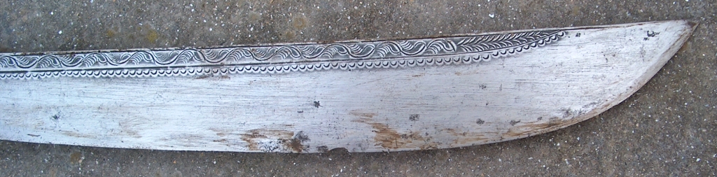

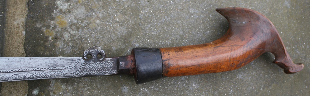

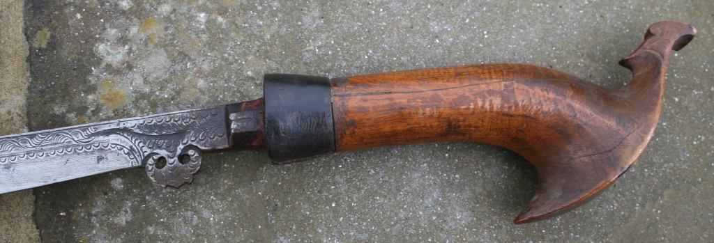

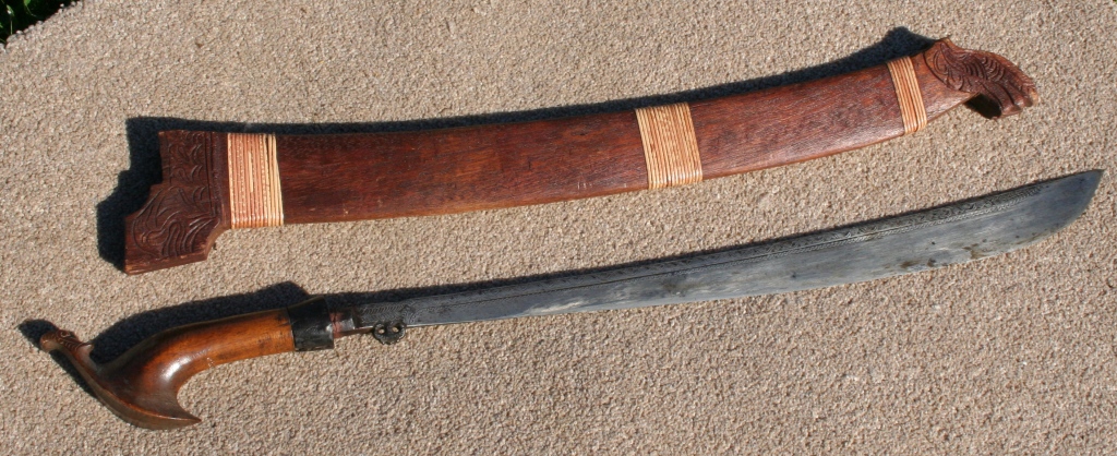

Another oddity from my collection.
This one has puzzled me for a long time and I hope that someone will come up with an explanation as to what it is.
I have never seen this seemingly Barong / Parang Nabor combination before.
The hilt looks real and has some age. The blade looks as though it has been there for a long time, see the photo showing the blade / hilt point of attachement.
I am not convinced that the blade is as old as the hilt.
The scabbard is definitely a lot more recent.
I am looking for an opinion as the whether it is a known weapon, a hybrid or something that someone " Threw" together on a wet Sunday afternoon.
( Do I hear the word Souvenir ? )
As usual, all comments welcome.
Royston

I see what you mean - looks like an Indonesian blade with a form of Yakan barong hilt.
Interesting.
Another possibility is Borneo where there are Moros also and lots of mixing as well......

This is the blade off the langai tingal
Is it possible to take off the Handle ???
Ben

Interesting one of a kind sword.
NW Borneo seems a probable origin based on the different influences.
What is strange is that except Iban/Sea Dayak (Langgai Tinggang blade) and Moro (Barong hilt) it also has (Borneo) Malay motifs on the blade?
So 3 different ethnic groups merged in one sword!
A wild guess would be that it belonged to an Iban Dayak who went on raids together with Moros and then later converted to Islam (which made him change the hilt and add the motifs to his blade)

Thanks Gentlemen, this has given me something to work on.
Ben, the handle is firmly fixed, it would need hard hammer blows to get it off. I think I will leave it as it is.
VVV
Michael, Amazing powers of deduction.
Er, can you tell me what his name was ?
thanks again
Royston

Umm, before or after he converted ??
Seriously though; heating the blade may render it removable from the hilt .

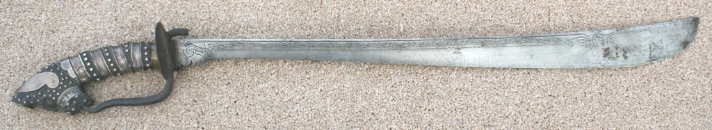

SEVERAL YEARS AGO I BOUGHT A COLLECTION OF VARIOUS PHILIPPINE SWORDS. THERE WAS ONE SWORD REFERED TO AS A GAYONG THAT HAD A MANDAU STYLE HANDLE. YOUR SWORD REMINDS ME OF THE EXAMPLES IN THAT COLLECTION WHICH WAS COLLECTED IN 1944 THRU 1946 IN MINDANAO.
SEARCH IN THE OLD FORUMS UNDER TOPICS , "VANDOO'S MORO PIECES" (GAYONG) IS THE DAYAK LIKE SWORD, POSTED 6-20-2002 BY RICK, UNFORTUNATELY THE PICTURES ON SOME OF THE OTHER ITEMS IN THE COLLECTION ARE GONE BUT THE INFORMATION IS STILL THERE AND THE PICTURES OF THE GAYONG ARE STILL THERE. YOUR SWORD MAY HAVE SIMULAR ORGINS TO THE ONES IN THIS COLLECTION. A VERY NICE SWORD.
AS TO REMOVING THE HANDLE THE ONLY THING THAT COULD BE LEARNED FROM THAT IS IF THE BLADE IS OLDER OR NEWER THAN THE HANDLE. THE BLADE LOOKS VERY CLEAN AND IF THE TANG IS AS CLEAN I WOULD SUSPECT THE BLADE AND FITTINGS WERE MADE AT THE SAME TIME. THE ITEMS IN MY COLLECTION MENTIONED ABOVE DO NOT SHOW MUCH WEAR AND MOST OF THEM NEVER SAW ANY USE AND THE BLADES WERE MADE AT THE SAME TIME AS THE FITTINGS. THE MANDAU HANDLE DOSEN'T SHOW MUCH USE BUT WAS NOT MADE AT THE SAME TIME AS THE BLADE AS FAR AS I CAN TELL. MOST OF THE ITEMS IN THE COLLECTION DUE TO THE PROVENANCE COULD NOT HAVE BEEN MADE ANY LATER THAN 1946 AND WERE PROBABLY MADE A BIT BEFORE THAT, BUT ARE LIKE NEW AS THEY WERE STORED VERY WELL.

Yakan..yes, but not necessarily a Barung, maybe orginally it could have been mounted on a................................

Thanks for posting the Pira Kino. It's good to be reminded about that not everything always has to be "by the book".
I had a look at the old post of Gayong and strange Moro weapons etc.
Is there any possibility to republish those pictures again on the forum, PLEASE?
A Gayang in Sabah is like a mandau/ilang but with a flat blade.
They were also produced on Borneo but not with the kind of blade shape like the one posted in the old thread.
On removing the handle there could of course be a commercial reason as well...
Michael

Langai tingal is an Iban sword so blade is Iban
But to see if it is old need to be the Handle off
If the Handle is off I can see if it is old style or newly made
that s why I ask can the handle off .
Ben

Ben,
I will be back home soon and I will attempt to take the handle off. I'll let you know the outcome.
Royston

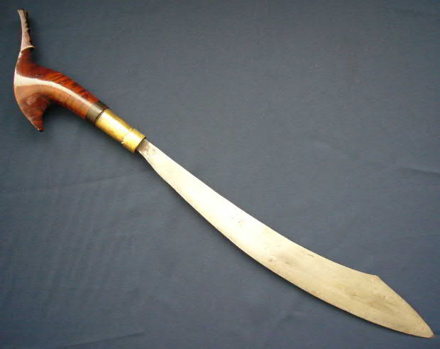

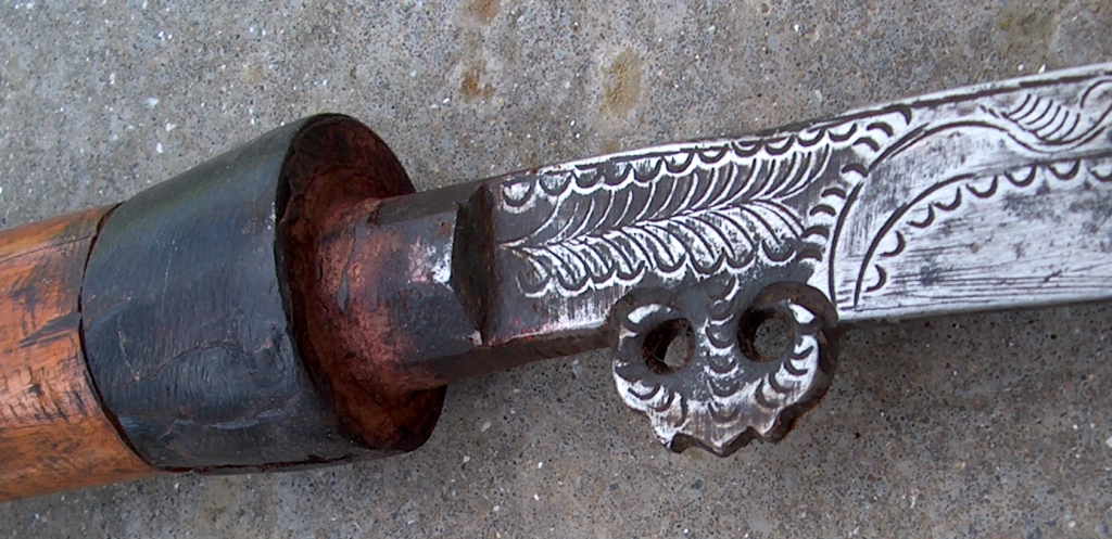

Default NEW PHOTOS AND QUESTION ON THIS ONE
Ben
So far I have had no success getting the hilt off. I tried with a hot air gun on the blade near to the hilt and gentle tapping. Anyone got any better ideas?
I am now getting even more confused with the Borneo swords. The only real difference I can see between the first one that Ben calls a Langgai Tinggal and the Parang Nabur that is shown here is the Krowit.
Is this correct ?
I have looked through several of the old threads on this subject and still cannot differentiate between Langgai Tinggal, Jimpal and Parang Naibor.
Can anyone enlighten me further.
Royston

I have been told that this is Filipino, Batangas.
Nice upper rank piece - best of this I have seen with all that silver...

Here is a good summary of Shelford's classification of Dayak parang based on his research in Sarawak.
http://old.blades.free.fr/swords/day...ayak_intro.htm
There are however some mistakes in the tribe column but otherwise it's good to use for separating the different dayak parang.
The, so called, Parang Nabur sword of Stone's is an error based on a misreading of a description of a (Parang) Nyabor. That's the reason why neither that sword, nor the kampilan (also an error in Stone's as it's not a dayak sword), is among the swords in Shelford's classification.
Yours is from Philippines, not Borneo, as Jose brought up. And a top piece!
Michael
PS If you want more information on this it's all in the forum archives.
