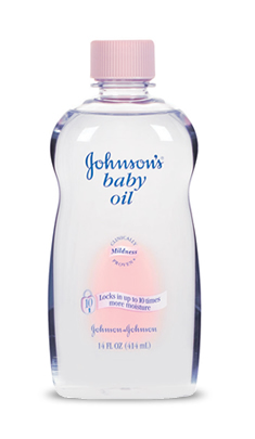

Baby Oil also contain pure mineral oil and some fragrance. A good example is the good old Johnson's Baby Oil. I guess this will also work as well.

Yep, that's what the Wiki people say.
I've also used baby oil as keris oil base.Didn't know it contained liquid parafin until I read the wiki entry. |
