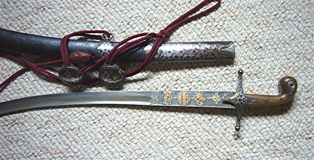

Kilij from private collection, would like to open discussion on any aspect of this sword.
Have been comparing square kufic insciptions on Turkish blades. the Square kufic was used during the time of Muhammad and the Quran was originally written with it. Square kufic is also the only calligraphy ever used to entirely decorate the exterior of buildings.
Every so often there seems to have been a revival of of this type calligraphy used on blades. Some of the inscriptions are phrases from the Quran. Muhammad was the one who started the use of text to decorate weapons and armor for talismanic purposes in the Islamic empire.
If we look at early examples of venerated swords that were cared for with great respect, we see that inlay and encustration of gold was lavish.
The technique that was used for inlay on Turkish blades 16th century and earlier has not been documented yet as far as I know. But it may be the same overlapping triangular punch we have so many later examples of, metalworking traditions do carry on for centuries as long as there is demand for it.
If you know of documented early Turkish inlay techinques I would like that information.
Also am finding very few transaltions of 17th century and earlier Turkish cartouches and inscriptions, if you know of a reference for that let me know.

There might be a dating like 975 (16th c.) on the left cartuche, or the cartuche closest to the blade tip. Am I right?
in arabic 975 = ٩٧٥
Old 10th August 2007, 10:10 AM   #4
erlikhan
erlikhan's Avatar
Location: Istanbul
Posts: 452
Right, the figures look like 975 in Arabic numbers, but in a decorated way.

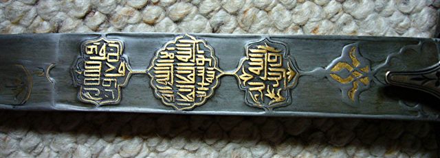

Two more images of sword...

Default Calligraphy
Do you have an opinion as to when the calligraphy was done?
Thanks,
rand

Default Square Kufic Inscriptions
Started this new thread when I realized I had deviated away from Artzi's thread on his kilijs with inscriptions.
This sword has a different style calligraphy, its the same type calligraphy as the Quran was writen in. It is also the only calligraphy ever used to decorate the exterior of building, such as Samarkand.
The calligraphy on this blade apprears to be in the square kufic style.
http://www.sakkal.com/Arab_Calligraphy_Art6.html
Square kufic alphabet
http://www.sakkal.com/instrctn/sq_kufi_alphabet.html
Above are links to examples of Square kufic script.
rand

Default 975
Originally Posted by kronckew
in arabic 975 = ٩٧٥
976- 29 (3%) + 622 = 1568
Don't know what the rest of the inscription says,
don't know if this is date for being made or a reference to something else.
But would like to know, there is a huge gap to fill of translations of Turkish inscriptions, espsecially translated to English.
But all the small clue when added up will help form a better opinion.
Received information this is not a date.....
rand
rand is offline   Reply With Quote
Old 10th August 2007, 08:13 PM   #9
Posts: 7,407
It also looks like you have at least one bismallah (name of God) and a Qur'anic verse.
Masterful work done on this - beautiful!

Old 11th August 2007, 08:34 PM   #11
ham
Posts: 190
Rand,
How did you establish this?
Further:
One thing to take note of is the 16th century swords above have animal skin wrapped over the handle.
This is not invariable. The sword you pictured above with the grip covered in green rayskin, for example, is a late replacement.
Ham
