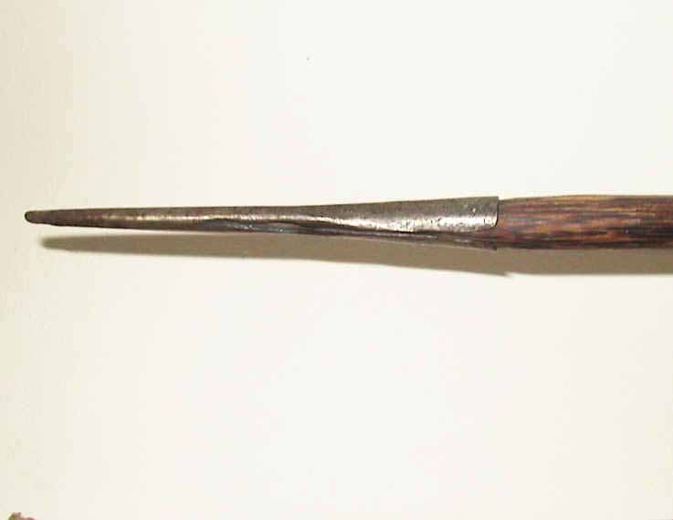

Old 6th July 2007, 02:23 AM   #3
yuanzhumin
yuanzhumin's Avatar
Join Date: Sep 2005
Location: Ex-Taipei, Taiwan, now in Shanghai, China
Posts: 180
Default What about the Philippines ? Why the spike ?
Thanks Tim
I checked on the Internet for Naga spears and found the photo I attached after.
I looked also for Philippines spears and found an illustration coming from a link from this forum. Here is the link :
www.vikingsword.com/rila/k06.jpg
I can find photos of spears heads but not many photos of the other end of the spears, in order to check if a spike is common or not in the Philippines spears, for example.
Does someone has an answer or photos to show me ?
Another question :
What's the purpose of this spike/nail-shaped point ?
I've been told it is made to help stick the spear in the ground and protect the holder against a charging wild pig.
Nicolas

Old 6th July 2007, 02:49 AM   #4
Posts: 6,436
Smile If The Spear Breaks ...
Or not; you have a counterweight; and if it does break you have another sharp end to use.
Old 6th July 2007, 06:32 PM   #5
Posts: 7,406
From older research at the turn of the 20th century Philippine Igorot tribal spears had the pointed end so that it would be easier for mountain climbing and when resting they would plant the spear in the ground with that spiked end down. Most Moro spears were actually lances and did not have this feature.

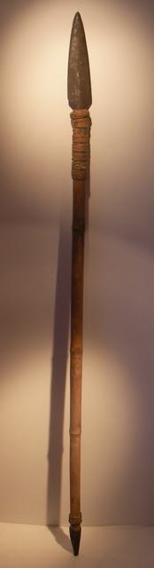

Old 7th July 2007, 02:31 AM   #7
Posts: 6,436
True that; the second picture is from a Mandaya 8 footer.
The cast one would make a nasty little club.

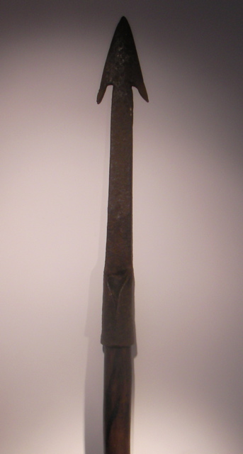

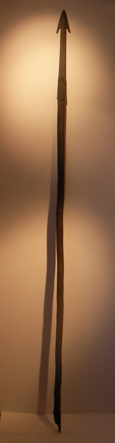

Old 13th July 2007, 02:21 AM   #10
yuanzhumin
yuanzhumin's Avatar
Join Date: Sep 2005
Posts: 180
Thanks for the infos.
Here are the three Taiwan spears that just entered my collection.
In this same post, the first one is Atayal, the second is Paiwan. In the second post, it is also a Paiwan one.
Similarities with the Philippines spears, from Luzon mostly, seems to be very strong.
Nicolas

Old 13th July 2007, 02:24 AM   #11
yuanzhumin
yuanzhumin's Avatar
Join Date: Sep 2005
Posts: 180
The third spear, a Paiwan one.
yuanzhumin is offline   Reply With Quote
Old 13th July 2007, 02:28 AM   #12
yuanzhumin
yuanzhumin's Avatar
Join Date: Sep 2005
Posts: 180
I don't know why but the images were mixed up in the first post.
So in that post, the Paiwan spear comes first, and the Atayal one is following.
