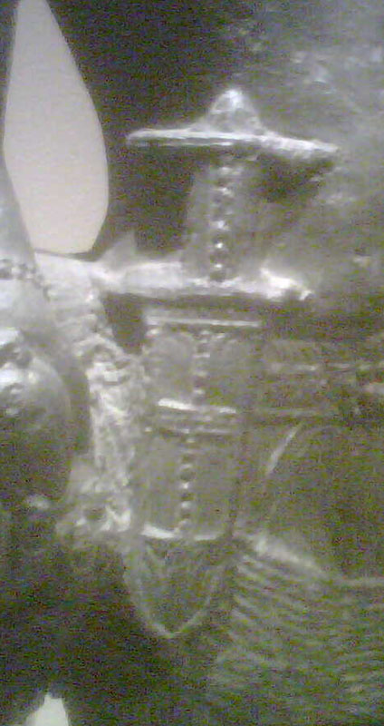

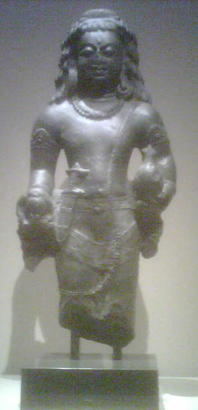

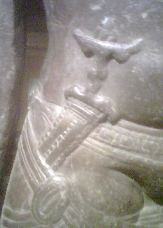

This find was very exciting, because it shows a dagger almost exactly like those found in Pyu sites in Burma (third & fourth photos). The Pyu were a Tibeto-Burman people related to the Bama, but preceding them in Burma by several centuries. The statue is identified as being possibly of Shiva, from Bihar in India (which is in the northeast of the country), and from the Gupta Period, 6th century.
The fifth photo is a detail of another statue of Shiva, but from Kashmir and a later period (end ot the 8th century). In it we see a more typical bichwa or chilanum.
While it is unwise to read too much into a single sample, I'm intrigued by this Bihar knife that so closely resembles the Pyu dagger. Is the 6th century Bihar knife the forerunner of the Pyu dagger? Or is it rather the precoursor to the one shown in the Kashmiri statue? Or both?

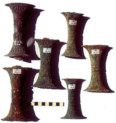

Are the pictures from Bob Hudson of the handles from Pyu sites predating Bagan or from his Bagan excavations ? I did have some .pdf files of his work but currently can't find them .

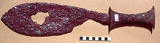

As I recall (its been a few years), they are from Elizabeth Moore's excavations at Halin. I know that the first couple times I posted about them I described them as being from Bagan, because Bob Hudson sent them to me, but I'm pretty sure they are from Halin. I might be able to go back to my e-mails and check that.
By the way, I did not post a second photo showing the backs of the handles, where it is seen that they are formed by wrapping a sheet of bronze rather than being cast. You can clearly see the seem where the ends join.

I've confirmed from my notes that the rusty dagger with the bronze handle is from Halin, a Pyu/Mon site.

Halin or Halingyi was a 7th - 9th century Pyu site which was thought to be that sacked by Nan Zhao in the 9th century . Speculation is that it may have been the same or related to Tagaung from whence the Pagan kings claim their lineage .
The Mon at the time were thought to be based much further south at Pegu and Thaton although archaelogical evidence does not support this . ( current evidence only supports Mon sites from 11th century supporting the theory that the Mon shifted their polities from the Chao Phraya basin west to present day Lower Burma and Tenasserim only after the fall of Dvaravati to the Khmer in the 11th century .
This is completely out of step with the Mon and Bama received and accepted thinking ( based on chronicles written much later ) that the Mon brought "civilisation" to Bagan after the sacking of Thaton in 1057 and that Thaton and Pegu were already established in the 6th - 7th centuries : hence the much controversial Mon paradigm .
So the handles shown are contemporary to the Gupta and Kashir ones shown showing much Indic influence . ( the assumption is that only in the classical periods of Bagan and Angkor did SE Asians move away and develop indigenous variations on Indic culture whereas prior to this the cultural influence was more pronounced )

I thought it a little odd that my notes termed Halin a "Pyu/Mon" site, but they did. It must have been something Bob mentioned, or my misunderstanding of its location as being further south than it is.

As far as I'm aware there has always been a distinction between the paraphenalia of the elite , which were more likely to emulate Indic models , and that of the general population . I wonder if it's possible that these decorated handles were the exclusive possessions the nobility.
