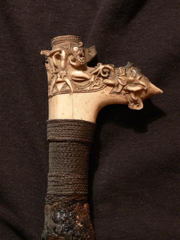

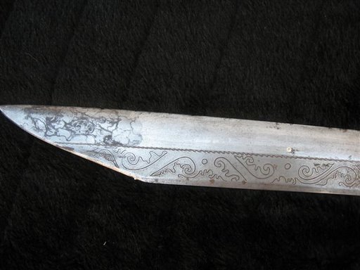

Greetings to you all,I am new here and am here because of a member of another forum suggested I may find here of interest.I am researching a sword for a friend,a sword which I know came from descendants of Boer,Paul Kruger,a soldier in the first Boer war and later the President of the Transvaal in 1880.We have been lead to believe the sword is not African in origin,but comes from The far east.We are interested in knowing more about it,what it is and where it comes from.An interesting point would be how it became to be part of Paul Kruger's belongings and was it used by him,but I suppose that is open to speculation
The sword is convex on one side and slightly concave on the other side and has one cutting edge only,it is heavily rusted due to having been stored damp in a cellar.There is also engraving down both sides of the blade and chiselled ornamentation to the dull edge near the blade tip and brass flush stud ornamentation down one side only.
The handle appears to have stylised dragon creatures carved possibly out of ivory.
The Scabbard is a wooden clamshell design where the blade will only fit it one way.The scabbard also contains a thin turned stick with a blade on the end.The mounting runs vertically down the scabbard,with a brass or bronze S- hook on the lower end(back mounted sword?)
My friend also wishes to know how this blade may be cleaned up,so as to not damage any of the engraved blade ornamentation,which appears to be engraved by a punch.
Something else that would interest us,is the handle,there are two hollows,one in the top and one at the side,suggesting something may have been in these hollows/holes,from weapons of the area and time,what is likely to have been there?

What you are showing is a Mandau from Borneo Kalimantan. Used by the Dayak or Iban. Main purpose of this sword is to take heads in battle.

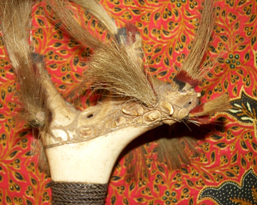

The holes in the handle are for tufts of goat hair.
Unfortunately a large part of the bindings of the hilt are gone and the hilt has a nasty crack. But the blade is very nice with engraving and inlay.
Cleaning the blade from rust, use lime or lemon juice. Rub with a slice of lemon over the blade. When the rust is gone clean with water and polish the blade quick with soda on a wet toothbrush. Dry the blade well and oil it.

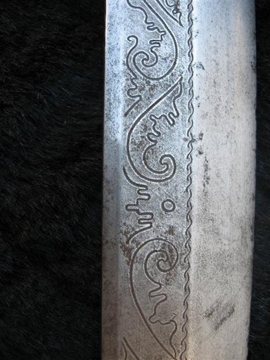

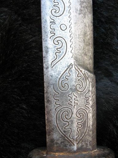

Hi,
I have a mandau with almost the same decoration in the blade as you have.
(I don't mean the brass or copper inlays).
I enclose some pics.
According a respected collector my mandau comes from Borneo in the area at the border of Sarawak / West Kalimantan.
But I have to say, I don't know if the same decoration of our blades, means the same area of our mandaus.
But maybe someone else can give an answer at this question.

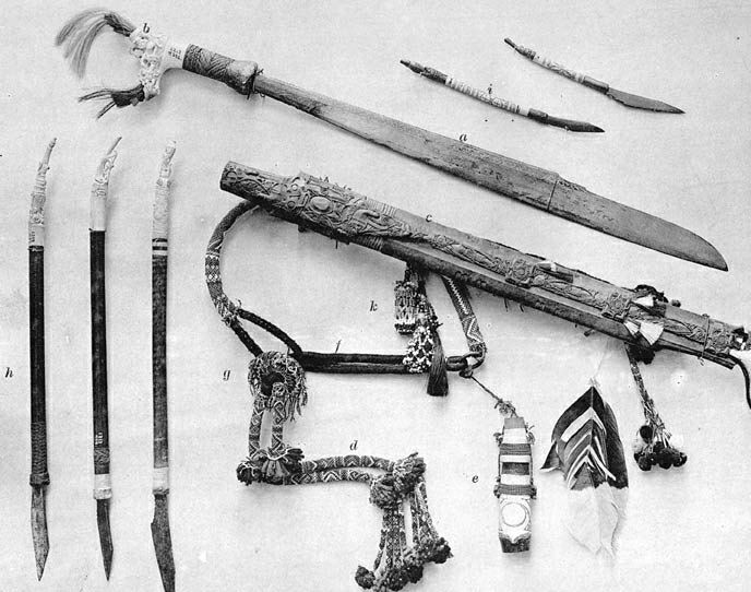

Default Niewenhuis Mendalam mandau
Found it !
the Mendalam mandau from Quer Durch Borneo.
Sad enough it does not have a close up of the handle.

Originally Posted by asomotif
Found it !
Its good possible that its a Mendalam type, however it doesn't have the typical "gear wheel" ( see my own example) carving on the handle.That wheel is found on many Mendalam hilts carved around 1900 when Nieuwenhuis visited Borneo.
I think also that Krugers sword dates from this time seen to the carving.
I also know that Kruger retired in The Netherlands ( and died in Switzerland)
he was visting The Hague in 1900.So its also possible that he got the sword here in the Netherlands probaly as a gift. It was use that times to make some show wich the rich treasures of " our colonies".
