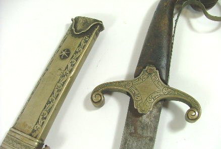

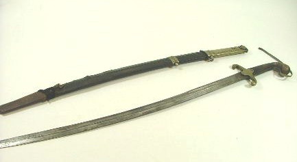

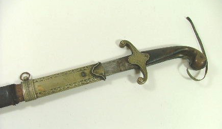

newly arrived purchase. leather scabbard, horn handle, the brass cover on the handle is loose but solder would fix that. no distinctive marks on sword. blade has one full blood groove, and one above which is about 4 inches long, but the blade does not look like it has been sharpened down to loose size, the second blood groove starts by fuller and ends 6 inches from fuller. blade has to be cleaned properly to see what kind it is. any ideas on origin? ukranian but no crests, islamic possibly?, or is it turkish/ottoman?

It is unquestionably Turkish, second half of the 19th century, military. That's when the Turks decided to model their military after the European, in particular German example. Moltke, a young officer then, was put in charge.
The swords were modeled after the traditional Kilic Adjemi, that was uncannily similar to the European Mameluke swords ( surprise, surprise...). Initially, they had handmade blades, but toward the end of the century, there were more and more light, nickel-plated ones. the wire-stitching of the scabbards disappeared. The cross-guard with down-turned quillons is typical of the era.

Thanks Ariel, thats the answer I was hoping for hehe. I had seen pictures with officers from Turkey from the 19th century, and the downward facing quillions was the main reason this sword gave itself away as turkish. were these swords ever made with wootz, damascus blades? this one really doesnt have the nickel plated characteristics and look, and the way it has discoloured and pitted.

mavi1970,these were mass produced in the 2nd half of the 19th c. in Turkey. You can find better or worse quality samples (compared by the materials used, like ordinary horn or rhino grip, nicely worked silver or just white metal mountings etc.). You can find a lot of white metal mountings as spare part in antique shops. So we can get clue that they were produced in large numbers, not by private orders but state contract. However, some officers later personally ordered masters gold or silver koftgari decorations perhaps, as some blades have such inscriptions.

Well, not as many as Ottoman ordinary officer swords but to find one is not difficult for sure. And, they dont have only star. They always have both crescent and the star, 8 or 5 pointed, depending upon the period. Yours has star only. The crescent has fallen perhaps?? (They do often).
