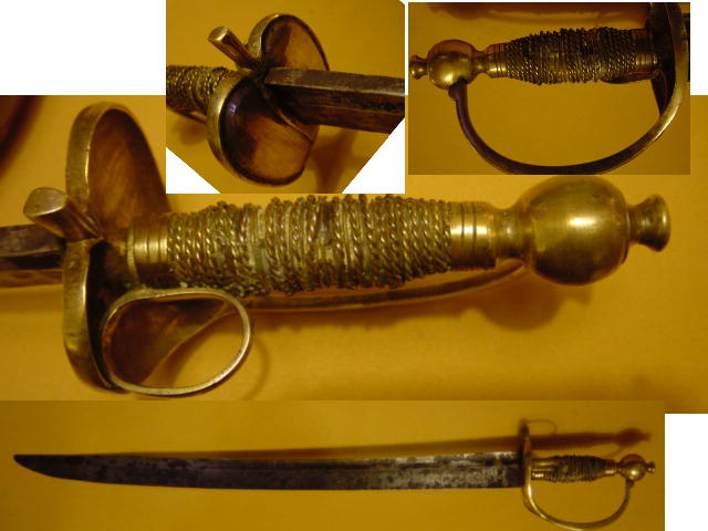

Old 17th January 2005, 11:28 PM   #3
Hi Jim
So glad to have your wellcoming expressed, and much obliged for your teachings on the hanger, from which i will try and insert here the pictures.
From the very little i knew until now, this seems to be a short specimen, only with a 22" blade. Also the thumb ring is not a much seen variety ?! I wonder whether this solution of the ring functions as a thumb protection or a grip holding support ...
There are markings on the guard reverse, but they are frankly fainted, as not well punctioned at origin.
As the blade had some pitting, the guard and grip were very dirty and the brass wiring was much fragilized ( flea market piece ) , i gave the all sword one of these non skilled cleanings that, together with the dirt, rubbed off the brass patina ... my ignorance.
Thanks again for the enthusiastic support
Old 18th January 2005, 02:46 AM   #4
Posts: 10,872
Now the thumbring really adds new dimension!! That was definitely not on British swords...but does appear on German hangers of the same period.
(Neumann p.76, 44.S). However, the German hanger illustrated has certain different characteristics such as a solid cast brass hilt with spiral fluting, the globular pommel is similar but the ferrule is different and the capstan is more flattened....also, the thumbring is integral to the guard.
Your example has more British characteristics especially the wire grip wrap, the capstan, but most distinctively interesting is that the thumbring seems added, although possibly contemporary to working life. It would seem that the thumbring was a feature used on latter 17th century Northern European swords, presumably for better control ( seen on Swedish cavalry swords c.1680, but the feature reached Austrian as well as German swords through the 18th c.). It is interesting to note that the characteristic heart shaped guard seems to have evolved to the British models from these European examples.
It should be noted that during the Revolutionary War, at least 30,000 German mercenaries came to America carrying what is described as a motley array of European weapons from late 17th to early 18th century, including the German thumbring hangers. While only hopeful speculation, especially as armourers were especially scarce in the colonies, the added thumbring could plausibly have been at request of owner.....but this would be most surprising as this feature was all but abandoned by this time of the 18th c.
Still a good chance that this was from other of the European countries with the thumbring mounted in this manner, lots of further checking to do to rule out the 'added on' idea.
Most interesting and attractive sabre though!! don't worry about the cleaning, it still looks great!! outstanding heavy blade, and I always liked the thumbrings (sort of a vestige of early chivalry).

Old 24th February 2005, 08:51 PM   #6
Amazing thing !
I have ordered " Swords and Blades of the American Revolution" from an U.S.A. site and what i received was "Colecctors Illustrated Encyclopedia of the American Revolution" by G.C.Neumann and Frank J. Kravic. Page and image numbers do not coincide with Jim's quotations on the earlier Neumann's book, as this one probably with more material ( 286 pages size A4 ).
In any case, in this page 253, image 10 shows a specimen with the whole lay out in the same manner as my discussed hanger ... wired grip, pommel, capstan, guard, quilon ... although assumedly from a different provenance ... little diffirences in shape and dimension of details. Curiously the thumb ring is also an assembled one, looking to be just the same model, but mounted on the opposite side ... as such must have belonged to a left hander, which confirms Jim's aproach that this was an "optional" to be ordered.
I have meanhwile consulted some sites on Danish hangers, and currently i only find tracks on the version with the spiral brass grip and so. Such model has lasted over there for several decades, and a local (sub) version developed was the trimming of the heart shaped hilt, to make it slimmer for waist suspension ( sorry for bizarre lexicon ).

Old 26th February 2005, 12:42 AM   #7
Posts: 10,872
Hi Fernando,
Thank you so much for the update! It is much appreciated and thank you for providing support for my theory. It is always rewarding to see ones observations strengthened in plausibility
The book you obtained, I wonder if it may be a revised or updated version of the original by Neumann which I noted? Can you provide ISBN # and more on the title etc. ?
Again, very nice sword!
