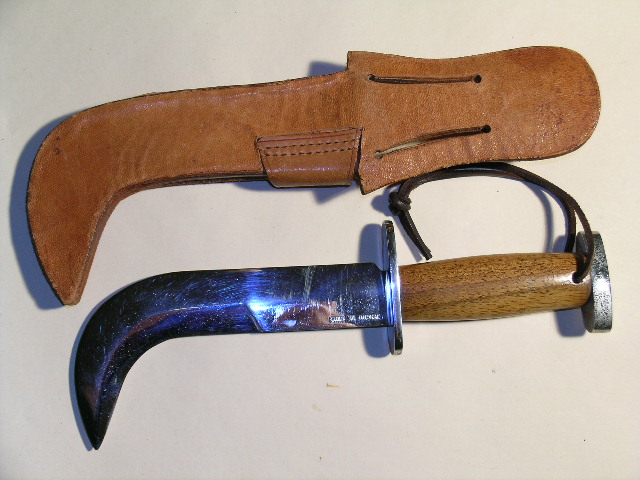

I found this small, Keris resembling, blade so I bought it to find out what it could be. According to the seller it was found close to Palembang but he didn't know what it is. It's quite small - 26 cm/around 10 inch overall.
The hilt is horn.
Do you know what it is?

I've seen curved keris before. Rather unusual, I think. A friend of my owns one with luk and I've seen by a fellow collector a straight one. Both of these keris where curved like a Jambiya. Yours is only curved at the end of the blade. Very nice find and if I rembered well the region where these keris came from was arround Palembang indeed. The sheath is a scandinavian one I think. More Puukko like. The sheath for both keris I've seen was a curved walikat sandang.

I think you are correct that the sheath isn't original after having a closer look at it. I am not so much into either Scandinavian Sami knives or Finnish Puukko (the grass is always greener...) but don't they usually have thicker leather for their sheaths?
My only reference on that is the ones being sold in the souvenir shops in Stockholm's Old Town.

The hilt is not rhino it's most likely some type of buffalo horn. The dagger reminds me of the Beja daggers of Africa.

Alan, thanks for the comments on puuko sheaths. Does it seem likely to you that this sheath was originally intended for one?
Also, what do you think this blade is? It is definitely keris like, but i have neveer seen one like it before.
Old 2nd October 2006, 05:28 AM   #12
Posts: 7,229
No, sorry, that sheath does not look even the tiniest bit like any puuko sheath that I have ever seen. Shape is 100% different, construction is different. To me this sheath just looks like something that was sewn together in Europe to cover the blade.
As for the knife itself, I`d sooner not comment.
It is not a keris, I can say that much, but what it might be, I do not know.

I've found this knife at
http://www.collecteez.com/
with the following comment:
CORVO KNIFE
Chile , 1971, made by Famas - a governmental manufacturer, overall length (up to the center of the arch) 12" (31cm).
The Corvo is a unique dagger/knife which represents a national symbol in Chile . In its shape it imitates the work-tool of mine workers, and also the claws of the Andes' bear. There are two basic kinds of Corvo, one that which very bent and one which is less. The very bent kind is bent in almost 90° and is issued for the commando forces. A regular commando Corvo is black and has a plastic handle with plain leather sheath.
It looks like the above posted "keris", especially the scabbard.
Sommelier is offline   Reply With Quote

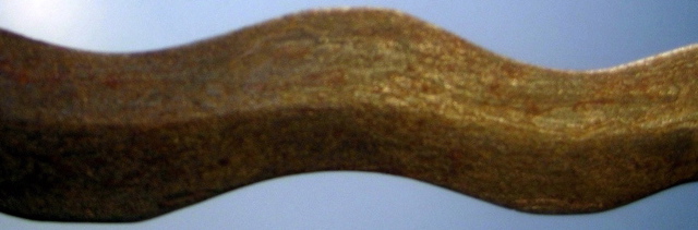

Corvos never have pamor; could we see a well lit photo of the subject blade's pamor ?
