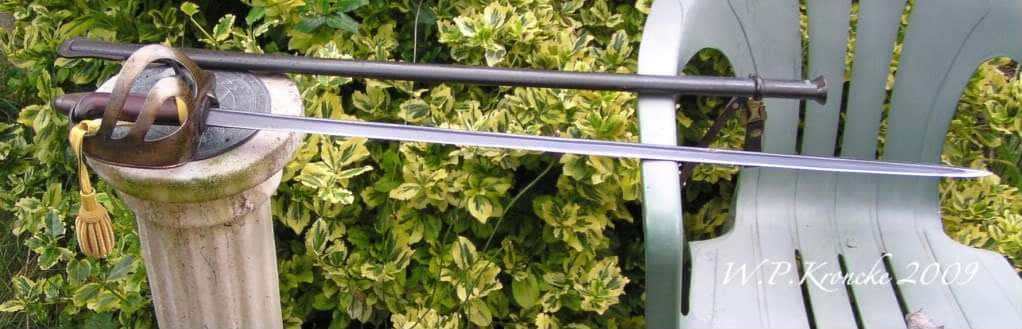

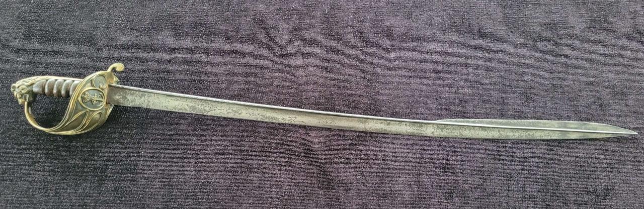

Italians also made sabre with pipe backs.
My 1871 Italian Mounted Artillery Officer's sword (top)
UK Army and Navy in the early 19c tied pipe backs, the navy feathered tip version didn't last long. The cavalry version was found to be too flexible when trying to thrust into opposing Russian cavalry in the Crimean war 1853-1856.
UK 1827 Pipe backed, feathered tip. (Bottom)
