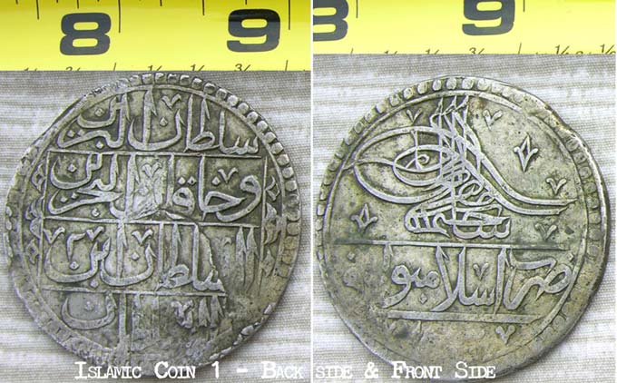

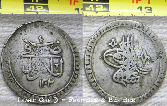

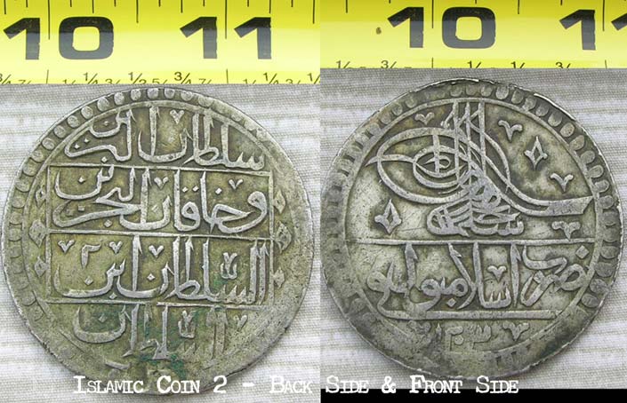

As those of you who read my previous post I just returned home from a trip in my native Romania. Normally you would find me bringing back some old blades or folk or antique art but this short and other purposes oriented time I was lucky enough still to get were a few old and very atractive coins, a freebie gift from my older brother, who got them for me at a flea market in Transylvania from an old woman. Strangely enough, three of them, splendid specimens I must say, are Islamic. I would strictly snobishly pose to say I know anything sure about them but I must admit I am dying to know what they are, even with the omnipresent risk of a treasure hunter disapointment. Coin # 1 and coin # 2 seem to be perfectly the same while the # 3 is almost like a religious medal with an inscriptio resembling a ,,tughra,, on both sides.
My best guess is that they are Ottoman ( the Tugra and the caligraphy seems Turkish to me) and they seem to be between one and two hundred years old. In reality vs. photo the patina is much more proeminent (an older look) as I enhanced them a bit so it would be an easiear ,,lecture,,.

Well radu, I have no clue about the inscriptions, but if I am not mistaken the tugra on all three coins belongs to Sultan Selim III (1789-1807), and the date on all three of them is 1203 or 1789. This is al I can help, and, oh yes, those would look great on a kindjal or khanjat hilt (you can still own them that way)

TVV is correct that it is Ottoman year 1789. The first and second is identical. All i can read is the word As-Sultan... (?) in the first row and third row of both coins. "Wa Hakkanul Bahrain" (Im not sure about this) in the second row. The fourth row reads "Islambul" and the fifth reads year 1203. The front side i can only read "Islambul" on the second line and 1203 on the third. The first is complex caligraphy.
The first line on the third coin i'm unable to determine but the second line reads As-Sultan. This link might be helpful:
http://www.rustypennies.com/catalog/turkish_coins.html

Dear son of Vlad, I think coins 1 and 2 are SILVER YUZLUK (1789-1808) . See http://www.joelscoins.com/mideast.htm
I still looking for coin 3

Enigma was eluded, thank you Yannis, great job, Rasdan and TVV, you put me on right track, Turkish silver coinage from late 18th century, from the times of Sultan Selim III, Islamic years AH.1203-22, Christian years AD.1789-1807. Very interesting, even though alltogether from an investment value they are worth very little, more or less around $ USD 90:
PIECES # 1 & 2 are silver Ottoman [I]"yüzlük" [/I] or 100 piasters coins FRONT: inscription reads: Sültanül berreyni ve hakanül bahreini essultan bin essultan, 9 that translates: ,,Sultan of the two continents and Qaghan of the two seas, the Sultan, son of a Sultan, in the 9th year of reign" verso : the [I]tughra[/] (caligraphic signature of a Turkish rulling class) of Sultan Selim III and inscription: duribe fi Islambol 1203 translates as: minted in (?) Istanbul 1789 (coresponding to the Islamic year 1203) .
PIECE # 3 is an Ottoman ikilik or [B]çifte kurush[B], a silver two piasters coin valueing 100 para. Back side : the tughra of Sultan Selim III . Front side: inscription reads: duribe fi Islambol 1203, 9 and translates from Turkish as : minted in Istanbul (?) 1789, in the 9th year of reign.

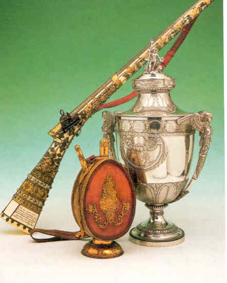

He was first to consider European models as it was the great era of Napoleon and admiral Nelson which whom he fought unsucesfully during his reign. He was strangely enough born on Christmas day, 24th Dec 1761 and died in July 1808. The two picture are his portrait and on right is one of his muskets and flask , the cup is an English trophy part of owner`s collection not related.

Radu, great idea to show some Islamic coins! The attribution is right, except the date of minting. Coin 1 and 2 are minted in the second year of Selim’s reign, coin 3 in the forth year. You find the year on coin 1 and 2 in the 3rd row, left and on coin 3 on top of the front side (by the way, it is normally treated as the back side and the site with the Tughra as the front.) The Tughra reads: “Selim han bin Mustrafa elmuzafferü daima” – Selim, Lord, son of Mustafa the Ever Victorious.
