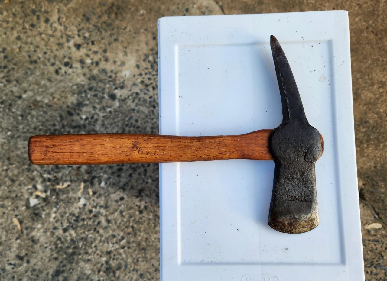

Default Native American spike tomahawk, fur trade pole axes and skinning knives

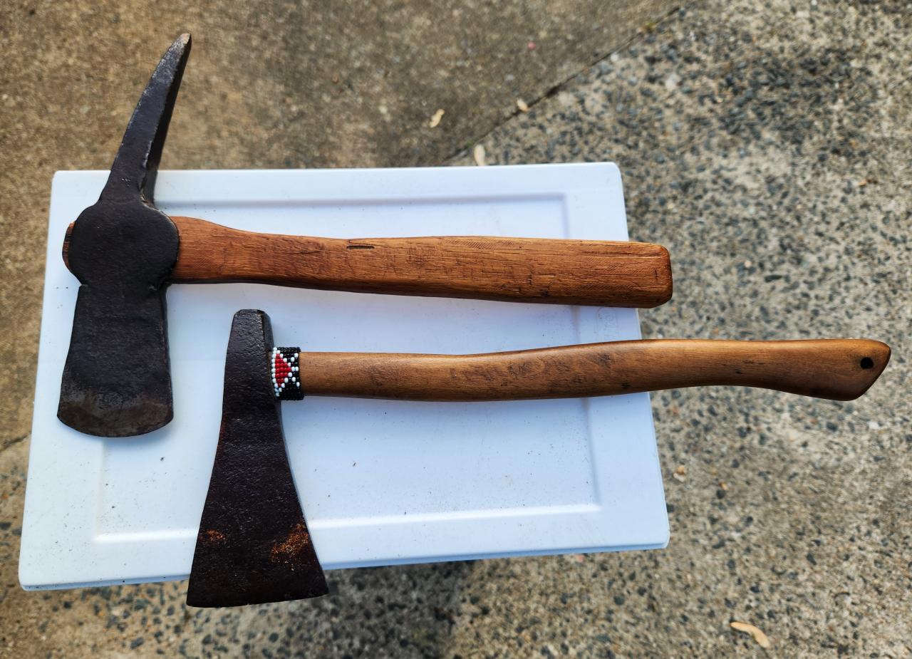

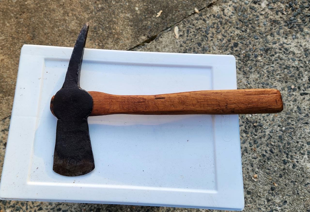

Although my primary collecting has always been maritime, I became fascinated with spike tomahawks when I learned that they were contemporary 'cousins' of the boarding ax. Here is one I just picked up recently and it may surprise some that they were not all huge beasties! This rather petite example is actually more the classic size, with an 11" haft, head measures approx 10" with the cutting edge at 1 1/4" inch. This cast steel head probably dates ca. 1825-50. I believe the wood haft is contemporary to the piece.
Some of the amazing facts about spike tomahawks; they predate the later (and more recognized pipe tomahawks), they were first introduced in the early 18th century and continued to be traded all the way up to the Indian Wars of the 1880's, most of the early ones were iron with steel bit inserts for the edge and sometimes the tip, they were primarily used as weapons but could also be used as tools to skin game, puncture leather, cut bark into strips, etc. Later steel examples were made by trip hammer forgings as early as 1800. Tool companies actually made these in catalogs and sold them to the Indians! The Underhill Tool Company made a 'hawk that often ended up in native hands. After later troubles and the Little Big Horn, the government looked down on the tool companies making these for 'the enemy' and discouraged it. The companies were too greedy to stop the trade and simply kept making them, but without their company logo!!

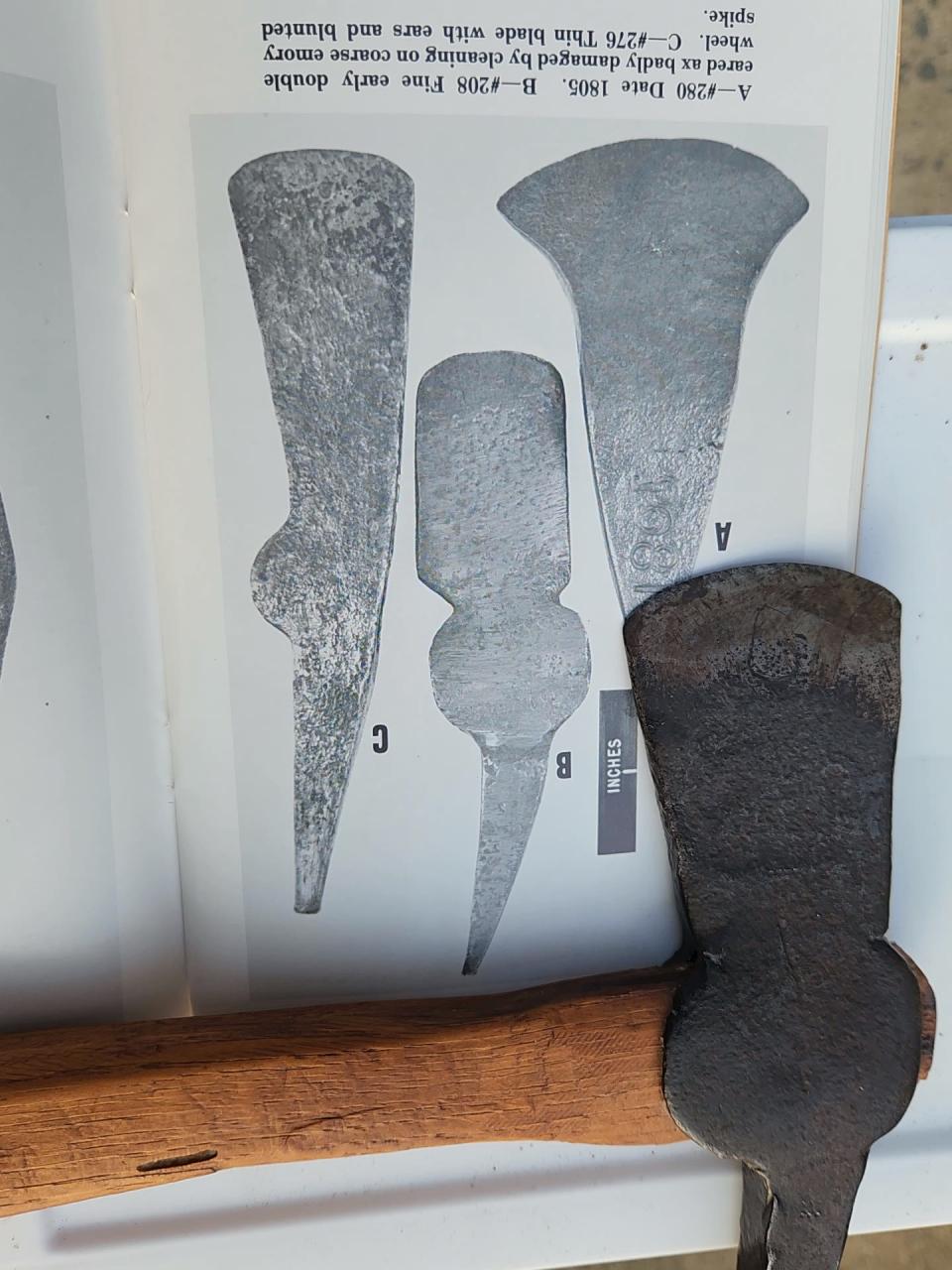

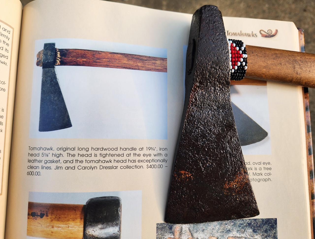

Here are similar examples from the trade tomahawk page and also museum examples.

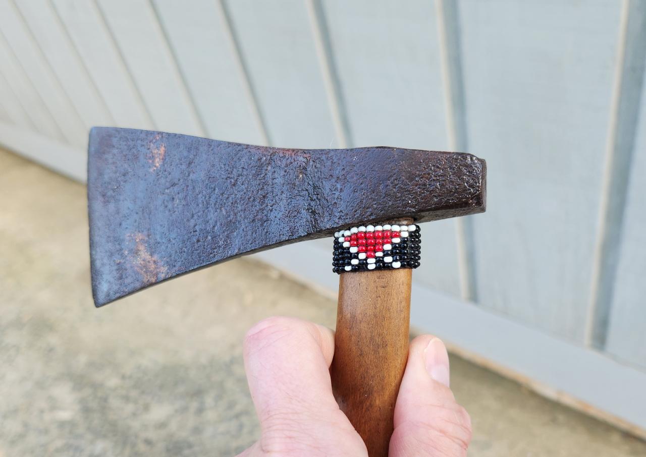

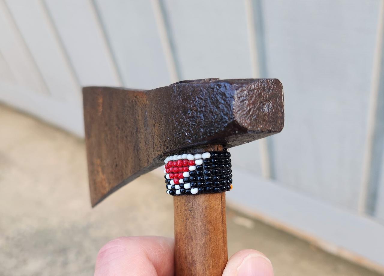

Of course spike tomahawks were not exclusive to Native American use. Fur trappers, colonial soldiers, 'mountain men', scouts, etc, also used such pieces. During the French and Indian War, there were several Scottish regiments that rejected the Brown Bess bayonet in favor of a tomahawk ax as sidearm. Here are two more spike 'skull hammers' from my collection. Both are early, possibly pre-1800 based on their styling/iron forging and have their original hafts. The smaller of the two has a steel bit and a steel spike forged into the iron. The larger specimen has an 'eared' base, lozenge shaped eye and an old blacksmith repair where a lug secures the head where it cracked through the eye.
Understanding the culture from which these axes emerged is truly amazing. During the trade years, a white blacksmith would often in good faith take a native wife in order to bond with the tribe that he was supplying trade items. Often, the smith would set up shop right on the perimeter of that particular tribe's land. This practice of taking a native wife was most popular with the French fur trappers, but many of the Hudson's Bay Company Brits did it as well.
Some will note the 'nail pulling slot' and call foul. Tomahawks never have nail slots like lathing axes, shingle hatchets, etc. The exception to this rule, however, is when they were drilled and cut later in the axe's life. These tools were often used for a century or more! Also, if the 'slot' is more square-shaped, they were often not for nail pulling, but were a trap chain pulling slot. Imagine sticking your arm down into icy water all day long to haul out a trapped beaver! The ax slot served as an extension of the arm to pull the trap from the chill river.

The fascinating thing about these axes is that they truly 'walked the path' between two separate worlds. Made by Europeans, but sold to and used by Native Americans, they are both Ethno and non-Ethno pieces! Although a gruesome weapon in a fight, they were as essential as side knives for these warriors.
Here is another from my collection. This early piece might in truth be only a tool as it is very stocky and heavy (most, but not all spike tomahawk heads weigh less that a few pounds at most while this one might tip the scale!). Early iron spike ax with forging flaws and nice patina. Haft is probably modern replacement.

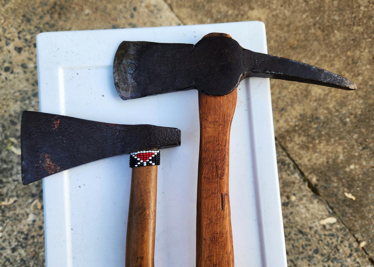

Hammer pole axes were another popular ax of this era (18th-19th c.), but with very rare exception, were not used by the native peoples. These types were carried by soldiers, fur traders, explorers, etc. Some were mostly for tool use first, but also as a weapon in a pinch. Here are two early examples. The smaller piece is a true tool ax from around the time of the American Revolution. The 'hammer' end was indeed used for driving in nails/pegs. Note the nail pulling slot is a much later addition to this ax, which was drilled out and cut to form the slot.
Compare the smaller ax to the larger example and you will not the huge hammer end to the head. This end was NOT used as a tool, but served as a counter weight to give heft to the ax. This second example is a type known as a 'rifleman's belt ax', Second Pattern as identified by Hartzler's book and Neumann's 'Swords and Blades of the American Revolution'. If you didn't know what you were looking at, most would swear this is just a common shingling tool. This is why collecting these types can be tricky. Spike axes of old influenced the trench axes and fire axes and boy scout axes later!! Likewise, these hammer pole axe/tomahawks certainly morphed into the patterns of later tool axes. This ax is both tool and weapon and does deserve the title of 'tomahawk'. It should be noted that hammer pole tomahawks were issued to Sam Houston's 'Texican Army' and were used to graphic and bloody effect against Santa Anna's army after the Alamo. Likewise, Davie Crochet himself carried a presentation hammer pole tomahawk presented to him by friends in the 1820's.
