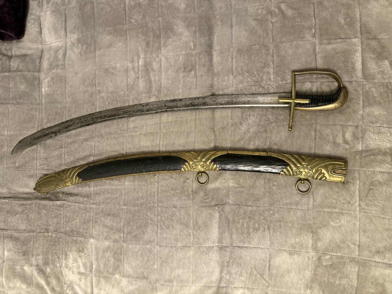

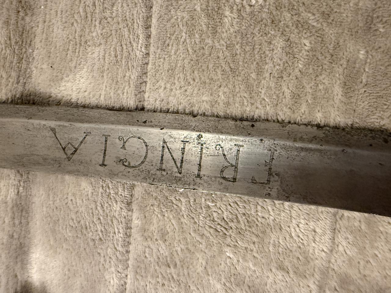

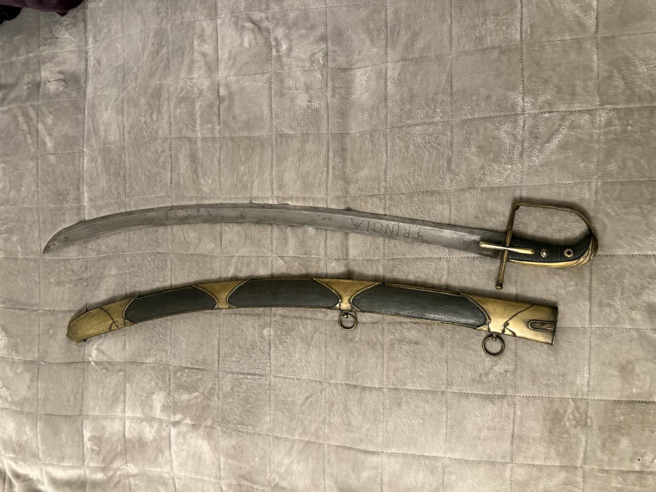

Hungarian hussar saber around year 1750, bearing inscription FRINGIA on the right side of the blade, in very good condition, long very nice blade, there are (i got one) more decorated examples, this one is more battle example, than show of decorated one (which were allso used in battle, just more richly decorated).

congratulations, this is really a very nice sabre in a very good condition!!

This is a magnificent example, and was anxious to see Corrado come in.....as he is the true authority in these areas of East European esoterica. It is always daunting as for many years there has been a plague of reproductions of these kinds of rare sabers, but the true age on this can be seen past the cleaning that has been done.
The FRINGIA inscription has long been a conundrum, so I wanted to link a previous discussion and hope we can look a bit into the history of these Hungarian sabers, which set the pace for European 'hussar' cavalry units.

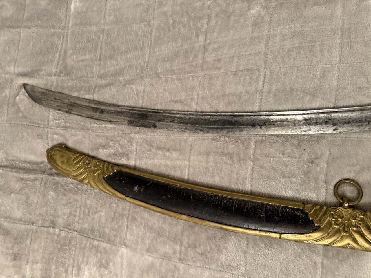

Im glad you like it, il now post pictures of another one, it is more finely decorated, and has older blade, but without inscription.

Pictures

Hmm pictures came out realy lousy, and rotated.

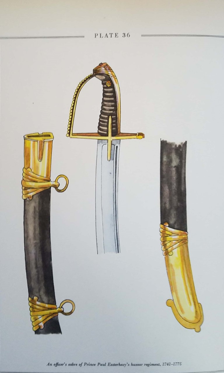

The saber in post #6, for those interested, appears to be one from the cavalry unit of Prince Paul Esterhazy (Wagner, 1967, plate 36).

As I mentioned, there have been fakes made for decades now, and very convincing. It is almost impossible to tell fakes as they've gotten so good at detail, which is why I prefer the dark, pitted and worn examples. It is easy to mask newer work if it is surrounded by over cleaned and often authentic old blades.
Having examples with provenance from museums is the best bet, and most of the items in Wagner from which he did his drawings are in museums in Vienna and Germany if I recall (he lists all the sources)and I did get a few photos of the originals.

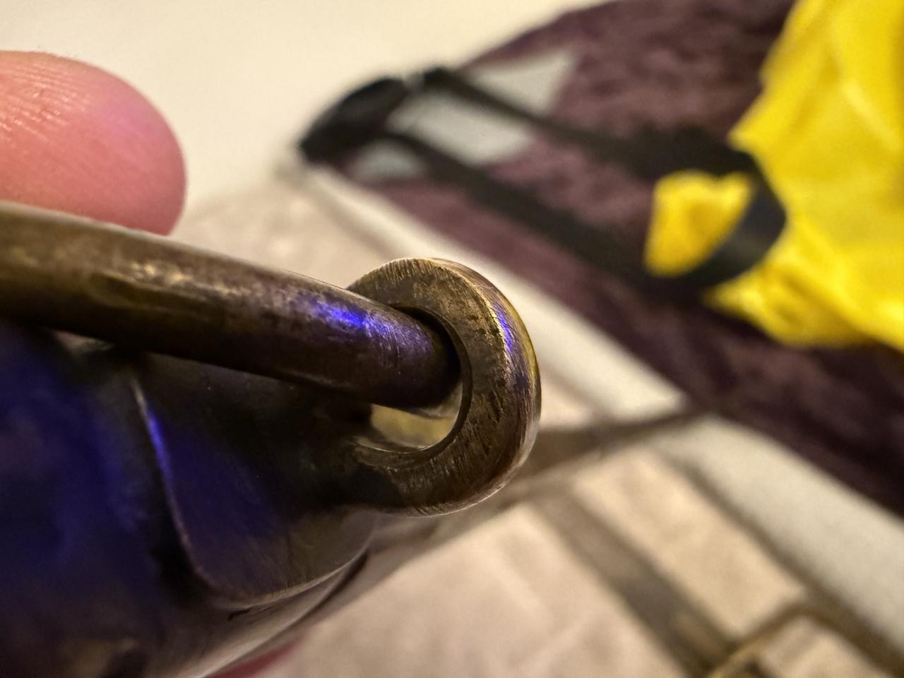

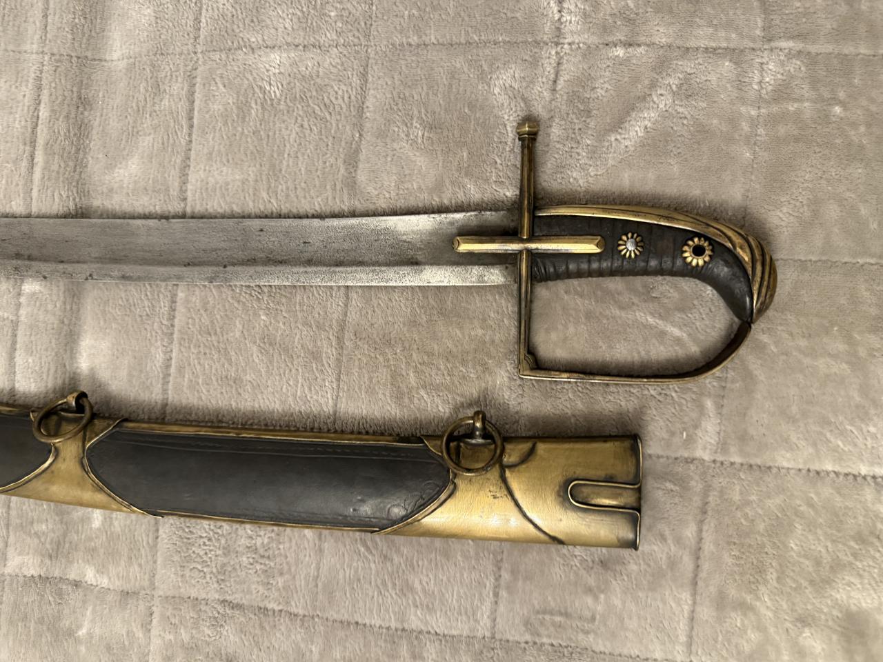

could you please make fotos of the sabre in post 1 like this one?

Offcourse.

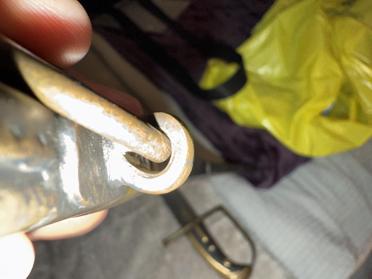

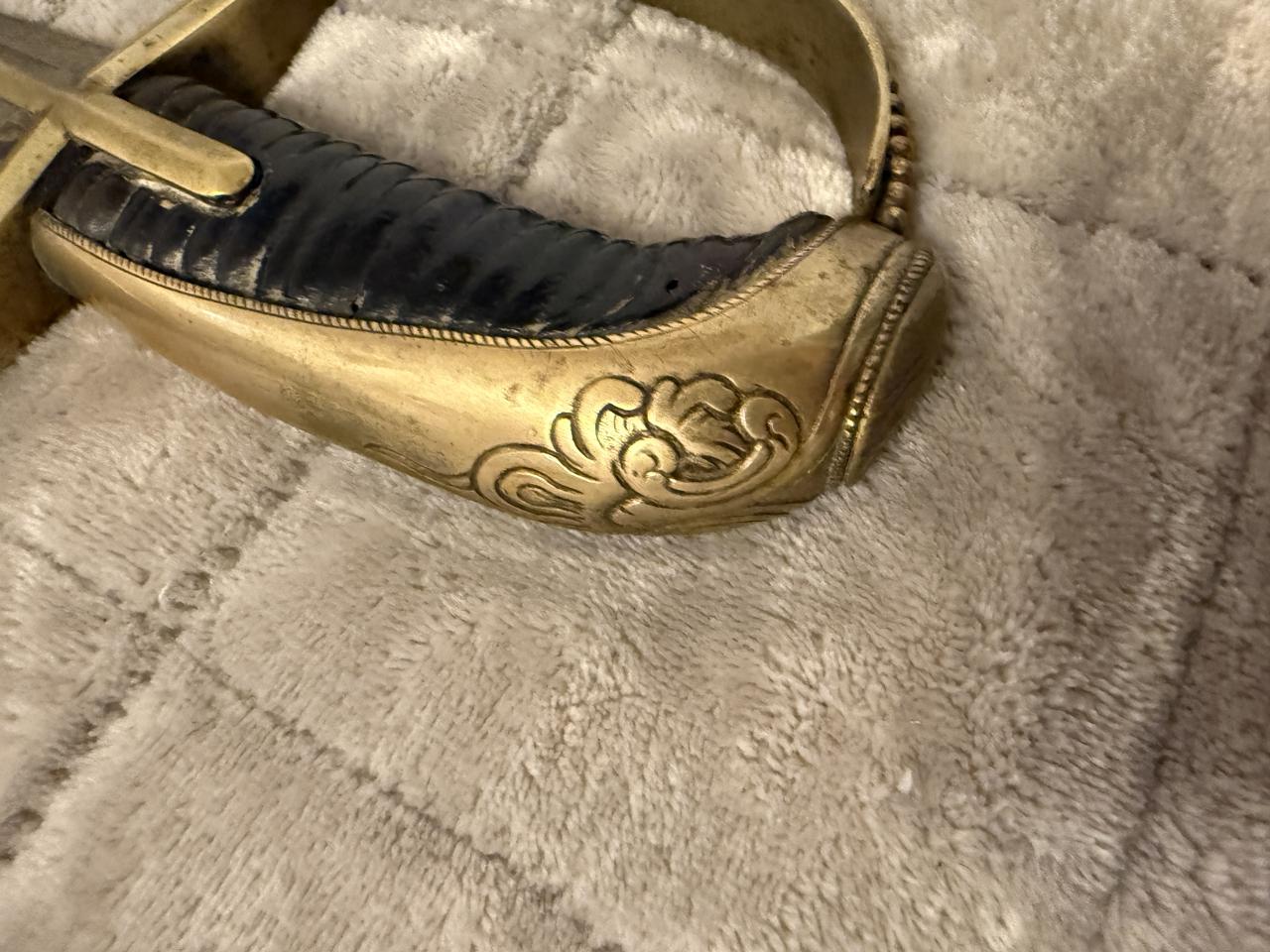

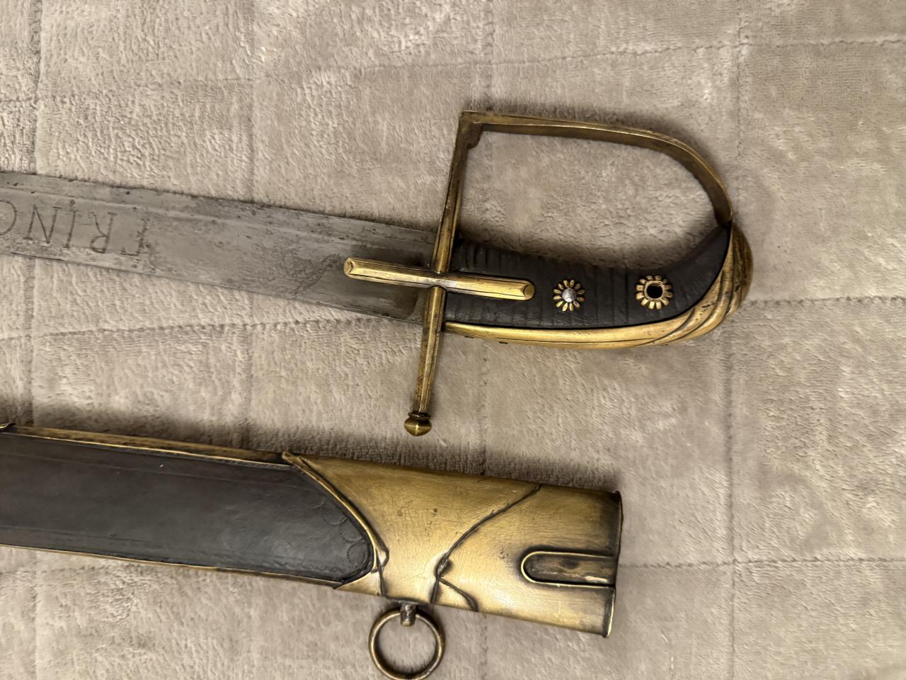

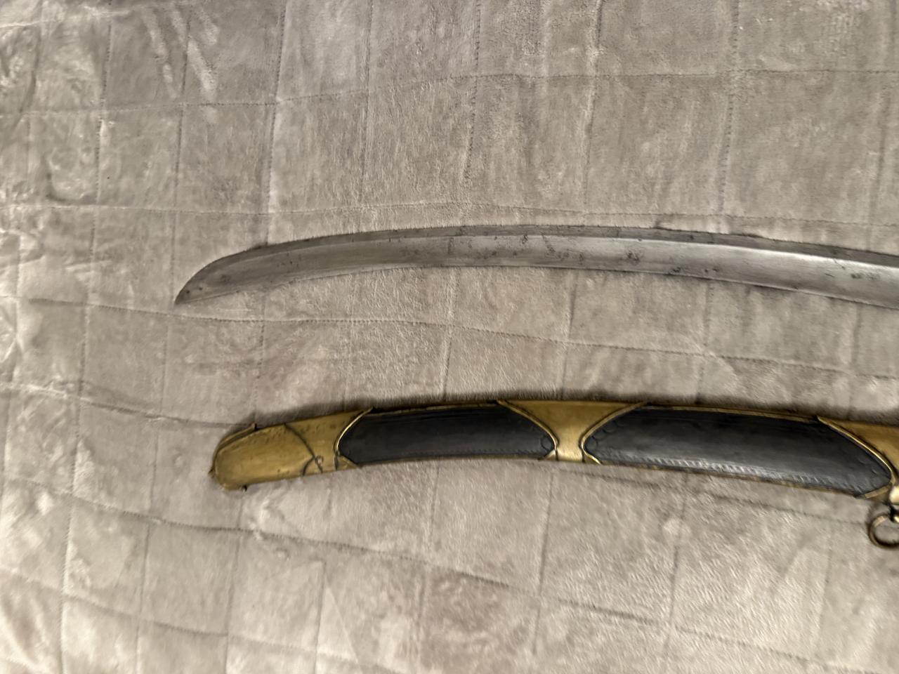

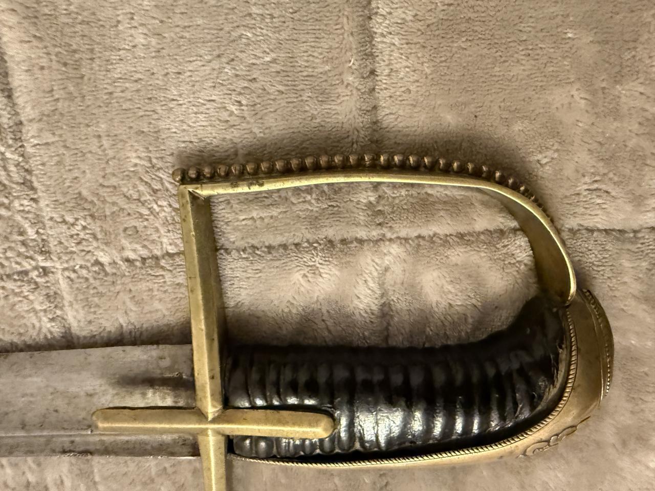

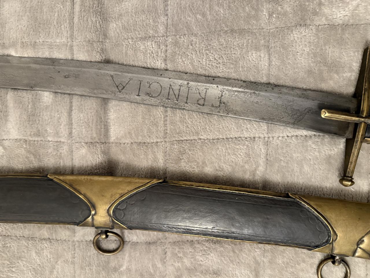

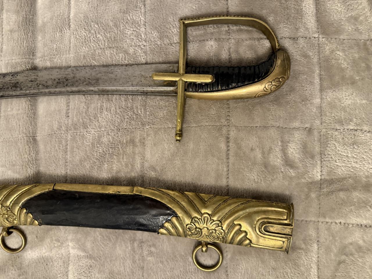

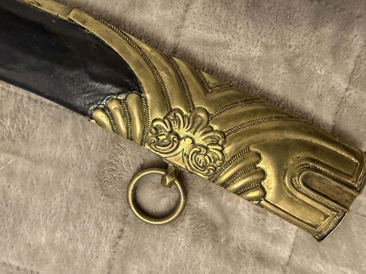

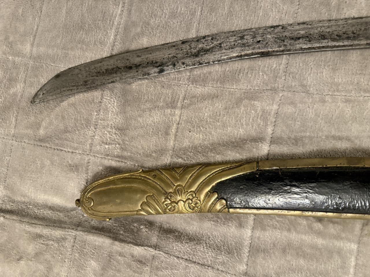

I took pictures, but after i examined the saber completely( i bought it and put it aside didnt examine it) im a shamed that i bought this fake, it is sooo good made on surface, i was sure im buyng real saber in great condition, but blade is so soft i bent it with ease, ring holders got no wear, and wood in scabbard is darkened on the entrance 10 centimeters later, it is new!
This is so emberasing, i bought something in a hurry that im not familiar with, and boy i bought it!
Every school costs.
So please be careful, examine things you buy in peace and 100%, and treat them as if they are fake, when you relax a too much and get secure that is a moment you fail and trip.
serdar is offline   Reply With Quote

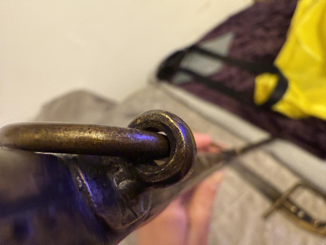

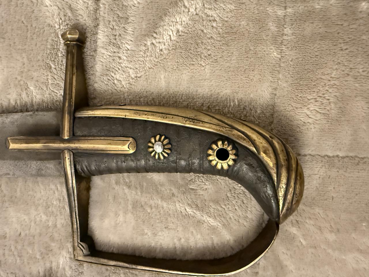

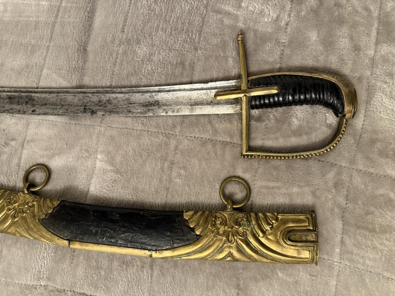

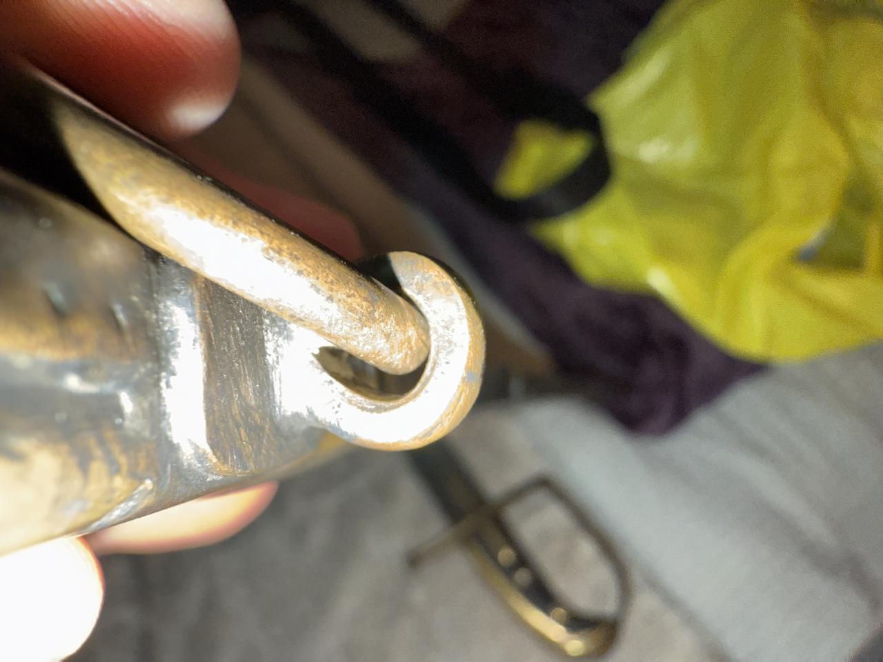

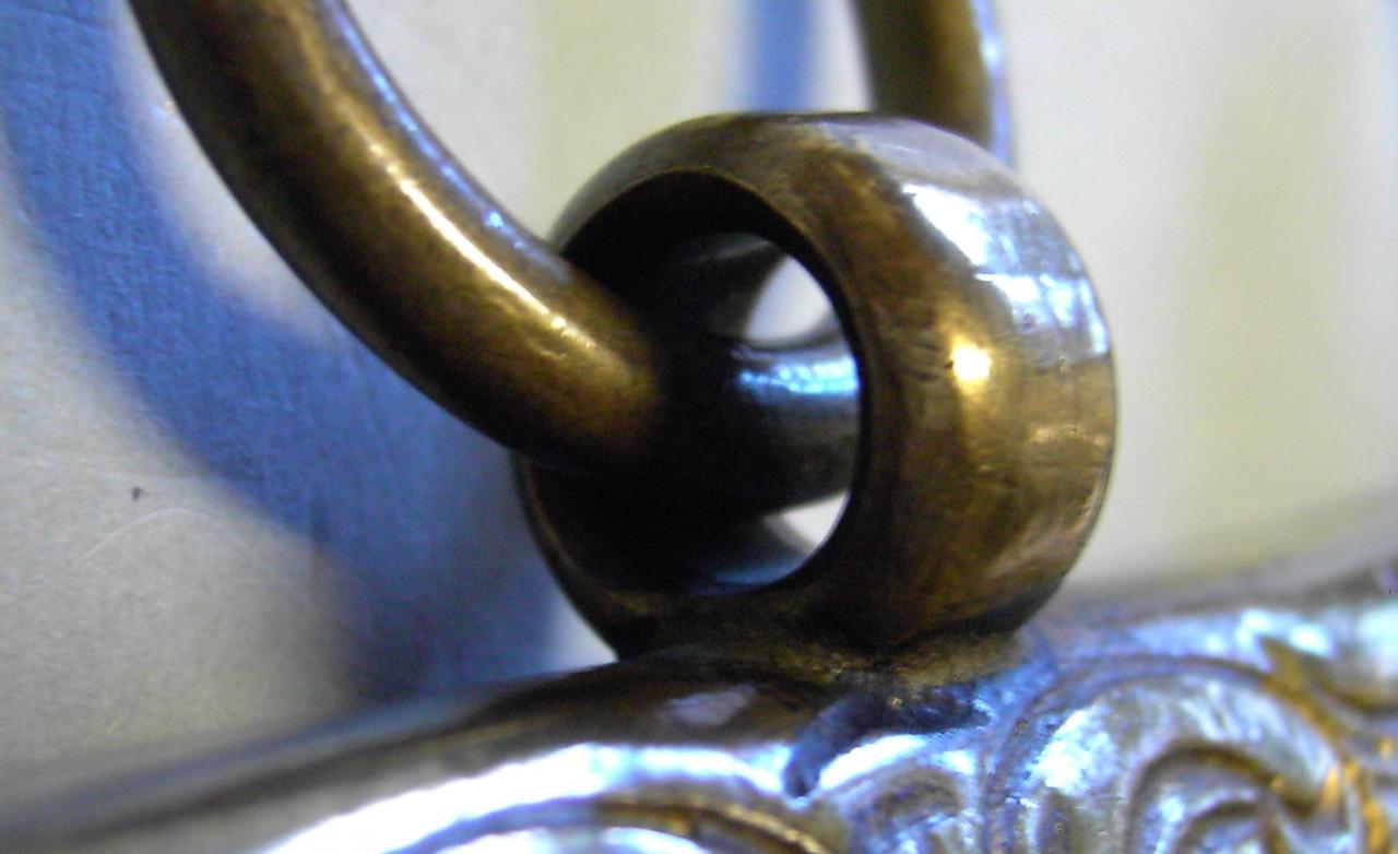

As you can see, there are no signs of wear or age on the rings, which would be expected if it were an old, worn piece. Unfortunately, that is not the case, so this is probably not an original saber - as beautiful as it may be!
Old 9th April 2025, 09:47 AM   #17
serdar

Yes, i didnt checked that when i was purchasing it, on this type of "military saber" i would definetly expect that place to be worn out, if it was caried, but why i didnt check it out is becouse saber in general looks little carryed, so there wouldnt be that much wear there, but there is no wear at all, not even 0.01 mm, as other things on saber indicate (leather on handle worn out, bruises on scabbard (metal parts), blade etc, but leather on scabbard is also in too good condition for saber that is worn, it is relatively soft leather.
But i encountered on some turkish and persian saber which are original and 100% genuine, that there is no wear in ring holders, why i realy dont know, maybe they werent caried on the body like this saber but was fixed to horse, they were caried by high ranking warior and saw little use, on the back secured by strings etc.
But it is interesting thing, so wear on place where ring is isnt allways indicator of age, and doesent wear out like on others, materials, way of carry, way of construction of ring holder etc.
But this saber is undoubtadly not genuine, somebody gave a lot of efort to make her that good looking.

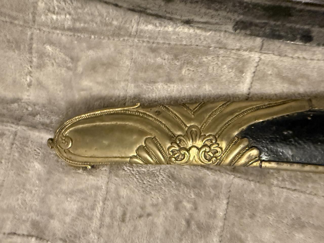

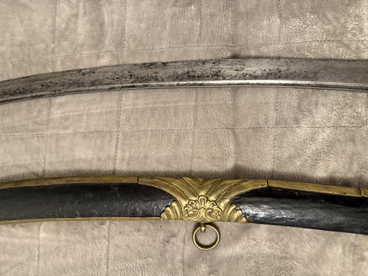

I looked at the photos of the FRINGIA saber again. It seems possible to me that the forger only made the then missing scabbard. At least I can't see anything on the saber based on the photos that suggests it's a fake.

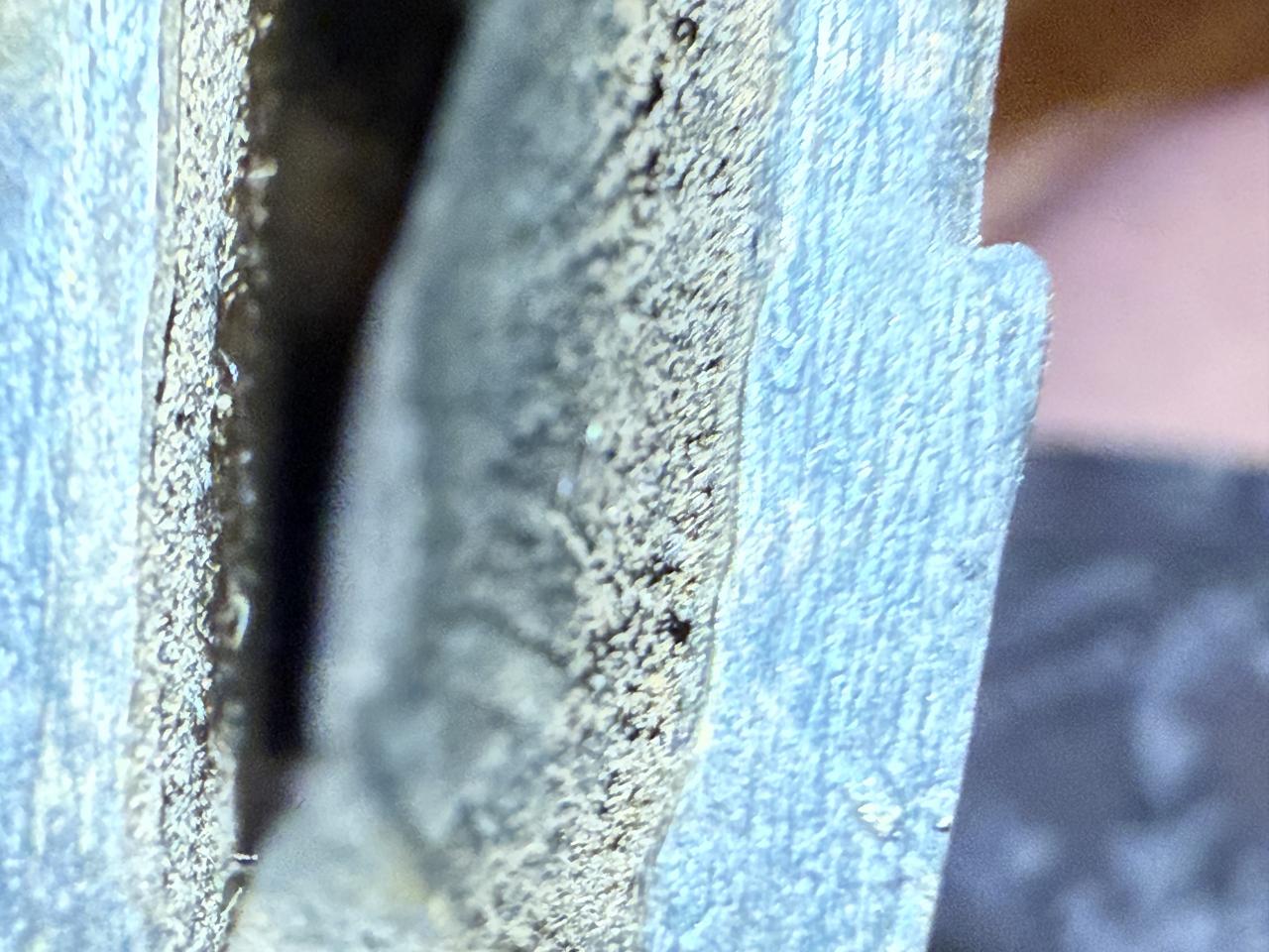

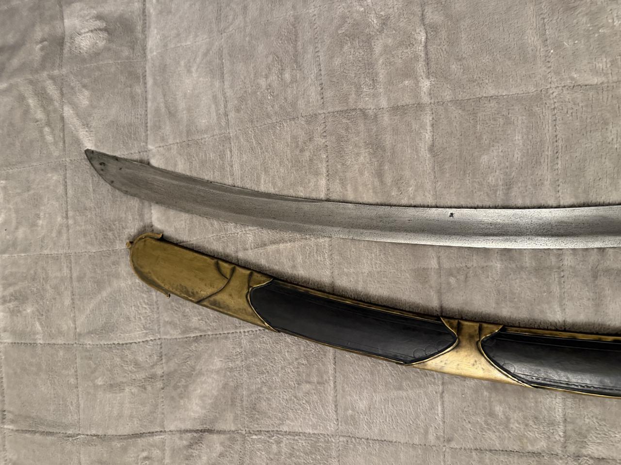

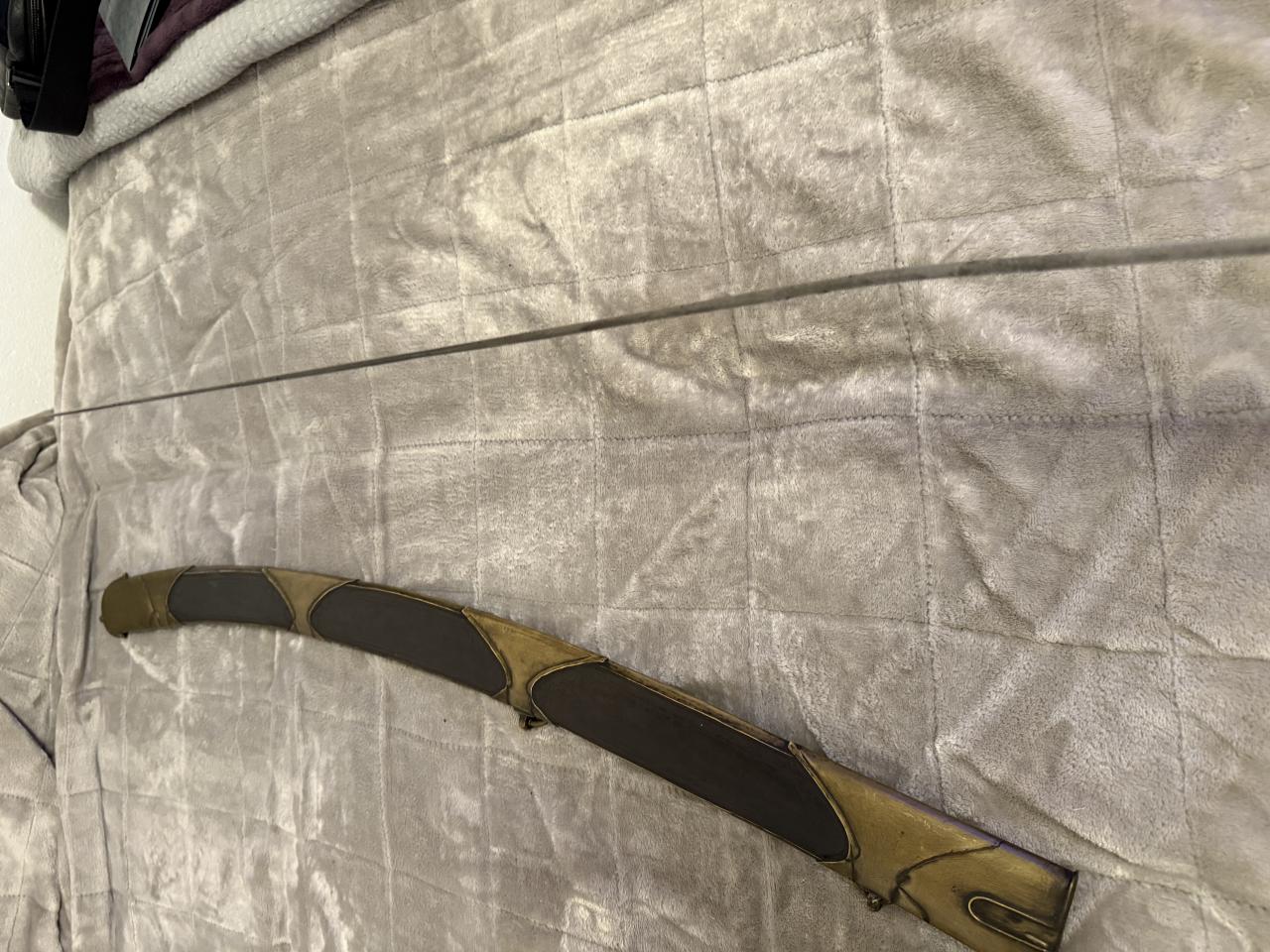

If you look at the pictures in post #15 you see that it was easy for serdar to bend the blade and deform it permanently. I can't believe that this is possible with an original piece.
Also the patination of the brass fittings of the handle looks as artificial as that of the scabbard fittings. Regarding the authenticity of the saber, I'm not as optimistic as you are.
I overlooked the bended blade, now it is finally clear.

Ouuu blade is so well made, it looks real 100% BUT it bends like butter, im not egsagarating it is so soft that there is no way you could make a sirious damage with it.
I dont get it if they put so much effort in that forgery, why not make good tempered blade....?
One thing blade when struck with nail sings like its tempered but it definetly is not!
And on that other fake polish saber, blade snaped when i bent it, martensite like steel structure, some mix of steels acid aged.
It realy disgusts me that scammers and scumbags, make forgery of an antique weapons.
One needs to be very very carefull and thrust no one, but then again i dont get it several expert people looked at that polish saber and all said it is genuine, one of those persons is a old guy who has amazing european! Weapons from 1500-1800 and he was allso deceived by that forgery.
