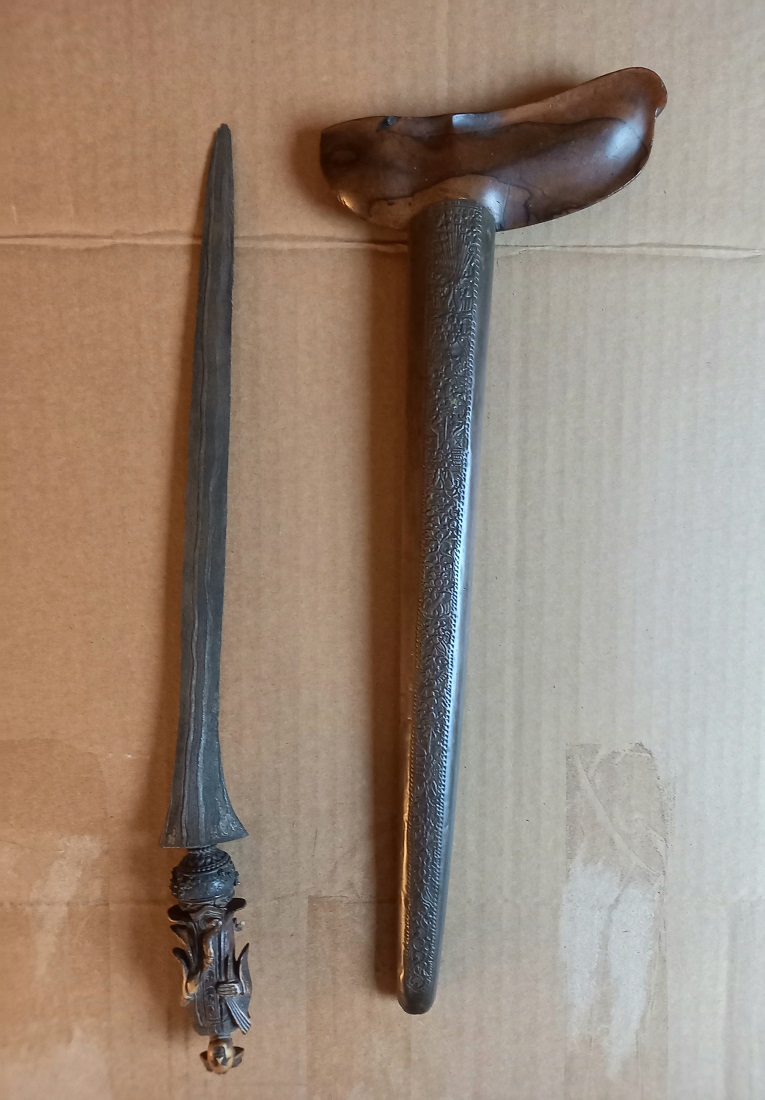

This is the last keris I bought. It intrigues me a lot because the blade is not really a Keris blade and the handle (in ivory) is of Chinese tradition.
The scabbard is from Yogyakarta and was specially designed for this blade (the small originality is most certainly a break that has not been filled, but which has been repolished properly to appear original).
The mendak and selut (sadly very damage) are in silver.
Blade lenght : 33cm

There are a lot of Chinese people in Jawa, apparently one of them decided to make a statement.
Everything about this keris is outside socially correct parameters for Javanese social & cultural purposes.
My guess is that it dates from second half of the 20th century, that it uses an older Chinese carving that has been adapted for the hilt, and it was only ever intended for wear in a Chinese social setting.
Social attitudes in Jawa during other periods of time, and in other than a Chinese environment would militate against other possibilities.
One other thing:- the selut is very recent, I'd say 1960's at the very earliest, this pattern selut is usually plated brass.

The ganja of the blade seems to be missing? This type of selut made from gilt brass is common and recent indeed (tourist quality) but this one may have some age?

I wonder if this was always a kris blade or was it not a pendang blade adapted to be used onto a kris?
as for the Deity , I am not an expert of Chinese deity but I looked up a few images (I like the challenge)
Could she be Mazu? Goddes of the Sea? Especially revered by Chinese living in South-East Asia
Sometimes depicted with an object on her right or left shoulder and sometimes with a fly whisk, she is a Sea Goddess especially revered by Min people

Jean:- I believe it is certain that the blade has been re-shaped from something, I think probably a keris, but really, it could be anything big enough to accommodate it.

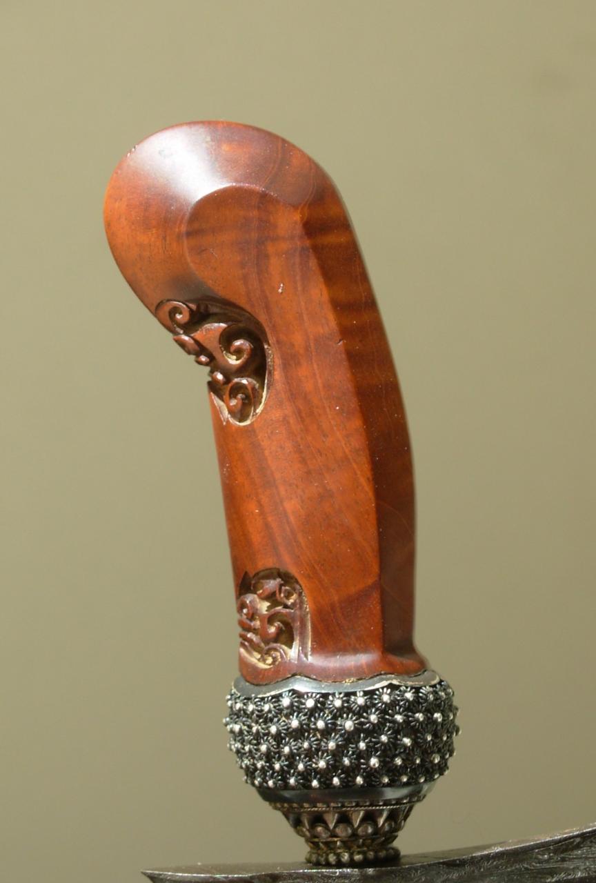

Alan, this type of Selut was common in Jogja already around 1900 and most probably at least 20 years earlier. It is depicted in Groneman's plates on some of Karyodikromo's Keris, he calls the motif on this Traptrapan Selut Untuq-Untuq.
The Selut of Athanase seems to be lower in quality, because the upper rim is straight, but low quality in silver is perhaps a bit unusual.

Alan, exactly, that would include the possibility that the Selut was made to accomodate the figurine turned into hilt.
Regarding more recent Selut, I have seen by far more ones with stright upper rim mated to planar hilts, and this is, what I would call lower quality.
If you have van Duuren's edition of Gronemans articles, photographs of Keris with such Selut can be found on pages 267, 264, possibly of higher quality 251.
I own two Keris with such Selut, both came to Europe before WWI.

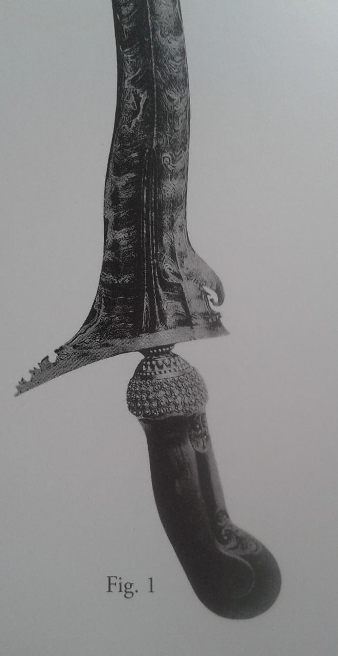

One of them:

Could it be a sepang blade missing the ganja?

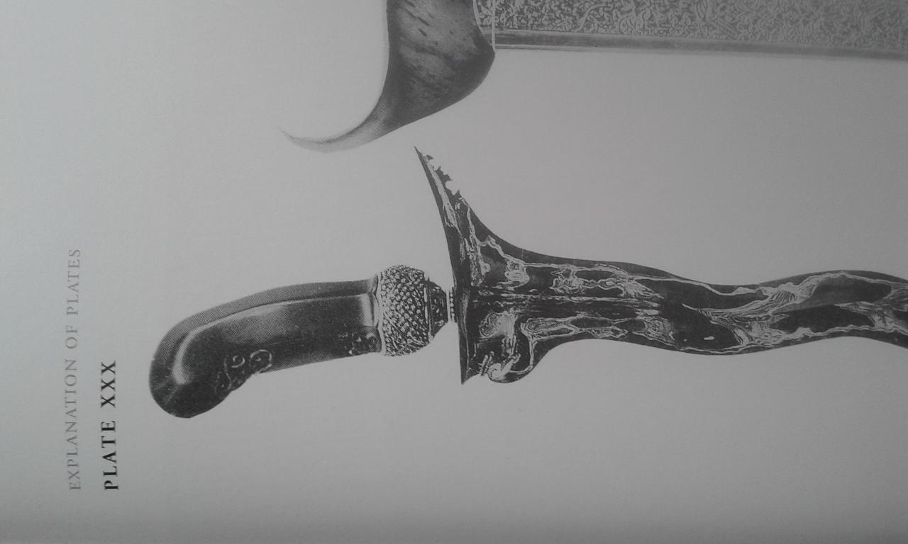

And two from Groneman, one more refined:

The selut is in silver, not brass plated.
Yes I think that a Sepang Keris blade without ganja is the most likely.
The warangka was made after the loss of the ganja.
The thin coper pendok and the good quality of wood make me think that the set was assembled during the first half of the 20th century, but not later (But it's a feeling, not a certainty).
In any case, as Allan said, even if this "Keris" does not respect the Javanese rules, it is not an object for tourists.

Thanks for those pics Gustav. Yes, a couple of those selut certainly seem to be the same motif, but I'm not so sure about the one where the individual dots have been separated into "islands".
Still, it is interesting to see these old examples.
These days this pattern selut is one of the lower priced styles, but way back when these ones that you have shown us were made I'd guess they were probably no better & no worse than most other selut in the market place.

I'd say almost certainly a Chinese deity Anthony, but which one? Chinese deities can be very difficult to identify from their attributes, firstly because there are so many Chinese deities, and secondly because each deity can be represented in various ways.
In Jawa, particularly along the North coast, the Ming admiral Cheng Ho (Zheng He, or in Jawa, Sam Po Kong) is particularly revered, apart from being in command of a 15th century Ming Treasure Fleet, sent to make tributary states of kingdoms bordering the southern seas he also helped to bring Islam to Jawa. There is a temple in Semarang named after him, I don't know if he had it built, or it was built in his honour.
The Ming Treasure Fleets?
Well, that was an early Chinese attempt at exactly what China is doing now with Belt & Road:- turn the world into Chinese tributary states. This attempt failed because China got a new emperor who had Buddhist advisors and they thought that there were already more than enough problems running the country without generating more problems by putting tributary states on the books. So the "tribute or else" policy stopped.
Anyway, Sam Po Kong is sometimes shown with a fly whisk in one hand and scroll in the other, maybe if we swap the scroll for fortune sticks (kau cim) we might have good old Cheng Ho here.
Or maybe somebody else.

Looks like great President Mao in an ancient Taoist robe
