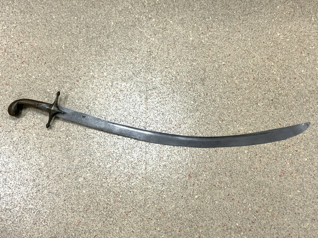

Folks, any insights appreciated.

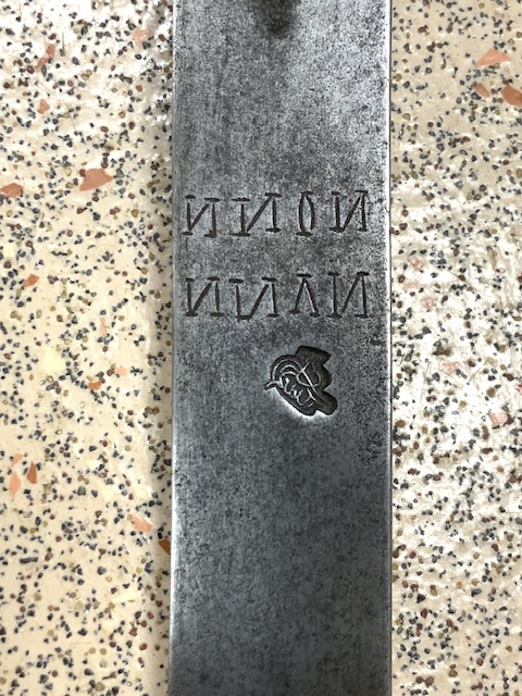

Picked this Ottoman sabre up at auction. I see there is a tughra, I am supposing a state arsenal mark.
Are the Cyrillic -type letters talismanic devices?
I am guessing it is an 18th C. piece, but not my field.
Many thanks in advance,
Jon B

It is not Cyrillic. My guess is that this is in imitation on European marks on older blades, done by someone who was not literate.

I mostly find those imitation blades with Ottoman stamped tughras coming out of Jordan with mounts that are very similar in quality and style to Shibriyas made in Gaza. They sometimes reuse good blades and I assumed that this is their local blade quality.

Hello, it looks indeed a faked old blade markings and by that i mean a old european blade markings the ones usualy found on old karabela blades of period 1550-1690. Even on some husar blades, but predominatly on three fuler karabela blades of steyer provinence, i have two of them, and they have similar letter markings with sickle markings and are certified from period of 1580-1650 made. (Il atach pictures of markings)
And about thugra, i think it is fake, by that i mean it is stamped newly, and other thing, thugras of sultan what that narking is vere never struck on the blade but on the silver part of the scabbard, so someone probably found old thugra seal for silver and struck it on the blade.
Cheers.

I just took a look at “thugra” that is not real antique sultan thugra, someone made fake thugra and struck it on the sword.
Someone made lots of detaile but done it all wrong.

Similar markings on a Balkan pistol of mine, possibly French manufacture for the Balkan market with locally applied marks probably done by an illiterate craftsman.
Norman.
