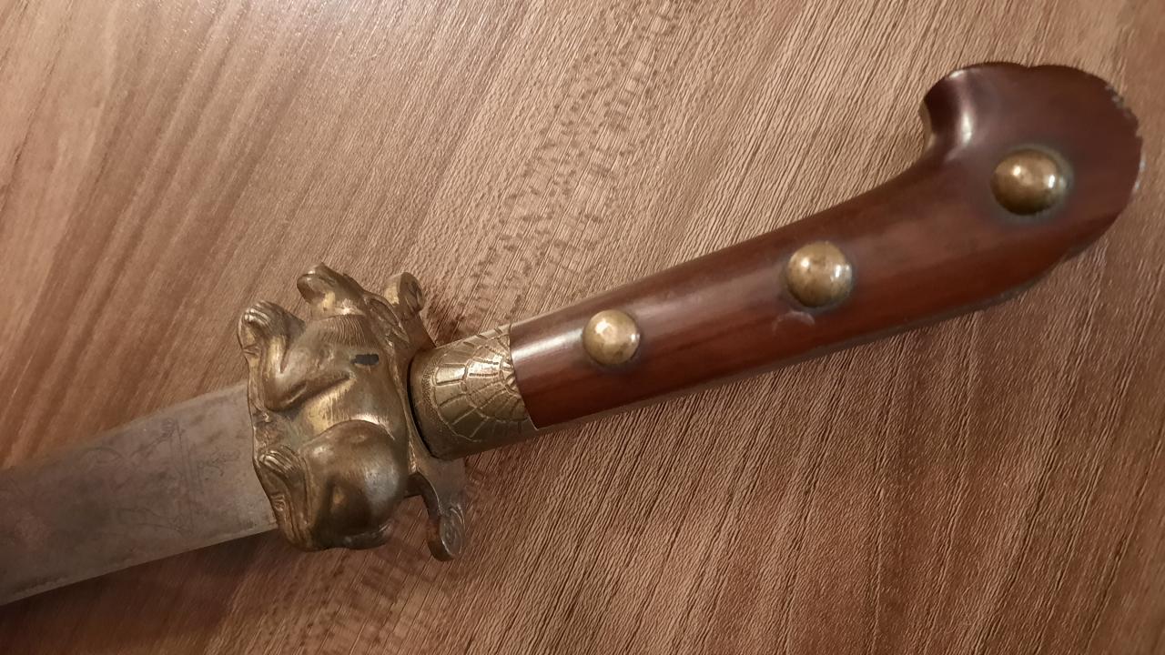

Default European hunting sword for comments

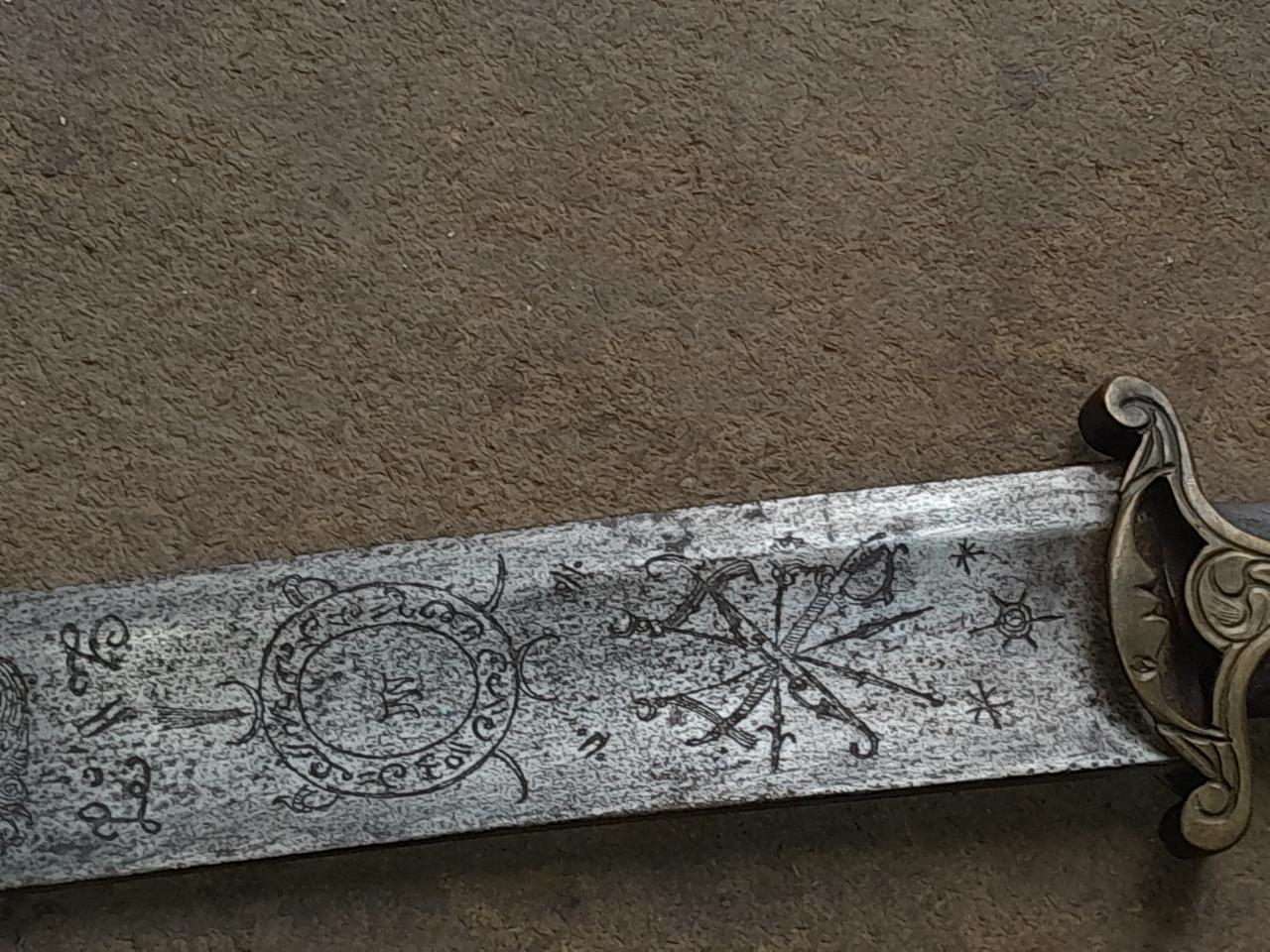

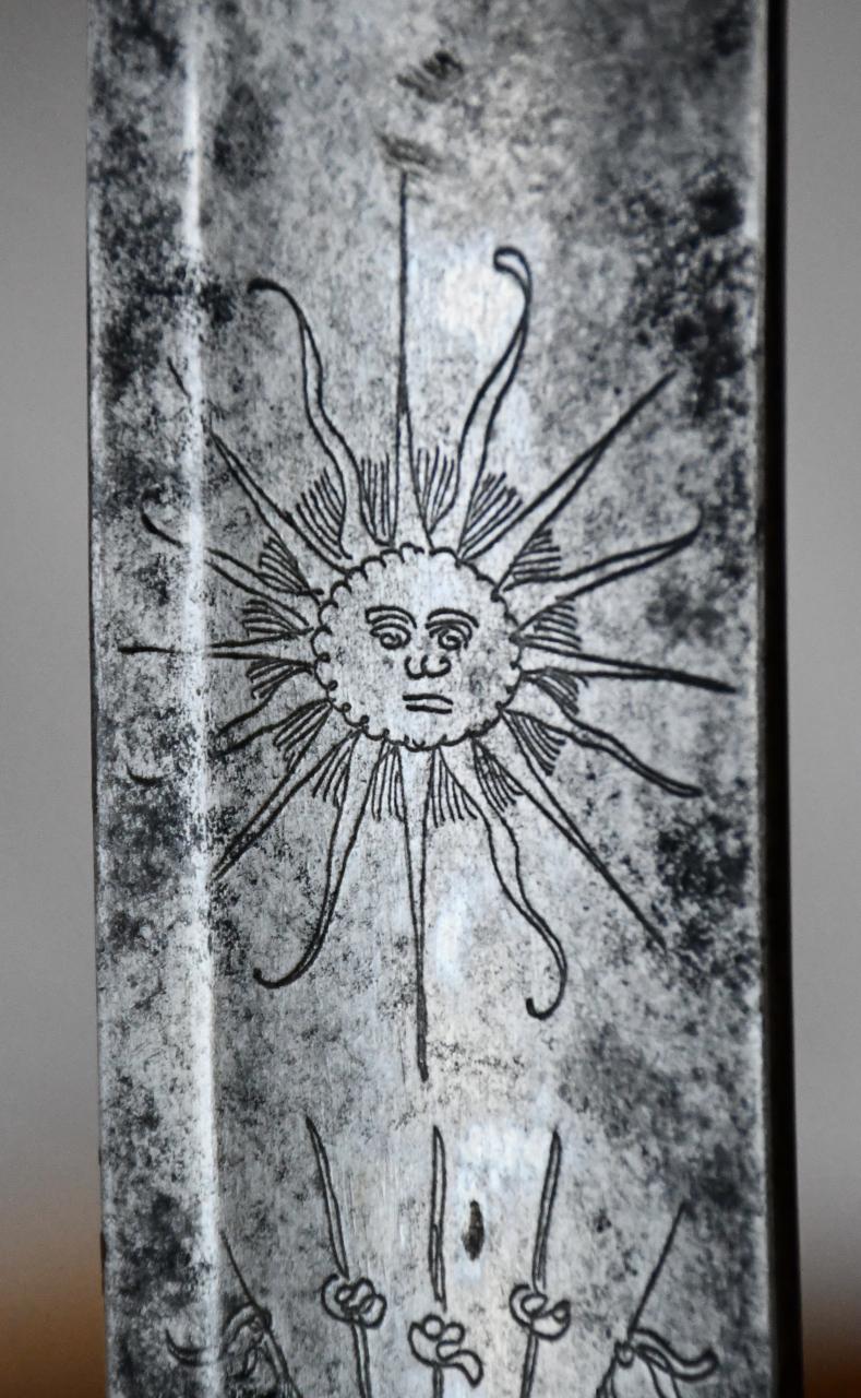

Hi I am wondering if anyone can help me to identify this sabre, with etchings.
Thanks in adavance.

Interesting piece! The "Turk head" decoration is something you often see on late 18th/early 19th century European sabres.

Posts: 10,867
As noted, these kinds of decorative blade themes are from European regions in the mid 18th to early 19th centuries, as the oriental mystique became popular in military units emulating the notorious pandours of Austro-Hungary .
The Turks head, magic/occult symbols and devices were meant to further carry this mystique in the overall esoteric character of the sword. While these kinds of decorative devices are familiar from East European swords, they were also popular in French swords where elements of troops from these places were often factored into French forces.

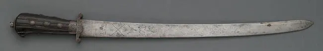

Hi,

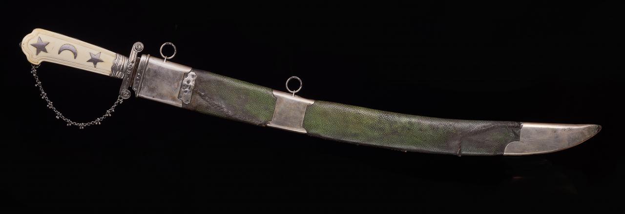

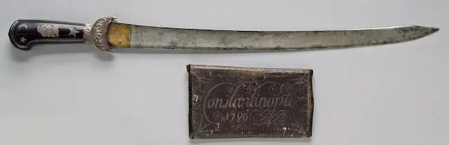

Looks to me like a decent quality 18thC/early 19thC hunting sword from continental Europe. See attached example along similar lines.
Norman.

Posts: 101
Originally Posted by Norman McCormick View Post
Hi,
Norman.
Oh yes.I see a hunting sword, mid 18th.century , grip form
and the short guard probably show french origin.

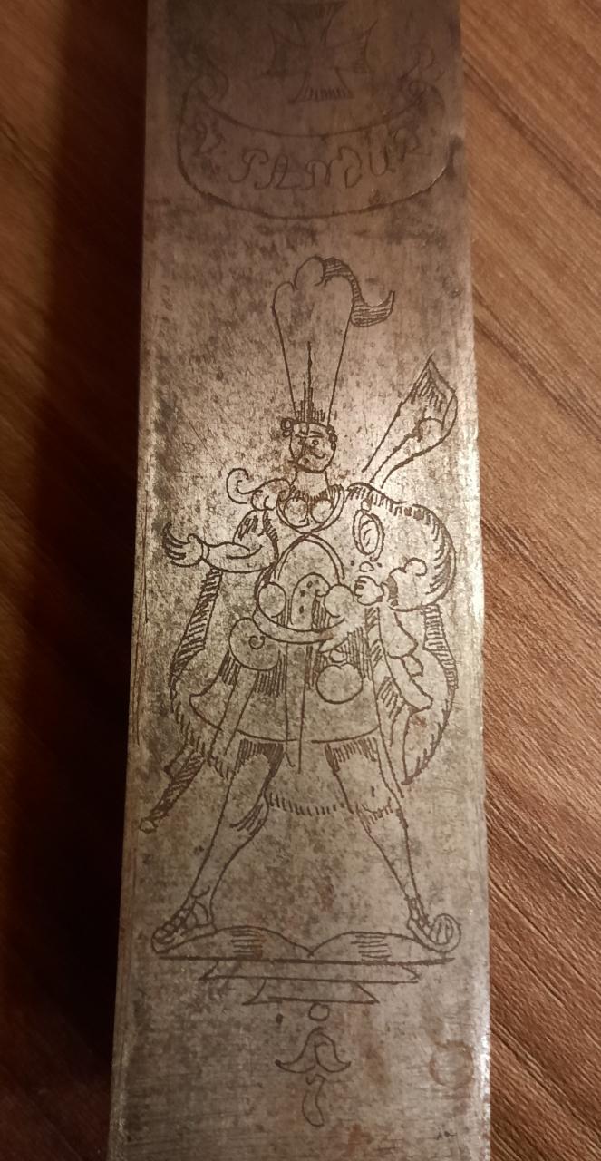

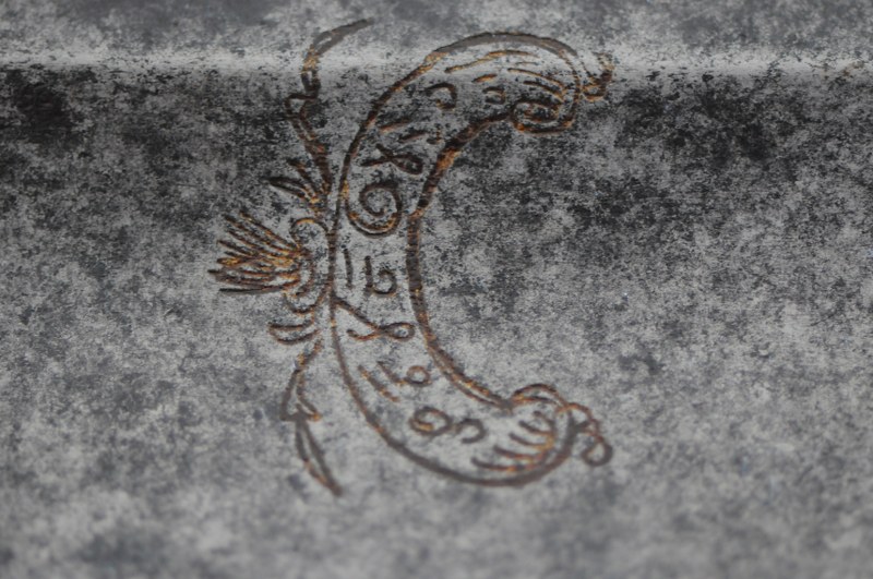

Thanks for the info, I have also found another thread on this topic from a few years ago.
Is there no literature out there on the topic of these inscriptions? I am wondering what alpahbet it is and what it means...
Thanks

May I request that this thread move to European?
As Norman has well noted, this is a European sword, possibly a hunting hanger as used by jagers, which were specially formed light infantry units. These units were essentially for forward action, skirmishing and activity outside the movement of larger formations. As foragers (the term jager in German =hunter) they were also responsible for food supply.
In that they were often in battle with or proximity of Ottoman forces, the affinity for oriental fashions,styles and of course weaponry was prevalent.
These circumstances were of course well known with the pandour units of Baron von Trenck in the service of Maria Theresa.
The 18th century fascination with the mysteries of the occult, magic and oriental esoterica led to the use of these kinds of decoration and motif on sword blades, and as seen here, often the elements of the sword itself. This was known in the 18th c. as 'chinoserie' (=in the Chinese manner) referring to of course 'oriental', which actually collectively referred to China, Japan, India and even Ottoman (Middle East as well).
Fantastic piece of esoteric weaponry!

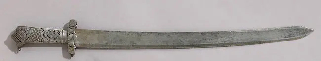

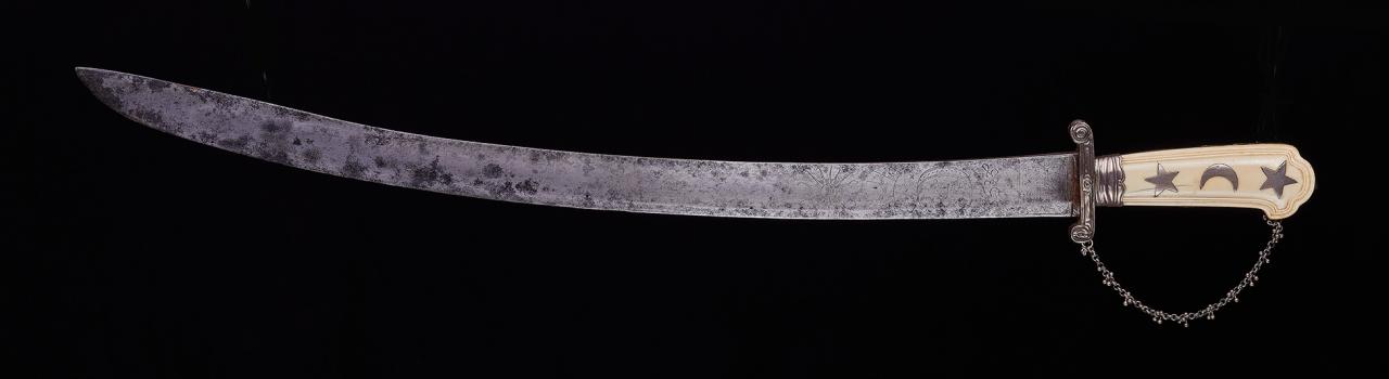

Hi,
All these tagged as French 18thC from old sales catalogues.
Norman.

Posts: 10,867
Spot on Norman!
This style of blade decoration was extremely popular in Nantes, particularly by the purveyor Caissagnard as I understand, following similar 'oriental' fashions in Eastern Europe.
Note the 'clipped point' in the one at top, termed a 'pandour point' (Seifert, 1962).

Spot on Norman!
The panduric style was very popular in the middle of the 18th.century ,when Franz von der Trenck gathered a 5000 soldier corps,to support Maria Theresia in her fight against Frederic the Great in Slesia.The soldiers where known as wild and brave and became a symbol for adventure in those highly restricted times.I have a German hunting sword from the same time, that also shows a panduric tip,in combination with a Pandur on the blade and the inscription " Vivat Pandur" .The inscription on the sword discussed makes no sense bur it looks somehowe "eastern" and that was the sense of the decoration.
Akanthus is offline   Reply With Quote

After doing a bit of reasearch i realized that in Austria-Hungary they were/are also called Pandurendolch.
