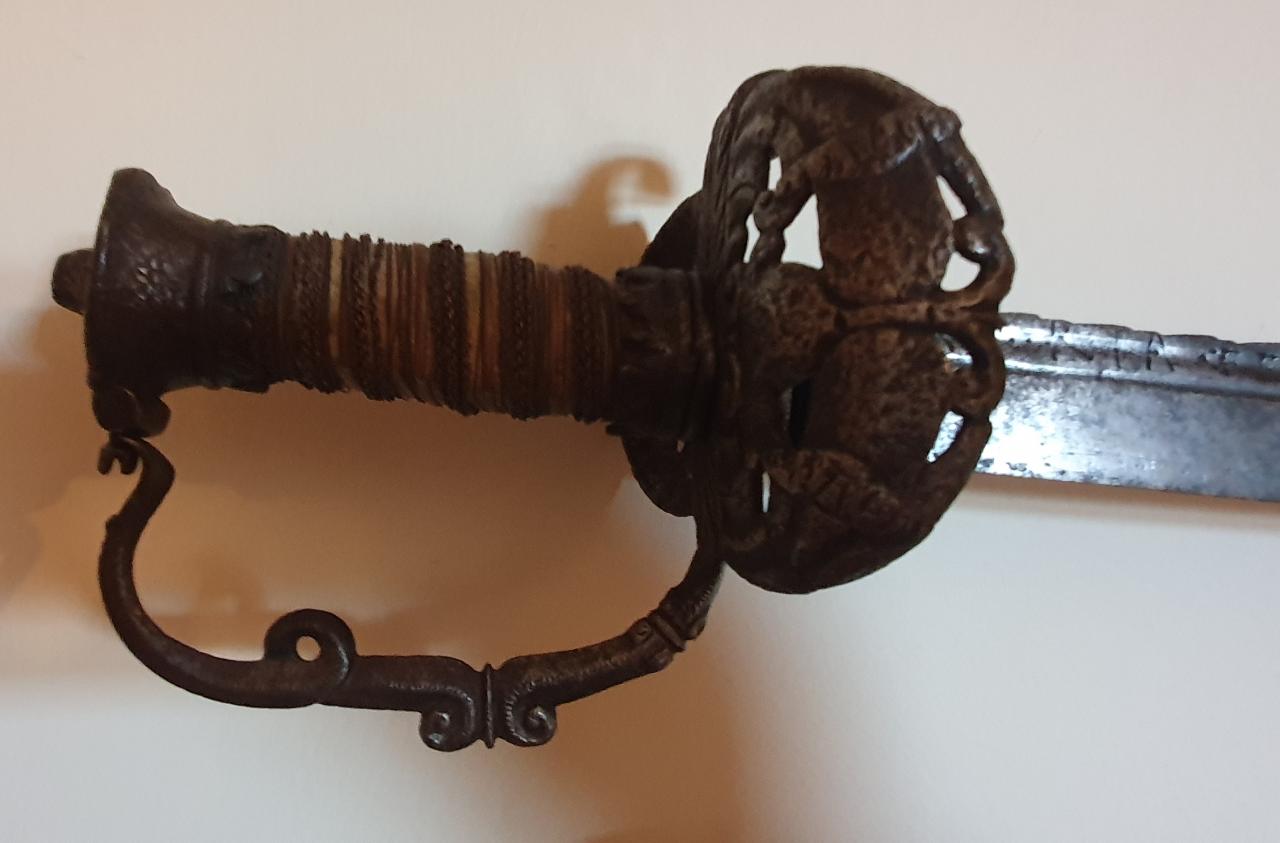

What I am trying to establish is how did the very distinctive hilt used on Hounslow Hangars (see image) develop?
It seems to appear from nowhere in my experience (limited) and share no resemblance to anything before or after.
Any pointers regarding it's provenance would be much appreciated.

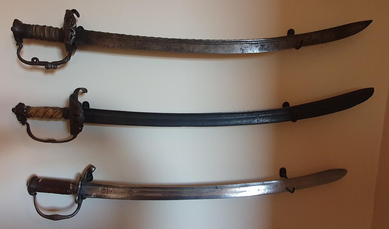

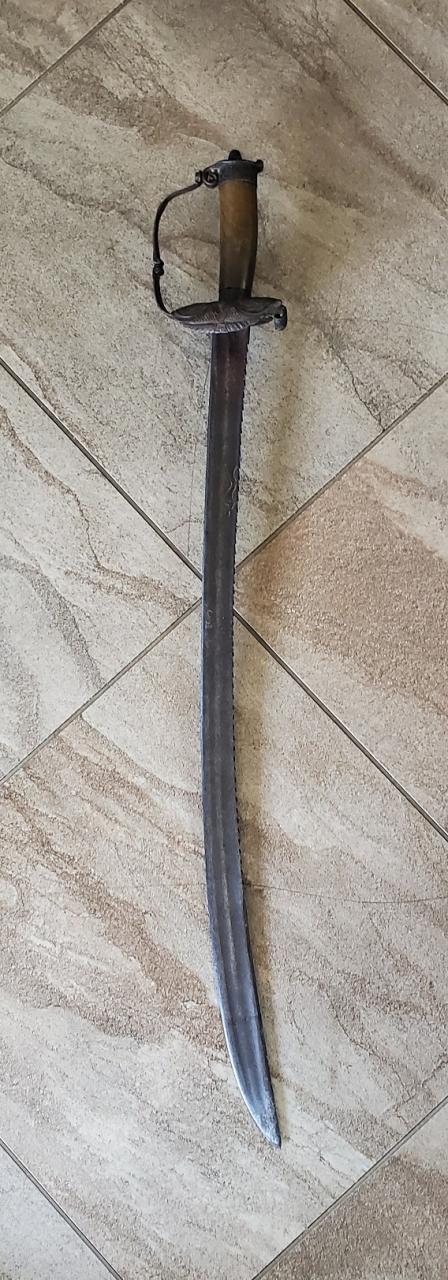

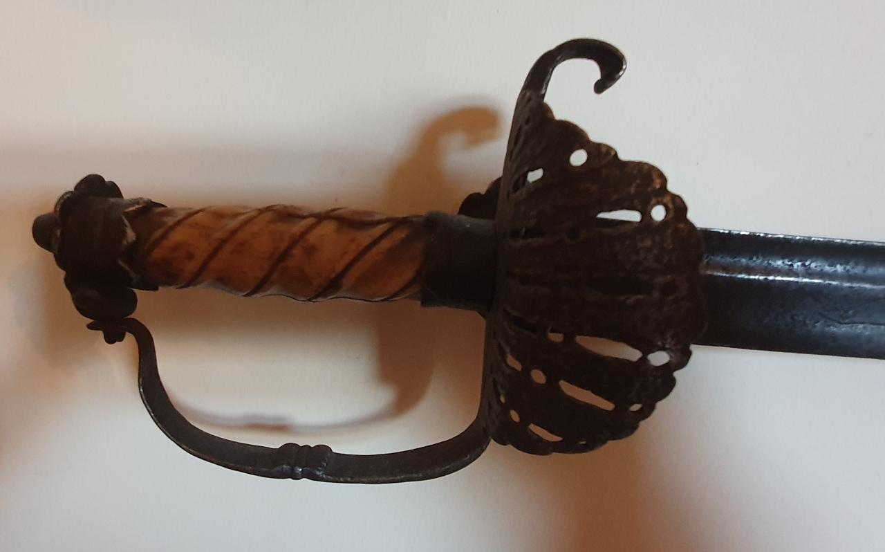

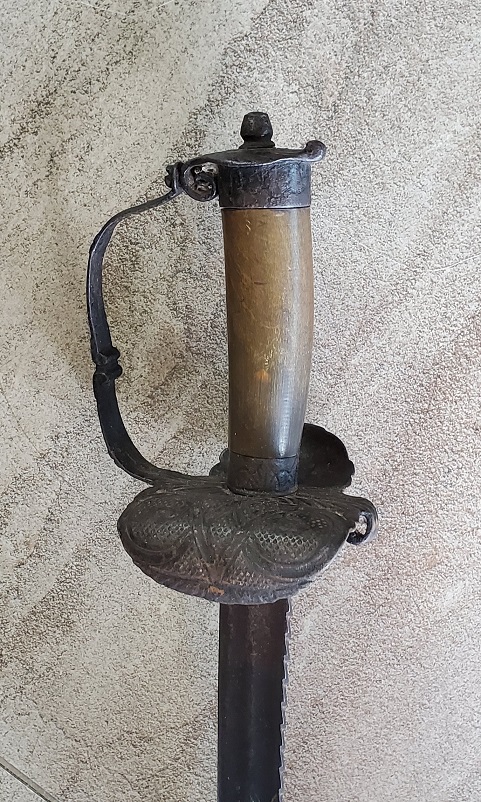

This is an excellent idea Keith to take this topic to its own thread, and to be honest I have never really pursued the origins or influences which were likely to have inspired these distinctive hilts of Hounslow. I have transferred the images of my example to place with the discourse.
As noted in other discussion, my example appears to be one of these hangers with serrated back produced (or assembled) there c. 1630-40 for maritime use (in that parlance regarded as cutlass of course). Having noted that, it seems that woodcut images of pirate figures of the 'Golden Age' of piracy in latter 17th century have somewhat similar hilted examples in a number of them. These seem contemporary to the familiar shellguard dusagges of European origin.

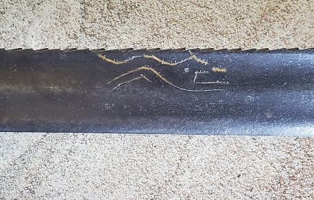

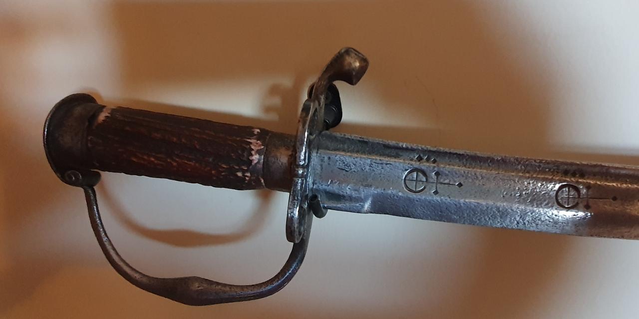

Peter as we were noting on that blade, which was actually on a Hounslow type hilt, the 'date' or numbers if standing virtually alone, might be regarded as a talismanic number or device. These are typically four numbers as seen in date/years but actually are number combinations with coded values.
These have to do with similar combining of numeric values in occult, magic and astrological symbolism regarding good fortune, strength, protection etc.
and were seen as imbuements of 'magic' in the blades. While obviously seen with skepticism in modern times, it must be remembered that in earlier times, superstition and often supernatural beliefs were profoundly present.

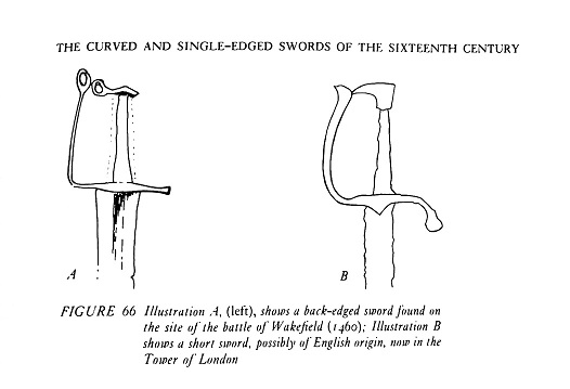

In present research, regarding the possible origins of the Hounslow 'type' hilts, I found some valuable insights in the late Ewart Oakeshott's "European weapons and Armor" (1980), p.153.
It shows a line drawing of an English bowmans sword c.1450, with a hilt that has remarkably similar structure in the guard with knucklebow. If compared to the Hounslow hilt, it is simply a more embellished version with the capped pommel, and the bilobate shell type counterguard.
This would seem more in line with the type of baroque designs that were becoming popular at the beginning of the 17th century, and the expanded shell guards simply more of a palate for often more elaborate motif.
These hanger type swords had evolved from the Continent and the much earlier stout chopping blade falchions, and the upswept knuckle guard simply the kind of developing types of guards.
It would seem that the 'Wakefield' hanger of that battle of the "Wars of the Roses" (1455-1487) and from an English bowmans sword (ironically an oblique connection to the concurrent thread on the English longbow).....might plausibly be the source for the hilt style. After all, in the early 17th century, the same strife between the Royal Houses in English monarchy between that of Lancaster and York still prevailed.
Sword hilts and forms often prevailed for long periods as we know, and the basic form of this historic English form, in more embellished style in accord with the then modern period early 17th c. would seem likely emplaced
The attached plate from Oakeshott (1980, p.153) figure A shows the compelling structural resemblance noted. .
