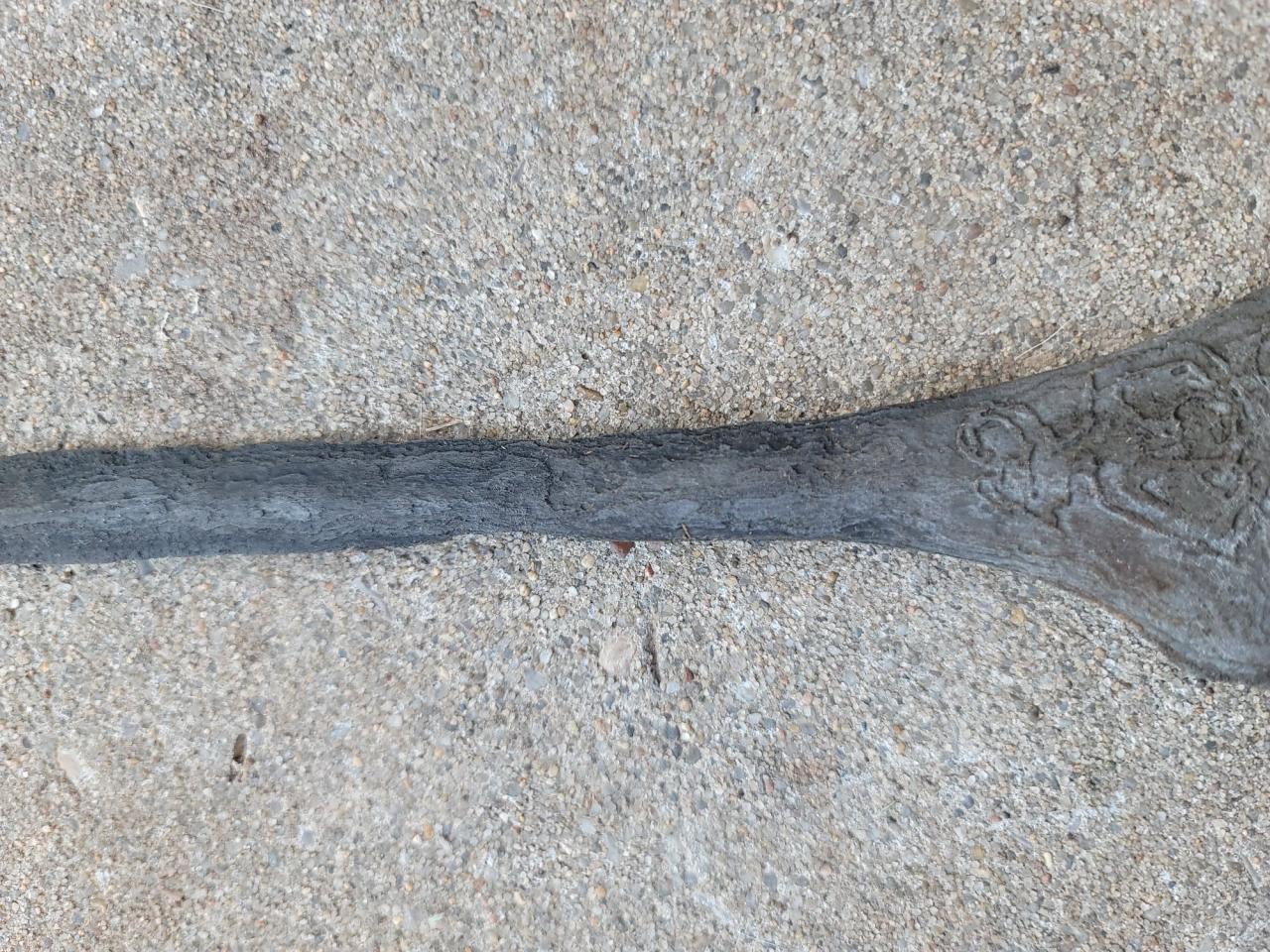

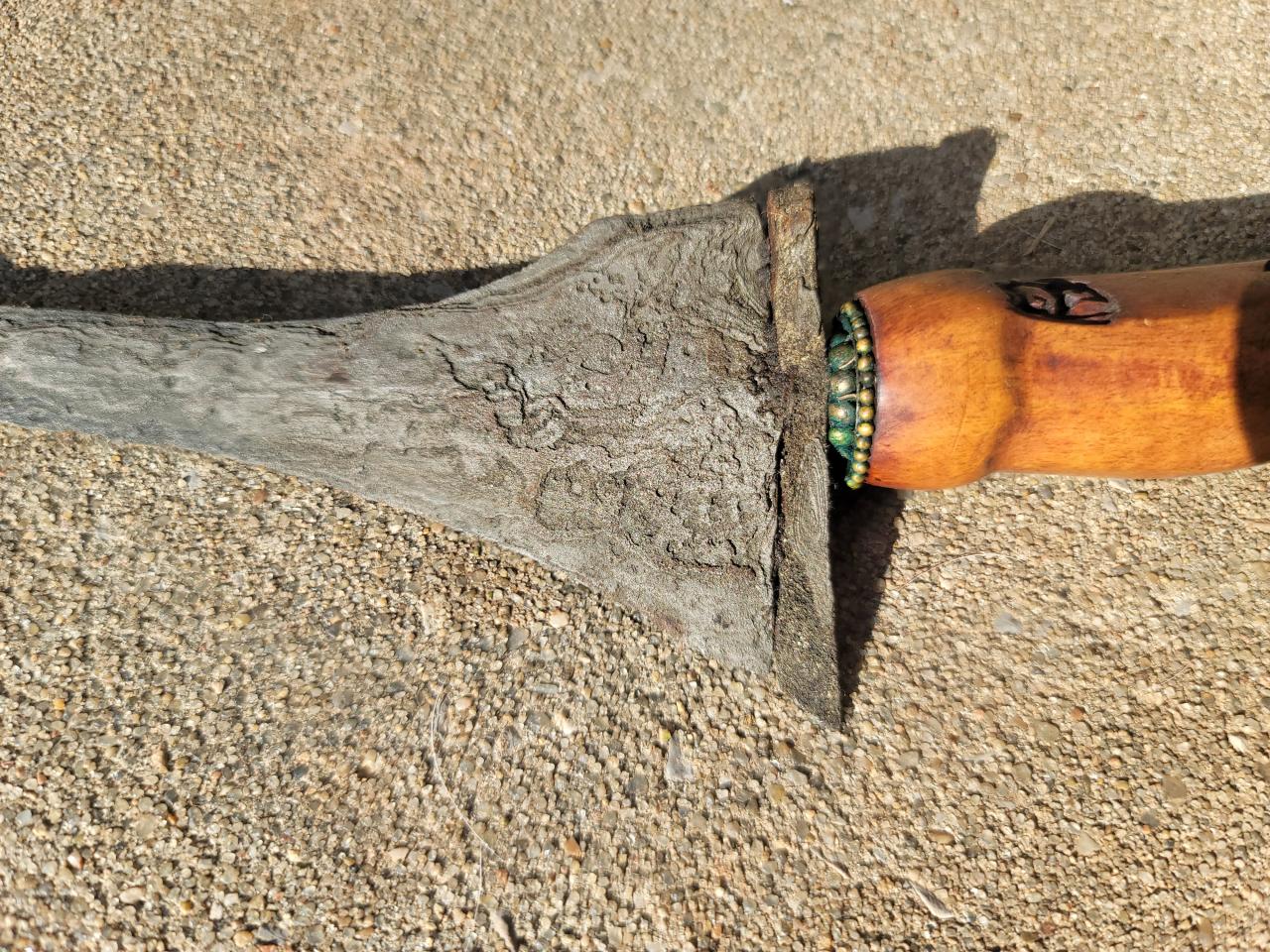

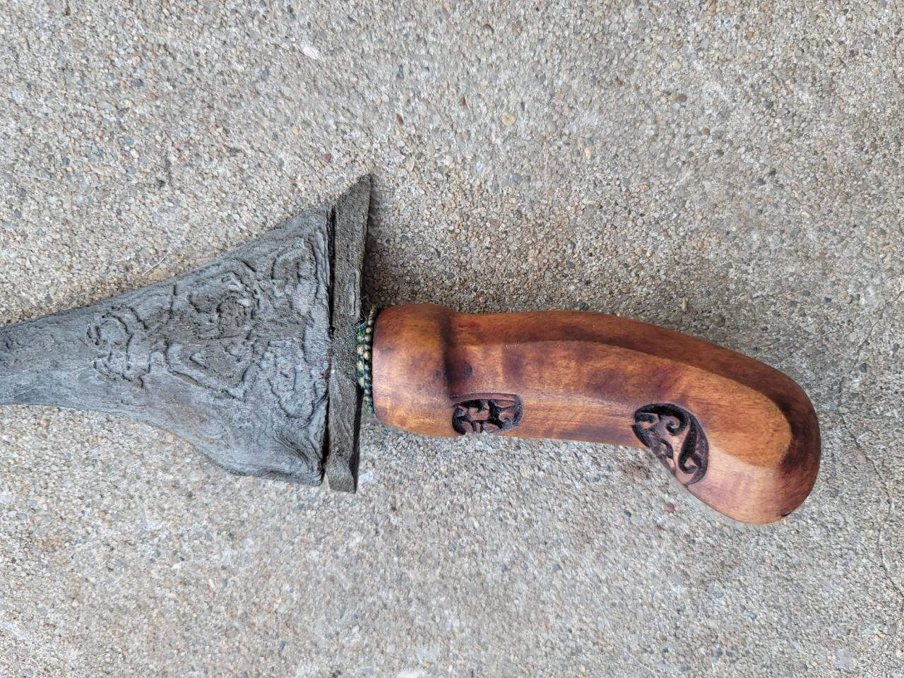

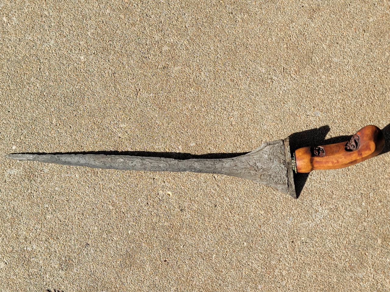

I have spent the last few months trying to study the keris. I feel that I have made some decent progress but this one has stumped me. It looks very old to me. The mendak looks aged as well. The ganja may have been gold plated at one point. I know there is ways to make it look older then it is. The main thing is the pamor has got me stumped. There is a character in the design. I didnt even notice till I started taking pictures. I have not been able to find another example like it. It reminds me of Bambang Sumantri. I am sure there is another design on the other side but I can not make it out. Is this an artificially aged piece or just a old keris that is a victim of a few to many citrus baths? Please any assistance with age and region would be appreciated. Thanks
ASPaulding is offline   Reply With Quote
Old 17th October 2023, 03:49 AM   #2
Posts: 7,264
The wayang figure that we can see has been put onto the blade by what we call the "batik" process. Batik cloth is dyed by covering with wax those parts of the cloth that we do not want the dye to touch. This figure has been created in the same way, it was drawn onto the blade with wax, then the blade was soaked in acid which left the figure in relief.
Regrettably whoever did this was a bit of a novice, or maybe just plain lazy or stupid or forgetful, and the entire blade was soaked in acid for far too long. This has resulted in what we can see, which is a blade that has been damaged so badly that it is probably beyond resurrection.
What I can see of the pamor motif looks like a random pattern, wos wutah. It is an old blade, probably Tuban-Pajajaran. To my eye, the gonjo has never had any kinatah work or plating.
The wrongko is Madurese ladrangan, it needs a pendok, the hilt is Javanese, it tends towards Jogja rather than Solo, but I cannot get a clear impression from the photos, the mendak is damaged and missing its lower rings.
I'm sorry I was not able to be a bit more upbeat, the clown who ruined this keris should have had his own hands put into the acid that destroyed the blade.
The heavy etch process to create images in blades was very popular in late colonial times & for a very brief period after WWII.
It's OK. At least I have learned something new. I have never heard of batik process. I thought maybe something has happened to the blade to make it looks like this. Thank you for the information.

I few more photos.
