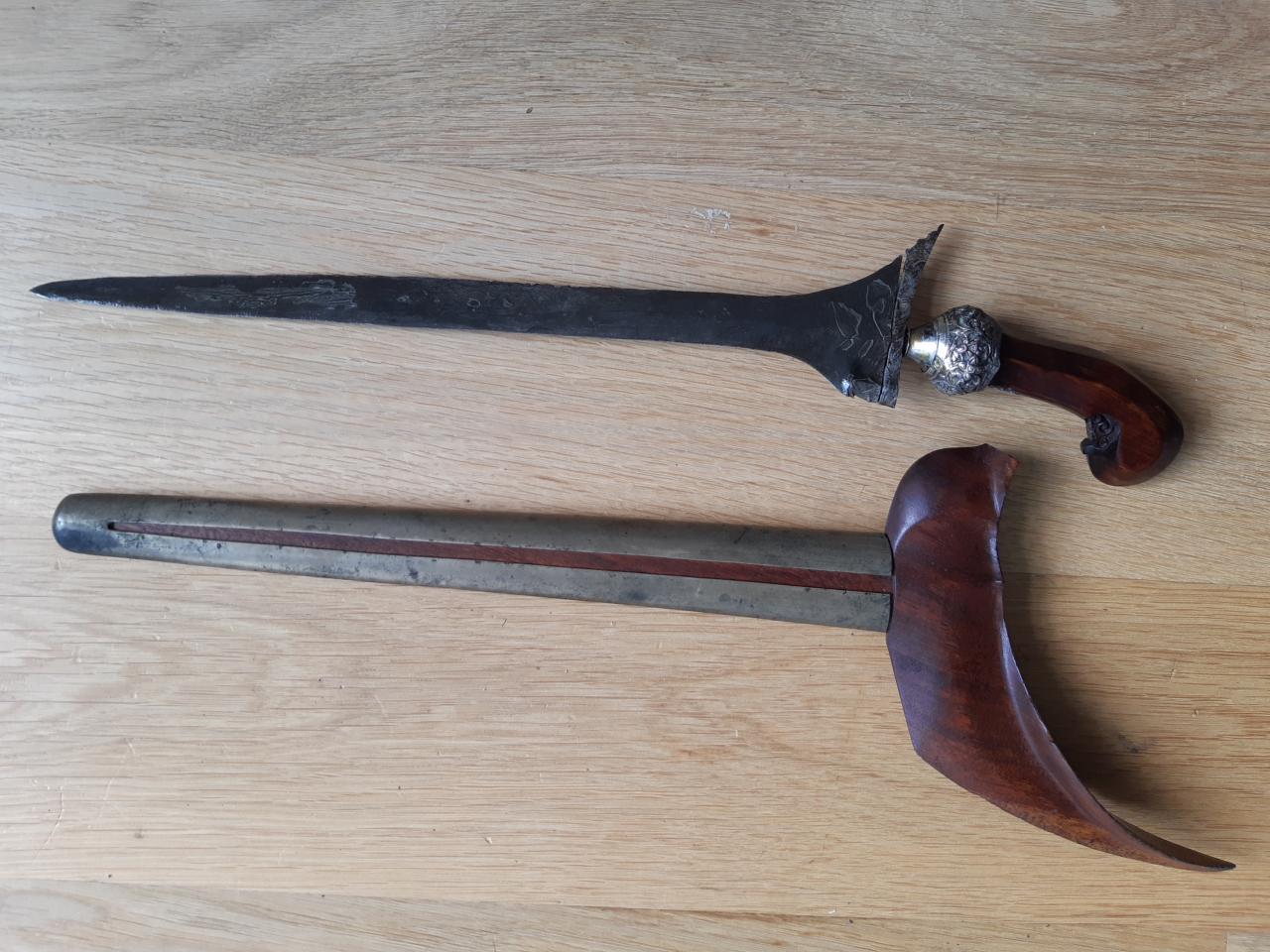

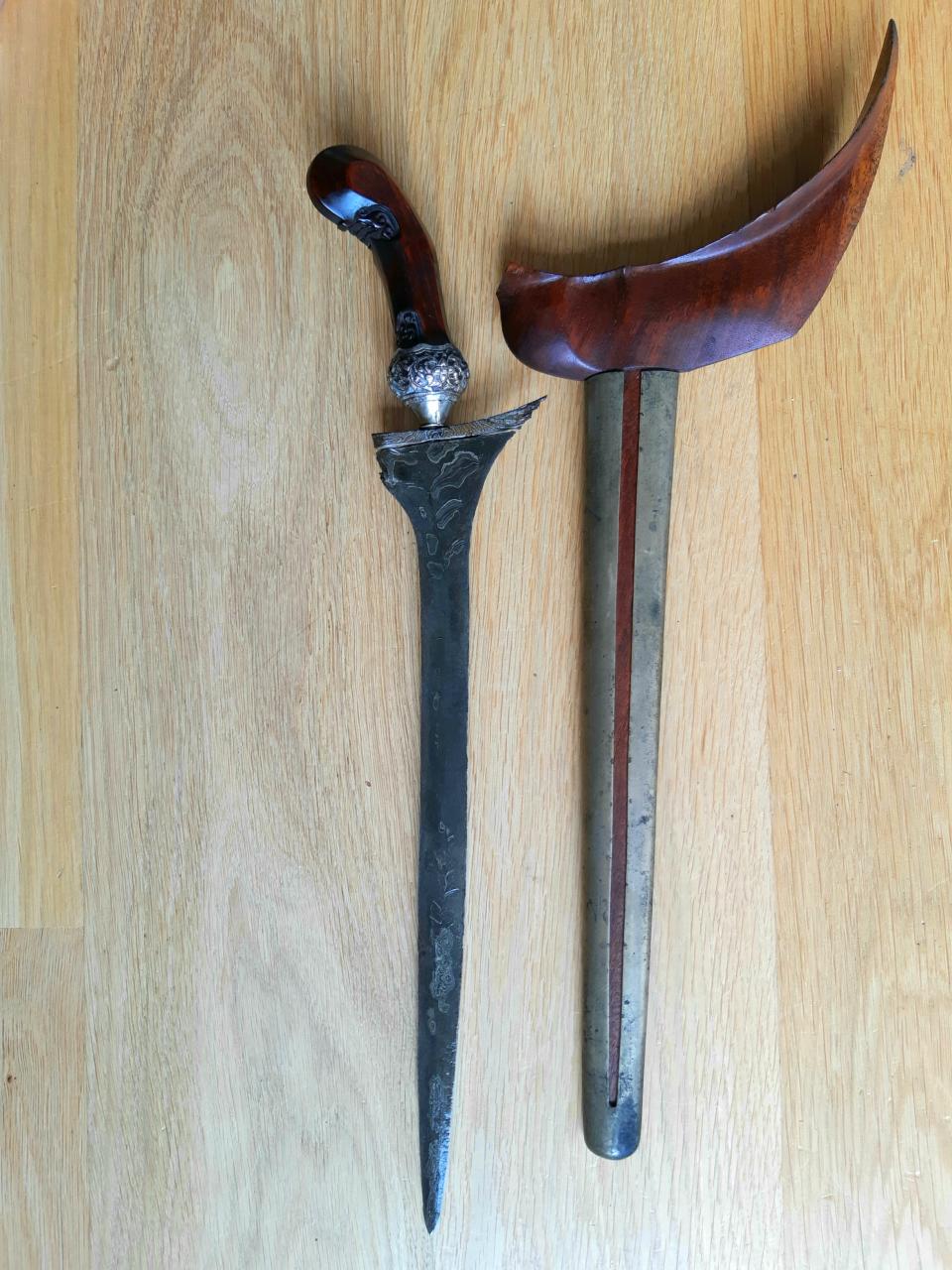

Dear brethren
Any thoughts on this keris including its pamor, age and quality please? I was told it may be toyo mambeg.
Thanks

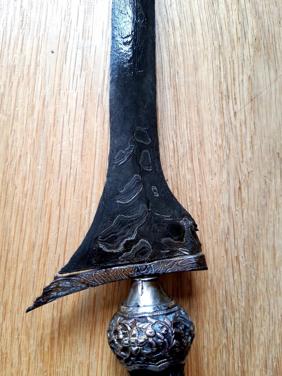

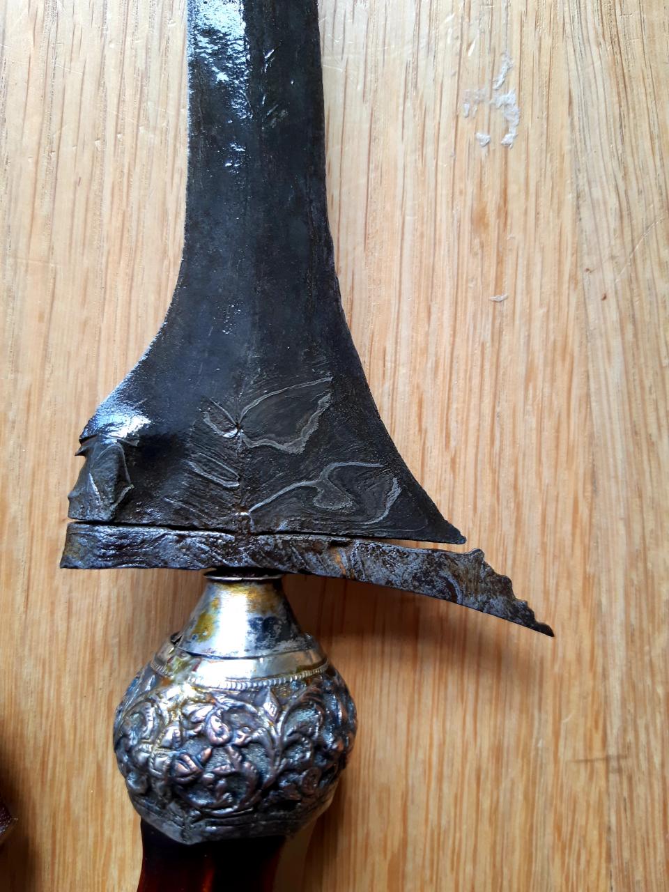

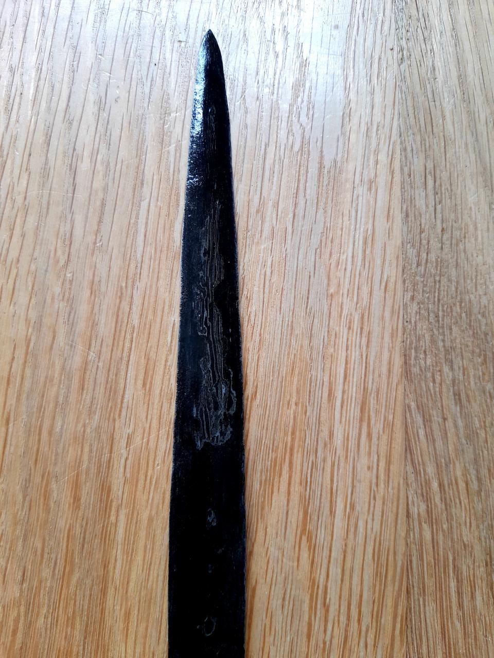

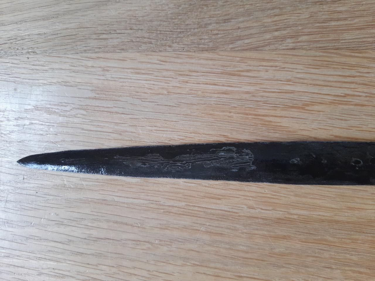

Sid, I'm sorry, but I cannot read this pamor, it is too heavily eroded, it was a pamor miring, but it no longer exists.

My personal opinion in this matter is that all keris, no matter of what quality or of what perceived background, should be treated appropriately, by "appropriately" I mean that the keris should be treated in a way that is appropriate for that particular keris. As an example, the keris that you have posted a photo of would benefit greatly by recarving the the damaged ladrangan wrongko into a Kacir form, and either attempting to reset the pendok or replacing it. In short, just tidy it up a bit.
