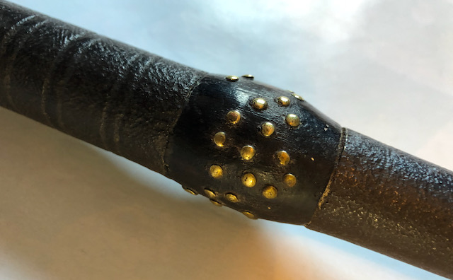

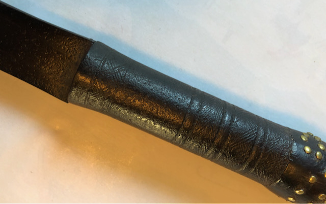

This dha is not in great condition, but it has been stabilised, leaving a blackened blade and (iron?) hilt. I think someone has polished the brass studs rather than them being a later addition. No pommel cap. Incised bands of decoration on the hilt. Sadly no scabbard. No idea of the age.
Achang maybe, or Kachin?
Dimensions
Length 66cm
Blade length 48.5cm
Blade width 2.8 > 3.1cm
Spine 0.7cm
Hilt length 17.5cm
PoB 10.6cm

Hi Jerseyman,
I have two dha with very similar iron hilts. On mine the non-iron area is ray skin and taken together with the iron segments, the hilts look like sections of bamboo with the ray skin areas as the nodes. As is yours, my blades are hua tat khong. Mine don't have any sheaths either and I don't know whether they are Kachin or Achang but I always assumed Kachin. I have no idea about age but I can find no seam in the iron so I suspect that they may have been made from iron pipe.

Hi jerseyman,
I also have a few of these iron-hilted forms, generally in two main sections for the hilt--two pieces of iron tubing over a wooden core. One has a straight blade and the others are curved. Some of these may be HuSa dha, but I think others may be northern Thai or even from neighboring Laos. The straight one had an open-faced scabbard and was sold to me as coming from the Lisu people, who are ethnically linked to the Kachin and live in northern Yunnan Province.
