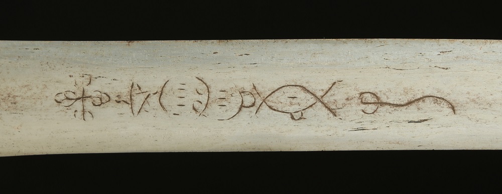

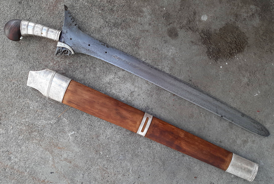

Hi friends,
Just sharing my first kris with talismatic inscriptions. Maranao? can the inscriptions be translated? regards

That's a lovely example. Thanks for sharing.

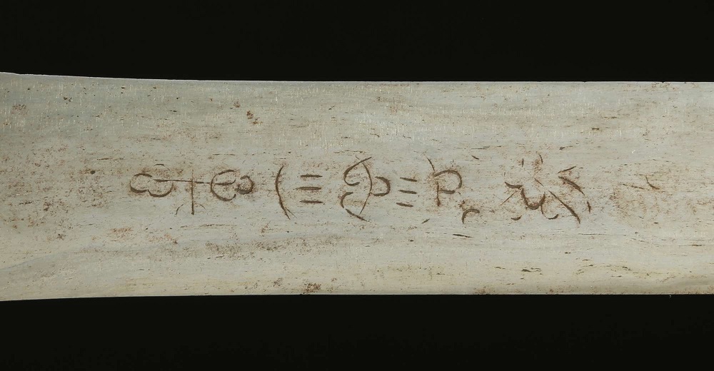

May general view on talismanic inscriptions is that no, they cannot really be truly translated. While we do see repetition of various magickal sigils on blades like this the final intention is always going to be both personal and secret. We can only ever assume what the original intentions were and frankly i don't really sure it is our right as collectors to "discover" the inner workings of such personal magick.

The blade looks Sulu/Tausug to me, although the hilt does look a little more Maguindanao.
Hi Sir,
1) yes, the hilt does look a little more of Maguindanao;
2) blade: sulu/tausug: what are the feature/s of a kris blade that points it to the probability that it is of tausug origin? or maguindanaoan or maranao? very interested to know.

Some time spent with the Search engine here may help with your questions regarding identifying tribal origins.
Search terms like Sulu Kris, Tausug Kris, Maranao Kris etc.

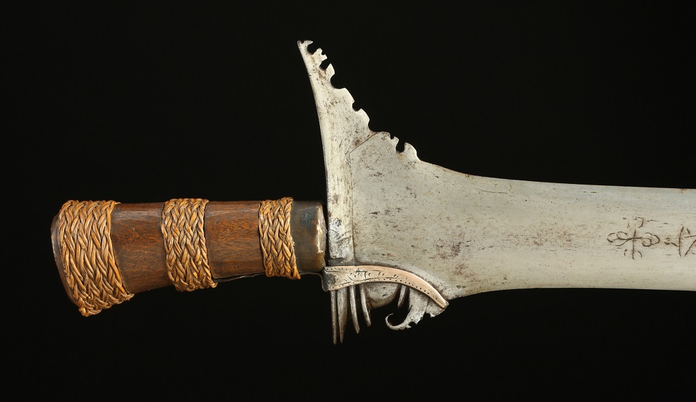

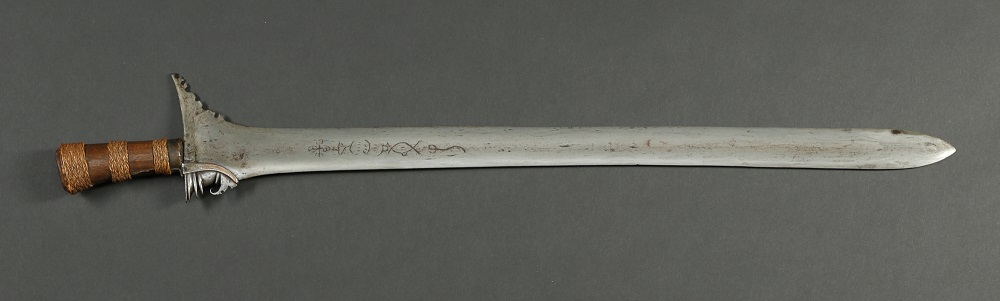

I agree with your Maranao attribution based on Cato's identification of kris by tribal groups. As I'm sure you know, Cato identified distinct differences among Sulu (Tausug) and Mindanao (Maguindanao and Maranao) kris. I have attached a picture of his illustrative examples below, showing the elephant trunk area of Sulu (Tausug) kris [A], Maranao kris [B], and Maguindanao kris [C, D]. It's fairly clear that your example most closely resembles the Maranao form shown by Cato. The blade of yours is also straight and wide, wider than most Sulu kris but consistent with Mindanao kris of the late 19th-20th C.
The talismanic/magical inscriptions on the blade are a wonderful find, and I agree with David that we will likely never know what these meant to the owner of the sword. They do indicate, however, that this was a "special" sword imbued with powers such as providing a safe and successful outcome for the wielder of it. Who knows what spirits, good or evil, may lie within this blade.

It is not unheard of to sell a blade from one tribe to someone of another tribe who places their own tribal hilt on it, and thus the mixing of styles on some Moro pieces, or even Bisayan and Moro pieces.

First of all, my utmost appreciation for the information (and the pictures). A couple of questions (I hope you won't mind):

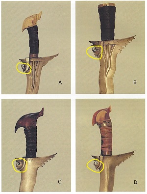

1) "elephant trunk area"-is this the area (encircled in yellow)?
2) blade: "straight and wide, wider than most Sulu kris but consistent with the Mindanao kris of the late 19th-20th century"- question: wider by approximately how many centimeters than most Sulu kris?

Yes that is usually the best way to distinguish the tribal differences. The back of the ganga (or opposite side of the yellow areas) is another way, as well as decoration/okir/ukkil motifs.

As far as Robert Cato's book, Moro Swords, is concerned, it was a limited single edition printing and has been out of print for several years. A controversial book, you will find varying opinions of it on these pages if you search for "Cato." Another book has been promised for several years, written by Philipinos, but has yet to be published. Part of the problem seems to be the secrecy of information coming from Moro sources who insist on the utmost confidentiality. As a result, Cato remains the most authoritative published work on Moro swords, despite a number of areas where he is likely incorrect.
Old 1st June 2020, 02:09 AM   #12
Posts: 4,749
On the subject of kris dimensions, it is clear that archaic kris (pre-19th C) were slimmer and shorter than subsequent kris. In the 19th C, kris appear to have become longer and wider than their ancestors, and this trend was exaggerated in the late 19th C among the Maranao and Maguindanao. Tausug kris also increased in size during the 19th C, but not to the extent of the Mindanao kris in the lat 19th C, although some Tausug kris of the 20th C may have got closer. It's not easy to give precise dimensions because of the changes that developed over time. Some of the Mindanao kris can be about 1.75 inches in width at the first luk, and the gangya are also wider and thicker than earlier examples or Tausug kris in general.
The best way to appreciate the differences between kris from the various tribal groups is to lay examples side-by-side from each group that were made in the same era. From memory, I think Cato's book shows some pictures where he has done that. Certainly he talks about the greater size of Mindanao kris in the late 19th C.

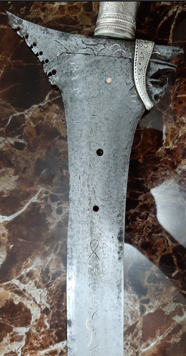

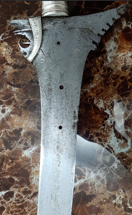

Here's my 'kris with talisman.' A Maguindanao one, with 3 holes and inscriptions. The silver inlay is fading, unfortunately. I'm curious if anyone knows the significance of the 3 holes.
The fittings (scabbard, hilt, asang-asang) look much younger than the blade.
Old 19th July 2020, 07:46 PM   #15
Posts: 7,422
Xasterix, interesting Maguindanao kris. I like the modern silver mounts on the hilt and scabbard.
Were there silver dot inlays in the blade or a silver okir panel there?

Thanks! I'm attaching closer pics of the gangya. There are still faint engravings where silver used to be. On one side, one of the holes still has silver filling.

Well Bob, the word "occult" literally means "hidden". And the very first definition of the word in Webster's dictionary is : not revealed : SECRET.
While i certain accept the word occult as applicable here i believe "secret" also fits the cognitive bill just fine. One could just as equally argue that these symbols aren't "hidden" either as they are in plain view.
As for those who knowledge encompasses such things, we will never know. Magickal talismans are often quite personal in design. Yes, they may use some more generally understood magickal symbols, but the entire "spell" for lack of a better work, may very well only be completely understood by the person who created it. The power of such things can be greatly diminished if they are understood by anyone other than the one creating the action.
Though we can guess that in general it was probably put in place to protect the warrior from harm and give him to power to overcome his enemies. However, the actual specifics of these markings probably can't be fully understood by any living person.

I got this from a collection that was mostly made up of Maranao and Maguindanao kris. The curious thing was, all the Maguindanao kris (except for one) were rehilted and rescabbbarded in the Tugaya style. The Maranao kris were as-is (not flamboyant, I'm guessing original fittings).
There's a certain flavor that Tugaya maintains, a sort of flamboyance. I guess I can hypothesize that for a certain time era, the Maranao people resurrected old Maguindanao blades and gave them a more...catchy dress, which would fetch more $$$ as well when sold.

I see your point. It did have a silver okir chased panel on both sides, with more silver inlay originally.
What you said explains the Maranao looking okir work on a Maguindanao hilt and scabbard. Hmmm.............

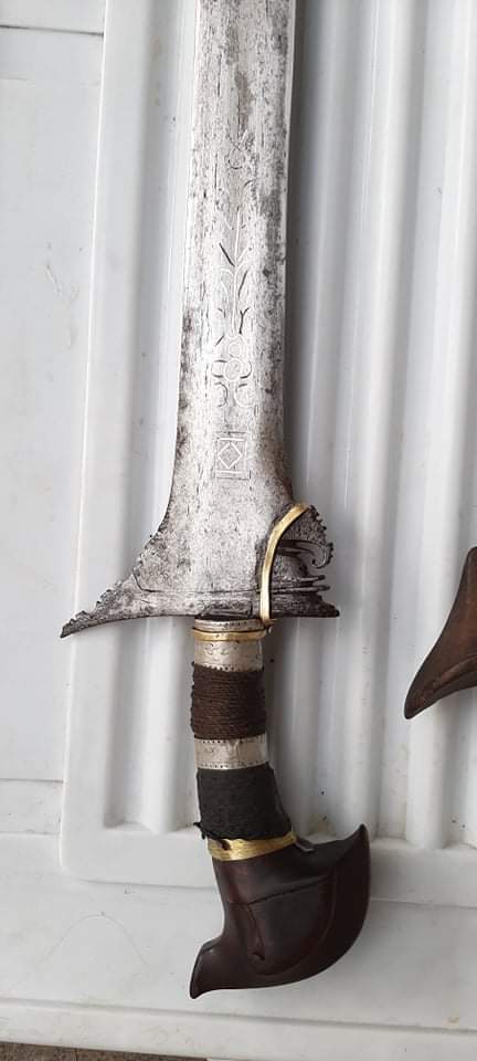

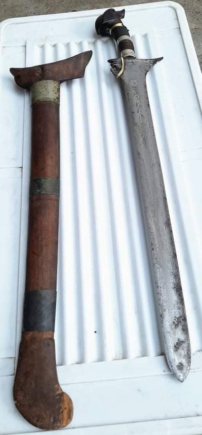

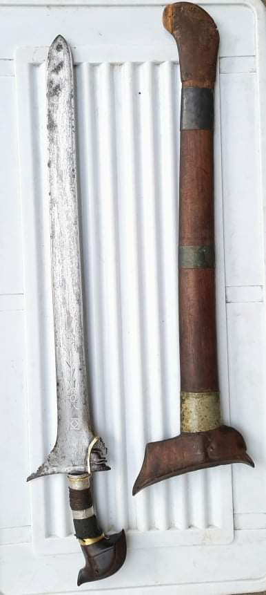

I got another 'kris with talisman'
I've only partially restored it. The gold wire asang asang and threads near the pommel are my handiwork.

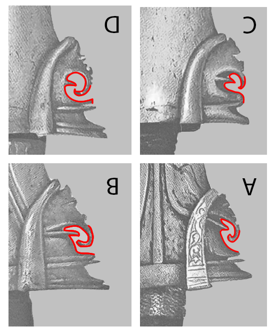

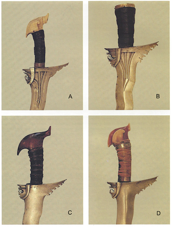

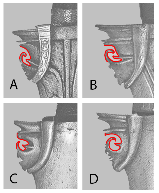

Since this post discusses Cato's classification, I thought I would post this here. For some reason I find that section of his book extremely confusing to parse through. I've posted it below with what I believe is the relevant text from the page to go with the figure examples. I've also highlighted the area in question to see it better, using Ian's letter notation.
A. Sulu kris with bone pommel.
Generally, Sulu kris blades have mouth cavities which are elliptical in shape. The older forms feature mouths which are less open and more angular than the later versions. In either case the mouth cavity and the lower jaw point down towards toward the base of the guard. The trunk itself may be normal in length or elongated.
B. Maranao fighting kris.
The type that is distinctly Maranao begin with an elongated trunk. The mouth cavity while still present, is quite narrow. and the lower jaw run parallel to the guard.
C. Maguindanao kris with banati kakatua.
The Maguindanao style, like the Sulu, exhibits an elliptical elephant's mouth that is still somewhat pointed on the innermost end. However, the Maguindanao variety is not angled downwards. Instead, the design itself runs perpendicular to the side of the guard.
D. Kris with pommel of sea-cow ivory and Mindanao "crossover" elephant-trunk design.
Some Mindanao krises have a very similar style, except that the mouth is round instead of oval, and is not angled. This "crossover" form seems to be evident on both Maranao and Maguindanao krises.

Posts: 7,303
I don't know how other feel about this, but it make far more sense to me to look at a diagram like this the other way around.
Old 5th September 2023, 04:26 AM   #25
JeffS
JeffS's Avatar
Join Date: Sep 2005
Location: Singapore
Posts: 467
Wow, for sure. I can update the graphic (assuming it is helpful for others).
