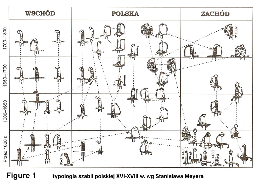

A (very brief) look on the Class II history
As I continued to write I have seen a big informational gap when it comes to the time period in which Class II has been used, what it looked like in specific times, what the main purpose was (decoration/parade sword or for battle) and what materials were used.
I will address this problem here briefly to give a glimpse at my way to put things into some order.
Poland:
Today's Poland has a little in common when compared to its historical geography and ethnic mix. When talking about Poland in the sense for our study about Class II sabers, I mostly mean the Polish-Lithuanian Commonwealth (PLC) which existed from 1569 until 1795. This time period marks also the peak of use for this kind of weapon in history and all places it was actually used. PLC was home not only to the Polish and Lithuanian people, but also Armenians, Ukrainians, Tatars, Huns, Germans, Czech, Jews (I´m of course aware of the fact that Jewish culture is defined by its religion but nevertheless it's a very distinguishable culture) and many more. This comes into play since the troops of the PLC were composed of those different ethnic groups also. One PLC nobleman could have had a Class IIa saber with certain decoration on it which resembled his, f.e., extreme Catholic belief and without a feather, because he may not have used backhand cuts. Another PLC nobleman with his IIa saber could have been more on a political trip and therefore ordering a swordmaker to put his king's image in gold on the blade and wanting a very long feather since backhand cuts were his favourite way of fencing. Just keep that in mind that every antique weapon belonged to a real person as you, with different tastes and things that were important to them. It was a very personal item and made to assist in surviving an often very rough environment.
The earliest Class II-like sabers are said to be from the late 16th century and are supposed to come from the near east. One theory is claiming those swords evolved from an early Byzantine short curved sword with a stylized birds-head grip. This can be true or may be false, it doesn't matter for our purposes.

We see that the time period in which Karabelas started to get more and more decorative and for parade purposes is the mid-18th century. Those weapons had more complicated hilt designs (often accompanying a weaker construction and therefore vulnerable and risky to use in actual battle). We can assume that simple looking versions with attributes of a durable weapon are from the time period before, mostly between roughly 1650-1750. I will get into later and parade versions a different part.
Stanislaw Meyer helps us a lot.
[Figure 1]
There is an english version of that but I sadly don't have it. Wschód means "East" and Zachód means "West". Polska means of course Polish. The West was naturally everything westwards of Poland on continental Europe and "East" is meant to be the area from Hungary to modern day Turkey. Keep in mind that the "East" and the "West" were influenced by other cultures too, so you will find f.e. Persian influences on Ottoman culture bringing it further to Hungary and later Poland. Just for short: The Class I saber (I don't like calling it the "Winged Hussars Saber" (really don't like it for historical reasons, but you should know which type I mean) is such a marriage of East and West. The Polish knights used swords like everyone else in Europe at that time (f.e. Longswords) but after a time they adopted sabers which came from the East with different ethnicities like the Huns and Tatars to name just two. What the Poles did was to produce sabers with hilt-designs coming from the West, like a thumb-ring. This is just an example. It went further by the West replacing f.e. rapiers by sabers to their regular troops later than Poland and Hungary as we see in the 18th century.
But what is this kind of knowledge good for? Its good for knowing differences of weapon-purpose and therefore materials which limit this use. You simply will not find an original example of a battle Class II saber decorated with gems and its grip made of ivory. Battle weapons were made of strong materials in a very durable construction (f.e. see the hilt-design chapter in Part 1).

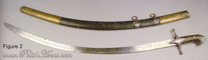

With that knowledge we can now take a first try on our first example!
The first saber we take a look at is a classical Class II saber similar to the ones one can find in the Museum of the Polish army in Warsaw. The source is polisharms.com. There is much to talk about a weapon like this as you will find examining this weapon along with me. As for the image quality I have chosen this picture consciously since a lot of antiques posted in the internet and on auctions sites too is in this (for a person looking for details) fairly poor quality. I won't get into scabbard analysis for now. Firstly we will examine this object straight by Mr.Z´s classification, then we will try to broaden our opinion outside of it.
But lets see what information we can extract from it.
As you are looking at the image, try to use the information given in Part 1 to make an educated guess where this weapon could have come from and how old it might be!
[Figure 2]
Now, what can be found? We start by the simplest things. Lets just name the materials we can determine.
1. Handle:
-Shell:Very likely dark wood. (Could be oak or ebony alongside few others)
-Rivets: Likely brass with what it seems something unclear inside them
-Spine: Looks like brass too.
2. Guard: Steel (guess: unlikely casted, probably forged)
3. Blade: Simple Steel (But the image doesn't allow for a closer look if there is something like wootz/damascene)
Conclusion:
After this first glance we could say with a good conscience that this is a weapon made for battle use, because we see no gems or gold or any other laborious decoration. To strengthen this theory lets go on.

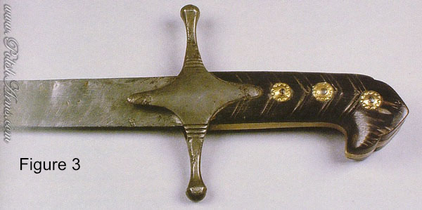

The Grip with its pommel
[Figure 3]
Clearly this shape looks like an abstract eagle head from the side. Its beak seems to form an angle of 90° or less: Going by Mr.Z´s classification this saber is clearly of Polish origin. If you are stuck at this point and don't know why, take a look at part 1 of this guide.
The wood shells have szewrons and three brass rivets which are hollow.
[Experience input: A lot of hollow rivets were additionally riveted with steel or iron nails. These nails are absent in some antiques because of f.e. corrosion of iron or repeated remounting of the blade.]
Nothing else is found in the grip and everything seems to be just for securing the fencers grip on the weapon.
Conclusion:
Again, going after Mr.Z., this is a characteristic of polish Class II.
The Guard
Simple quillons with three lines on each side ended with angular spheroids. The beards are slim. Ones sense of proportion could tell its about 10-12 cm long. No further decoration, no inscriptions and no coat of arms.
Conclusion:
The guard here is just practical. For now, it doesn't allow for further investigation about the origin, but we can tell something about the age.
The blade
The whole shape of the blade is not a part of circle but begins with a straight section on the ricasso (the part of the blade just after the guard). It then moves on to form a consistent bow.
We find a feather at the blades later part and a prominent hammer on the edge of it marking the false edge. There are multiple fullers carved in, probably three. One of them ending by the hammer, two ending few centimeters from the tip.
It seems there are some makers marks and/or decorations on the ricasso but the picture quality does not allow for further investigation.
Conclusion:
The blade is typical for Class IIa after Mr.Z. The furrows and the hammer indicate that this blade architecture was made for durability in battle. The feather, which is a lot work to add on a blade, shows us somebody needed it (and was willing to pay more for that!) to use certain fencing techniques.
Main Conclusion
In short, our working-hypothesis for this weapon is:
"Karabela-type saber (of class IIa by Z. Zablocki) from the end of the 17th century of Polish-Lithuanian origin".
You might ask why I excluded the beginning of the 18th century? I would argue that sabers from that time very often had some kind of imagery on them since it was a time period of opulence and changeable politics. It was common for nobleman to demonstrate their affiliation to a certain party or belief by letting the swordmaker place corresponding decoration on the weapon. This is just an opinion matching with other characteristics of that specific weapon shown above and an overall "feeling" for this kind of swords. There are of course sabers with political/religious decoration before and later without!
You try now!

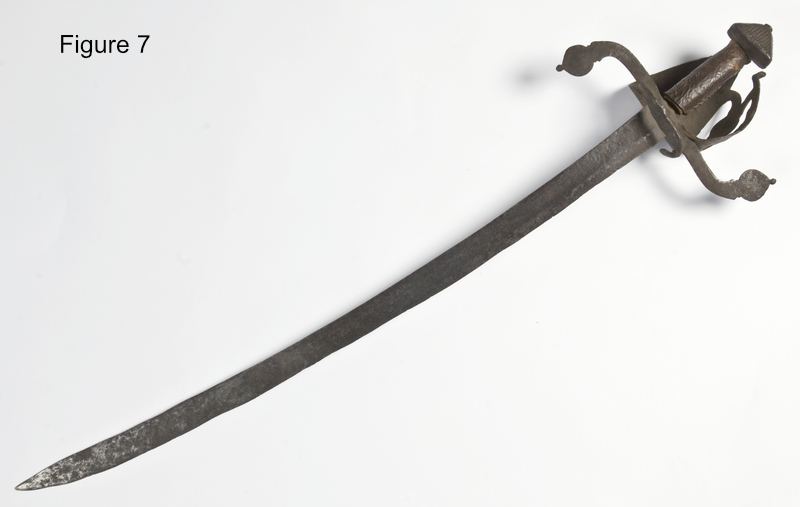

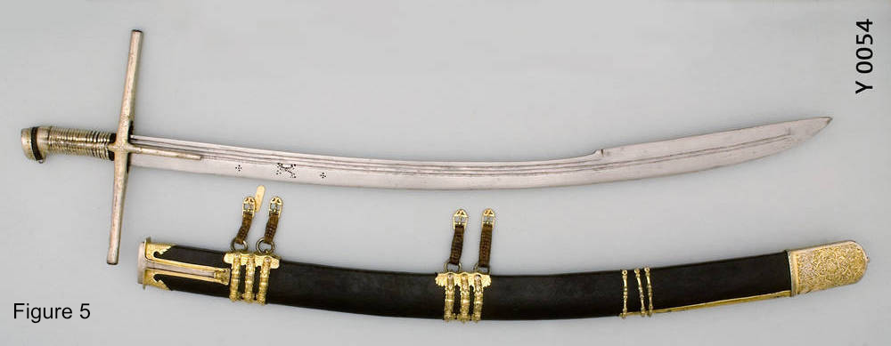

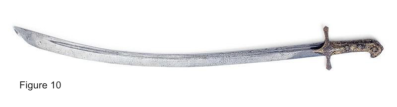

Throughout history many blades have been reused on newer hilts. A good blade was expensive and fencing techniques depend equally on the design of the blade as well as the hilt design. In particular, European saber blades had a quite consistent design which permitted a fencer to use a 17th century blade with an early 19th century hilt. No problem in that.
Below is a list of sword-types which I know regularly or sometimes had blades we can find on later made Karabela-hilts, the kontuszowa versions (parade) and also battle versions:

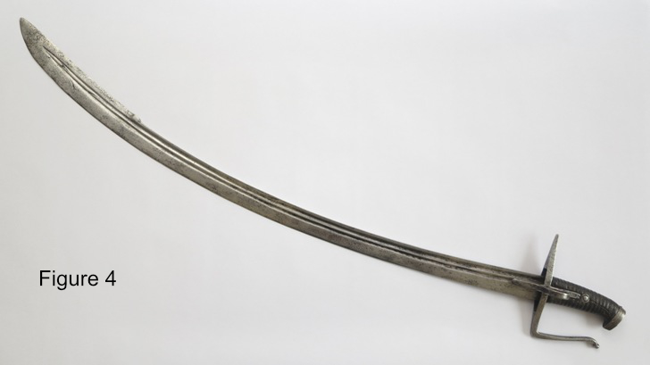

Figure 4. Hungarian saber, 17th century
Figure 5. Polish-Hungarian saber, 16th century (Rüstkammer, Dresden, Germany)

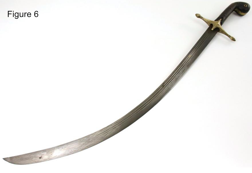

Figure 6. Ottoman saber, age unknown to me
Figure 7. German saber, 17th century (Wikipedia)

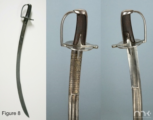

Figure 8. Polish saber Class I, around 1700(?) (National Museum in Cracow, Poland)

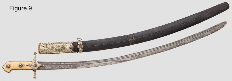

Figure 9. Example of a reused blade on a newer Karabela hilt - A Karabela kontuszowa with a 17th century blade (Gold inlay "IOANNES III REX POLONIARUM") with a mid- to late-18th century hilt (former Nuri Museum, Switzerland)
Figure 10. Another reused blade (Spocki Dom Aukcyjny, Poland)
