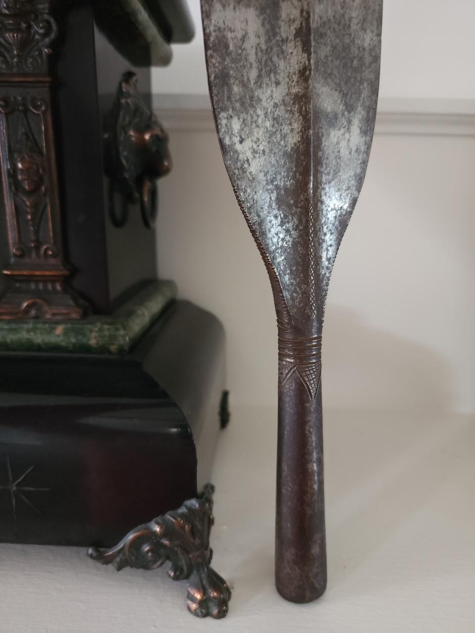

While we have often discussed Sudanese swords (kaskara) there has not been that much discussion on the spears, which seem to have been of various tribal forms. These forms were not all indiginous to Sudan necessarily, but from tribes in neighboring countries as well.

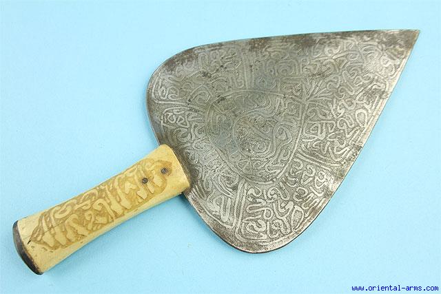

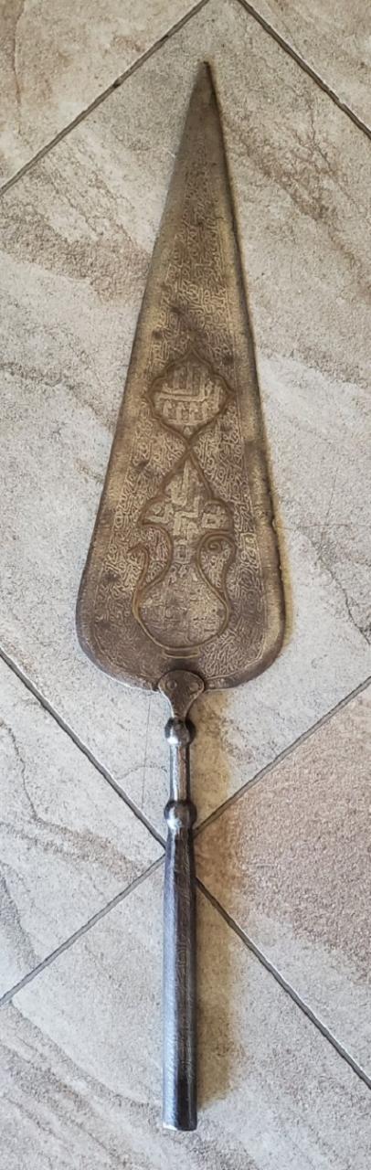

The script covered example I have here is I believe an 'alem' and while it seems to correspond to the wide leaf blade type ', I think it was likely used as a battle standard. This is suggested by Artzi in the blue backed illustration of one of similar wide blade form (apparently remounted with ivory handle).
In the fall of Khartoum (1885) British General Gordon was killed by a zealous tribesman who is this artwork appears to have one of the wide blade spears.
I would appreciate comments and especially examples of spears out there of Sudanese association and of this period.

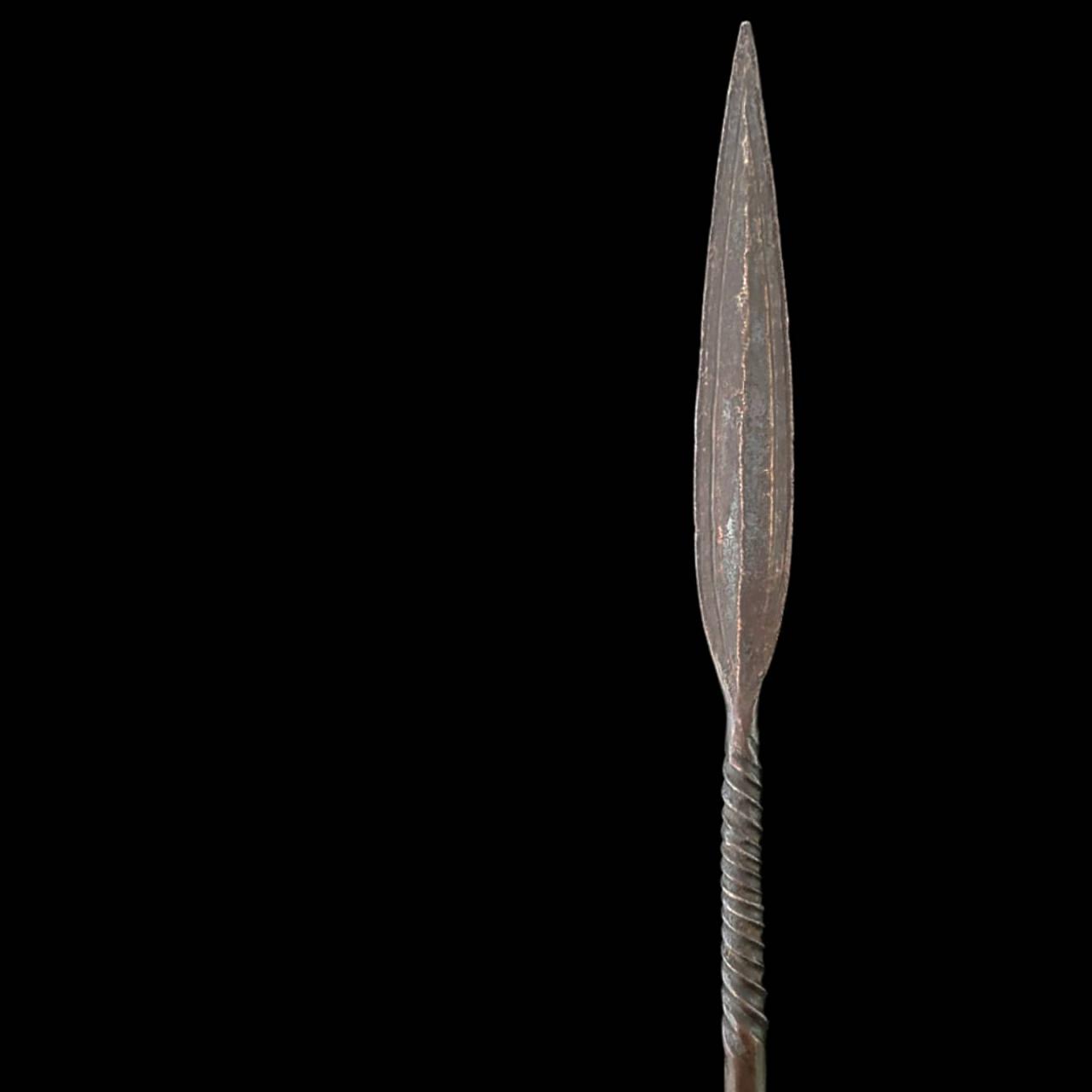

Northern Beja, mostly Beni Amir continued to use spars while southern groups transitioned to the kaskara. See the attached pic of Beja spear maker from Kassala via my Sword & Knife Makers paper and the extracted text.
The short spear is still made by O'Haj Mohammad Din, my informant's uncle. He and his
son are the only remaining producers of the traditional weapon of the Beja. While the
sword has replaced it as the culturally reinforced large weapon of choice, the spear is
still preferred by the tough, steely-eyed Beni Amir who roam the hilly wastes of northern
Eritrea to the east of Kassala.
Unlike the long shaft broad leaf or spade shaped spear of the mounted Baggara of
Western Sudan, the Beja spear is designed for use by pedestrians. The wooden shafts
are about a meter long and steel spear points are attached to each end. The narrow
killing blade is about 20 inches, tapering from two inches to a sword tip. It has a center
reinforcing rib. The other end is an 18 inch long round piece formed by forging and
welding a rod in a pointed tapered spiral.
Informants say that the flat blade is used if one wants to kill an animal and the piercing
round end is used if only wounding is the goal. It appears to me that this weapon is
lethal at both ends. The length and balance of the spear makes it easy to carry, an aid
in walking and highly effective for thrusting, short range throwing and in defense of a
sword attack.

Thank you so much Ed, and for that link......2013...10 years ago, wow! Time really goes by! amazing how much info in that discussion, and your knowledge and field experience in these topics is profound.
As you note, the spears are seldom ever addressed in discussions on Sudanese topics, despite the fact of their importance among tribal warriors there.
These are great insights as to some of the key tribal preferences. It seems that so many times over the years many have somehow seen those barbed 'fishing' spears as deliberately horrible weapons for warfare. as you note, this is quite unlikely as the weapon cannot be pulled back.
I am wondering on my example, which seems to have a bit different shape but is indeed quite large, may be intended as a 'standard'...in the manner of the example shown with the ivory handle. The 'decorative' script overall seems, like thuluth, to be based on repetitive wording or phrases, but arranged in accord with the shape of the blade.

Apparently, every afternoon, certainly "frequently", the Khalifa held a big parade-like affair on a big field in Omdurman to whip up the faithful. Likely, your spear blade could have been used as a standard along with the flags, troops and drummers to keep the festivities going. It's a little small for battle, even for small units where the flags and mounted amirs provided directions. Yet religious figures could have hoisted it instead of a sword. Of course all of this is just a guess.

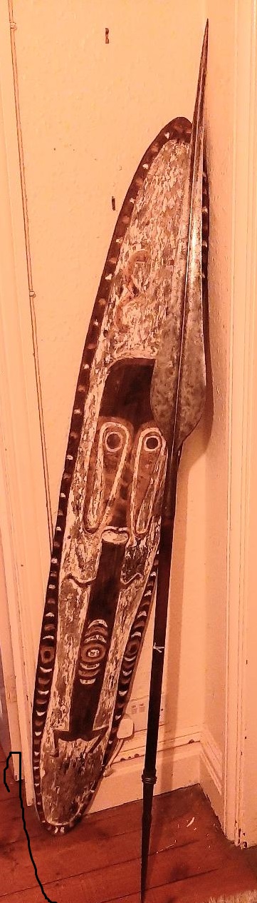

Not sure about being too small for battle. The blade alone is 30 inches long and the spine starts at 1/2 inch thick.

Tim,
My opinion is based thusly. If Jim's floor tiles are 12 X 12, the blade length is of that scale. The blade is riveted to the shaft, not very strong. Plus, the shaft is around a foot long, certainly too short and out of balance with the blade for two handed close combat. Better battle options were available.
Ed
