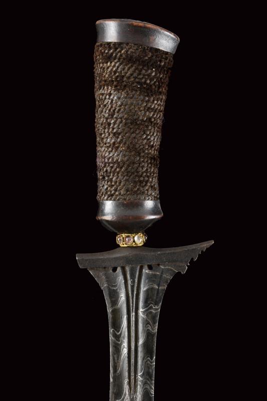

Hi
I managed to bid for this keris.
What is your review on this Bali keris sword?
I was told it is 19th century and only use for royalty.

Maybe it's just the lighting, but dhapur looks kind of different.

Is that a "death shroud" pamor?
Old 20th December 2022, 04:30 AM   #4
Posts: 6,429
I think that death shroud could be one interpretation of the pamor, there are others I think.
someone told me is Tambangan Badung pamor.

Buntel Mayit pamor is the term used in some places. It has an auspicious and also potentially the opposite vibe depending on if it's suitable for the custodian from what I understand. It's a lovely thing. What is the bilah length?

Actually Sid, it is Buntel Mayat, the "Buntel Mayit" name is a corruption.
In Javanese the word "buntel" is a wrapping, & "mayit" is a corpse. "Buntel Mayit" = "corpse wrapping" which sounds pretty hairy & scary, especially so for people who do not understand.
On the other hand, the word "mayat" means "to slope upwards", & "Buntel Mayat" = "wrapped in an upwards direction". In the understanding of those people who were the acknowledged elites of keris understanding & belief in Solo during the 1970's & 1980's this was a very positive pamor that enhanced the advancement of the bearer.
The "mayit" thing is just another persistent misunderstanding. Not at all unusual where the keris is concerned. But this is for Javanese keris.
In Bali this pamor is "Tambang(an) Badung". The word "tambang" means "rope", "Badung" is a regency in South Bali that covers most of the well known tourist areas --- Kuta, Legian, etc. So"Tambang Badung" = "Badung Rope".

Alan, i wonder what you thoughts are on the information Anthony received that this is a keris dhapur meant only for royalty. I guess i have a natural skepticism about such proclamations. And the choice of hilt seems unlikely for royalty.
Anthony, surely there were some other photos of this keris from the auction house. Are you able to post any. It looks like a nice keris. Congrats on achieving a long time desire.

I handled it a long time ago; from my memory, it seems to be a legit keris pedang (AKA keris ligan) with an unusual wavy tip (i.e. luk).
Age I'd hesitate trying to narrow down.

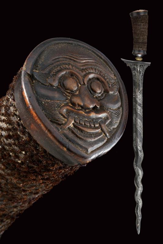

This keris was exhibited & published a while ago: Cp. the link given by me in post #31 of this thread:
http://www.vikingsword.com/vb/showthread.php?t=21646
Piece #17 on page 91 of the catalog is missing from the file online, unfortunately.
The catalog is also still available as book in both languages, I believe.

Mendak might be gold?

doesn't look so and the uwer stones look like glass.

Well, i would not be surprised to find glass "stones" fitted into a gold wewer. In Bali glass can often be found in high end ensembles. I have been told that the over all impression was more important than the intrinsic value of the stones. So finding glass set in a gold setting is not that unusual.
I agree that this keris probably would have been owned by a person of means though as the blade was not likely to have been inexpensive to commission.
I have read a couple of explanations of these tapukan style hilts. One idea was that they were favoured by soldiers due to the added grip the hair or fiber wrap provided. But i have never seen anything to support that theory beyond the logic that, yes, a wrap like this probably would provide a better grip.
The other is that this was a style of hilt favoured by the young. As were, apparently, kojongan style sheaths. And i have seen examples of keris dress that actually use both the kojongan with the tapukan hilt. So maybe that is the case.
But the reason i called out the "royal" tag on this keris is that this just doesn't appear to be the type of dress i would see on a keris owned by a member of the royal family. This tapukan hilt is a bit fancier than most, with that nice Kala carved on the pommel, but it still not what i would expect from royalty. So yes, "nobility" might be a better possibility. Or just somebody with the means to afford such a blade.
Did i see somewhere that there is a sheath that comes with this keris? I am curious to see what the entire ensemble looks like. I have a couple of keris with these tapukan hilts. One is rather plain in dress, but the other is in antique sunggingan dress and the tapukan hilt is painted with the same pigment so it seems to have been a part of the original dress. I am not sure if any particular social level in Bali were privy to sunggingan dress, but it is interesting that i have also seen a number of sunggingan dressed Bali keris with tapukan hilts as can be seen in this old thread.

I did a little searching online, and this is part of the original IFICAH catalog description. So yes, they identify the metal used in the wewer as "gold" and the stones as glass.
And they dated the keris as possibly being as old as late 18th century in the catalog.
They also mention the sarung (not shown for some reason either in their catalog for the show or in the auction catalog) as being sesrengatan. I am a bit surprised that a sesrengatan sheath would be matched with a tapukan hilt. Anyone have an opinion on that.
Mendak Gold set with dark stone or glass cabochons.
Scabbard: not shown, mouthpiece elaborate sesrengatan form (javan. ladrangan), reserved for the spiritual and secular upper classes (brahmana, khsatrya).
Blade 18th or early 19th century, mount 20th century.
Blade 47.3 cm

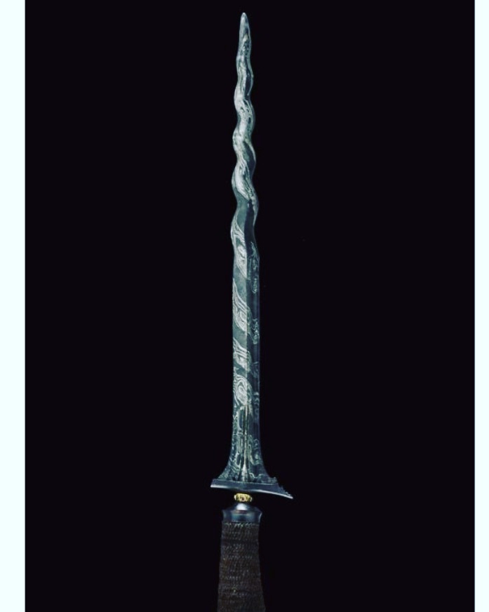

To count the true number of luk in the blade we begin the count directly above the wadidang and progress along the blade to complete the count on the same side as the wadidang. This method of count will produce a number that is 2 less than the Islamic count.
Thus, if we apply this method of count to Anthony's keris we have a luk count of 9.
A keris with 9 luk relates to Brahma and Wisnu, and thus to a member of the Brahmana, K'satriya and Wesia castes who occupies a high place in the social hierarchy.
If Anthony was told that this keris was one reserved for royalty then whoever told him that did in fact know that 11 is the number above which the luk in a legitimate Balinese keris cannot progress, but that person had reached the number of 11 by applying the illegitimate --- but popular --- Islamic count. When we apply the correct method of count that counts only true luk then we do come to a number (9) which is absolutely believable for a keris of this quality.
