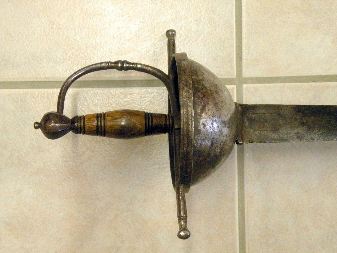

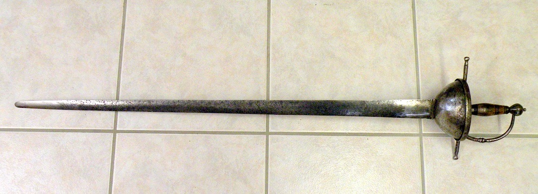

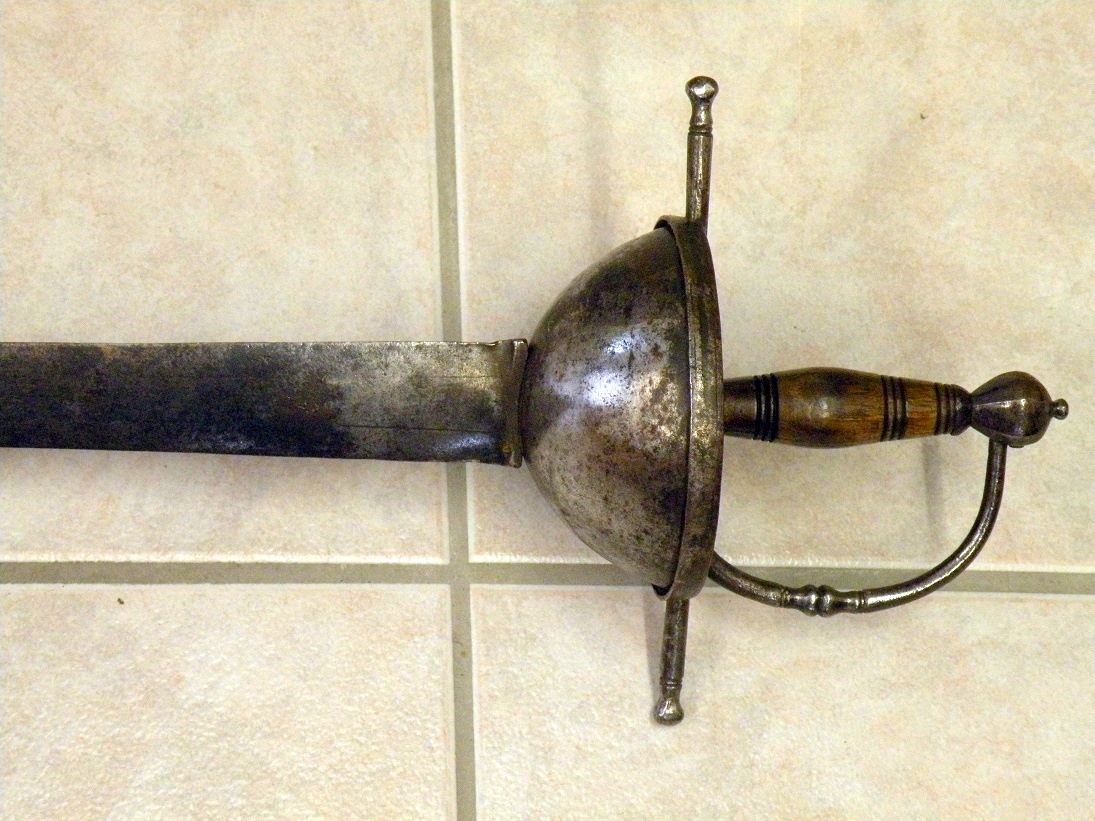

Dear All,

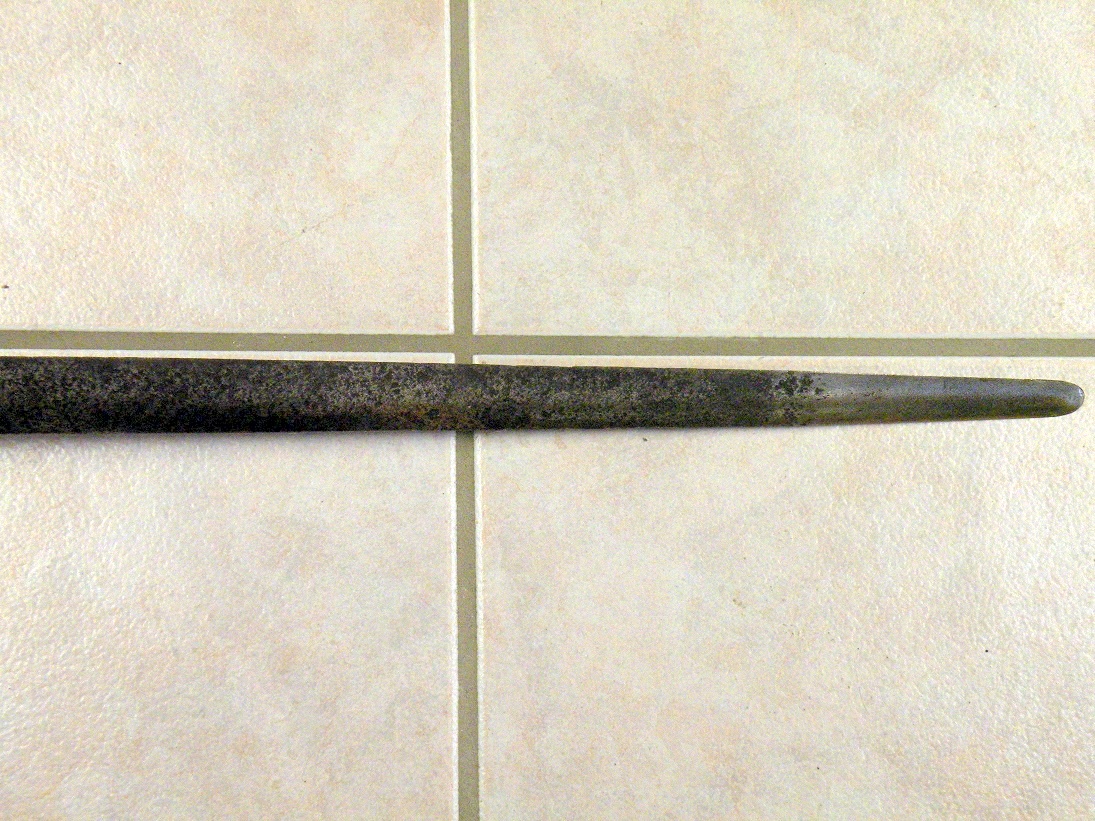

I just acquired this sword, which hopefully will arrive next week. Canīt wait to hold it in my hands Length is 100cm but the tip seems to be shortened.
I learned from Fernandos threads that this sort of cup hilted swords, where the parrier rod is welded to the cup, are mostly of portugese origin. While browsing this forum I found that thread:
http://www.vikingsword.com/vb/showthread.php?t=20948
The two swords shwon there are dated to the 17th century and do have the same sort of pommel with the screwed guard and the decorations on the guard and quillions. Could this also be a 17th century sword? Does anyone see discrepancies on that piece (I will hand in better pictures next week).
Looking forward to your comments.

Congratulations for your acquisition, Andreas. Yes, a good 'classic', with rompe puntas and all. Basically a military item, with the knuckle guard screwed to the pommel. You are right, the blade tip must have been shortened a few centimeters. Concerning age, this appears to be as (end) 17th. century as all others of this kind (mine included), meaning the usual age attribution may be a bit 'overestimated' by sellers, something that sounds good to buyers. So we may be skeptical and stretch the age to beg. 18th century, unless factual evidence shows otherwise.
But other members will have a better judgement.
