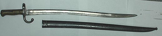

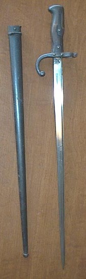

Here I would like to look further into the blades of these French weapons as they ended up in various edged weapons in Saharan contexts. In many cases these may have been bayonets from the Chassepot rifle (needle gun) 1866 (more of a yataghan style blade); the Gras bayonet of 1874 (a straight stiletto type blade) and a fullered blade from the Mannlicher-Berthier M1892.

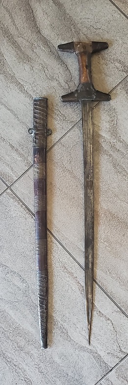

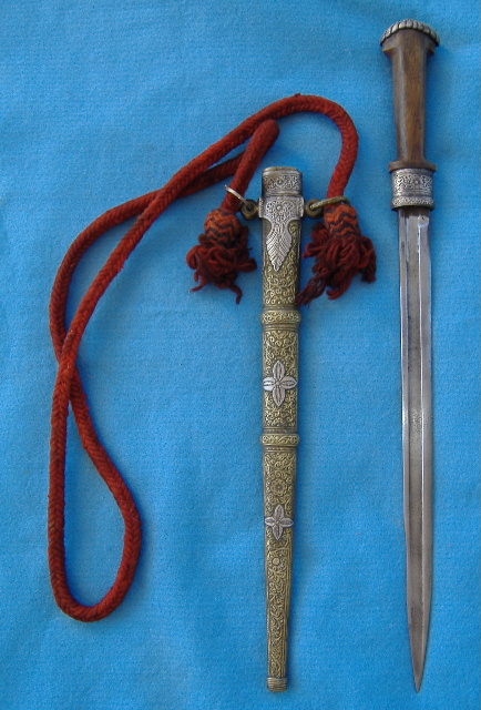

The dagger with red cord is a Moroccan genoui with what is believed to be a Mannlicher-Berthier 1892 (as seen to left next)
The next two are the yataghan blade Chassepot or the straight blade Gras

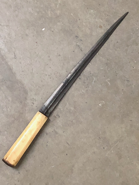

What I am thinking of is examples like this, which is a Moroccan s'boula which has a blade which may be a bayonet, but there are no markings. These blades were as far as known were not locally made. The tribesman standing by a doorway is wearing one of these (Buttin, 1933, #1033).

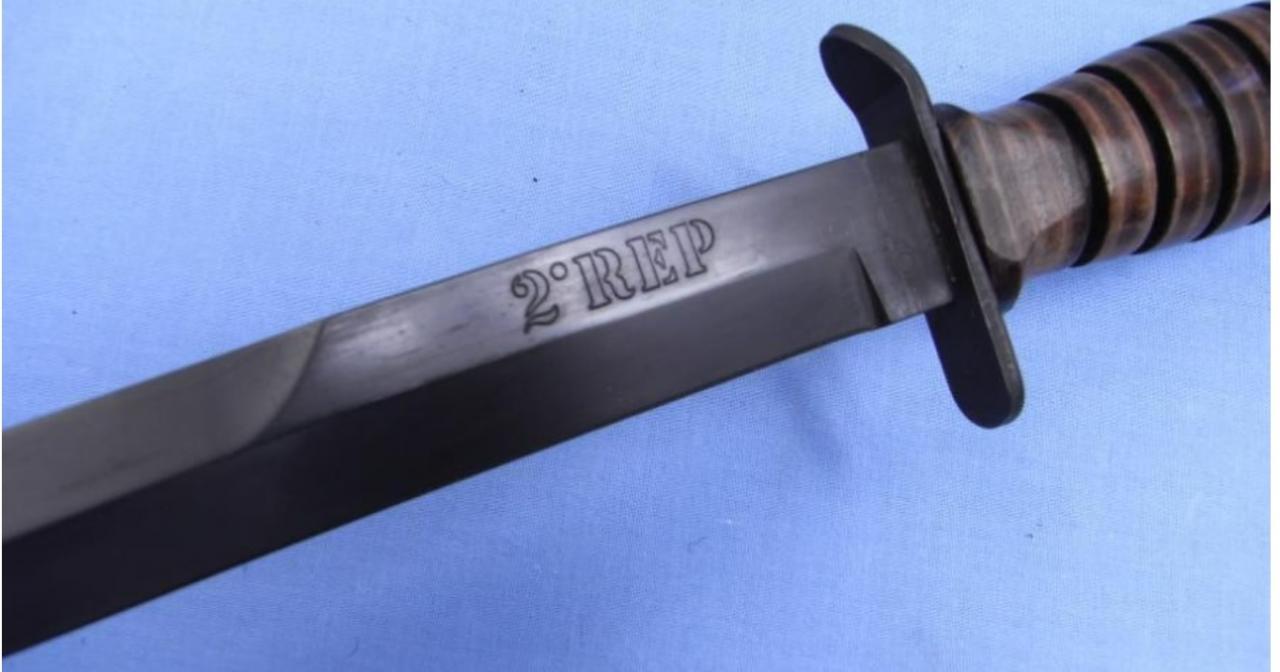

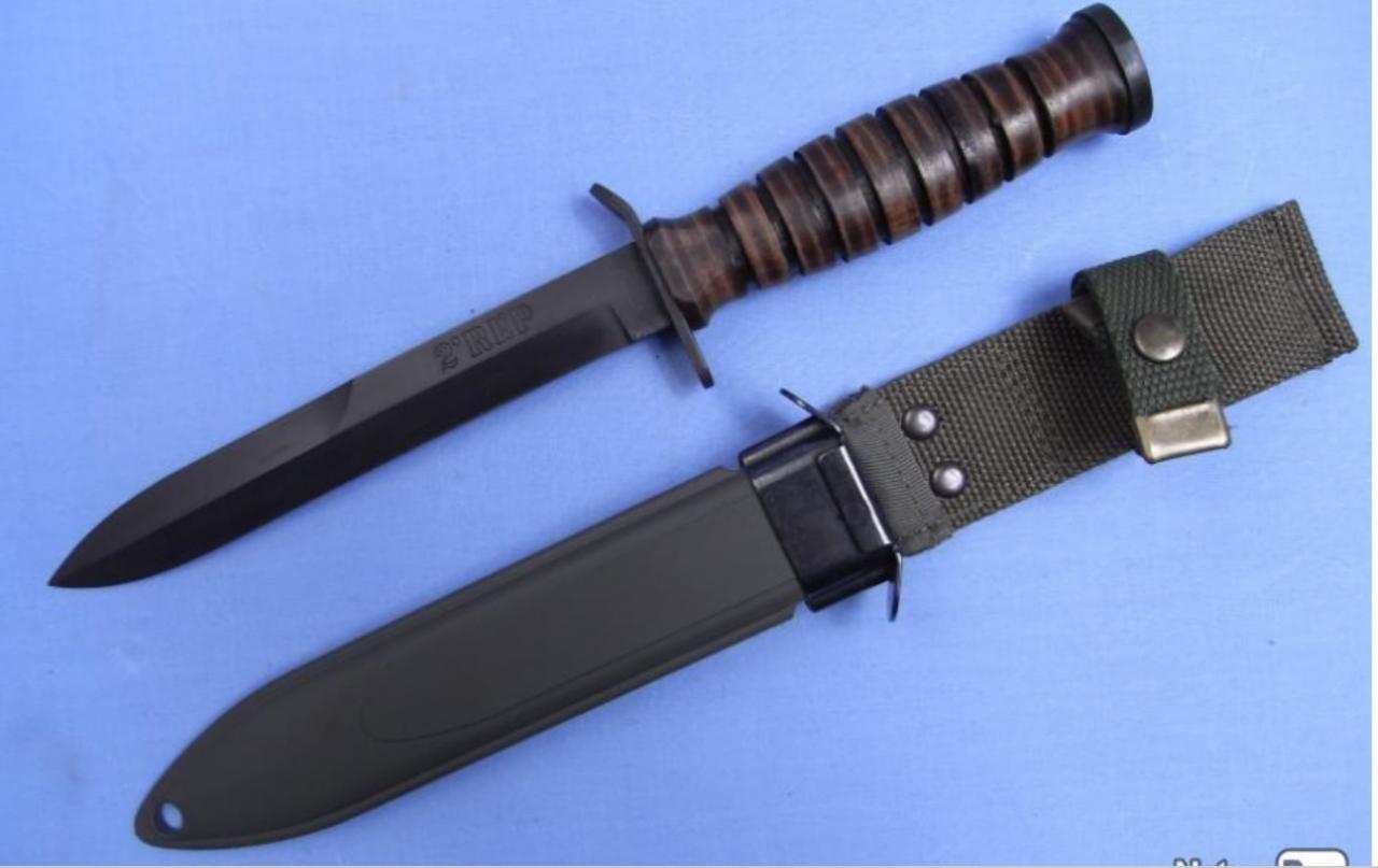

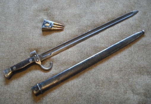

Evidence of marks on blades was just found out there, although in a late period, yet within the period of the Legion in Alger. A bayonet used by the 2nd Foreign Parachute _(2e Régiment Étranger de Parachutistes, 2e REP). The only airborne regiment of the French Foreign Legion.The regiment was constituted in Algeria in late 1955. There, the 2e REP would actively participate in the Algerian War (1954-62). In 1967, the regiment left Algeria as the last French airborne unit and was stationed on the island of Corsica.
Still leaving doubts if weapons distributed in an earlier period were also marked.

Excellent evidence that the convention of marking the Legion's weapons did indeed exist, as per this obviously far later example than the period we are considering. Thank you for continuing the search!!
It does seem that the presumption has typically been that the military would mark their weapons, especially as most arms for rank and file are issued. Therefore in order to establish ownership and regulate issuance and inventory, such numbered markings would be necessary.
